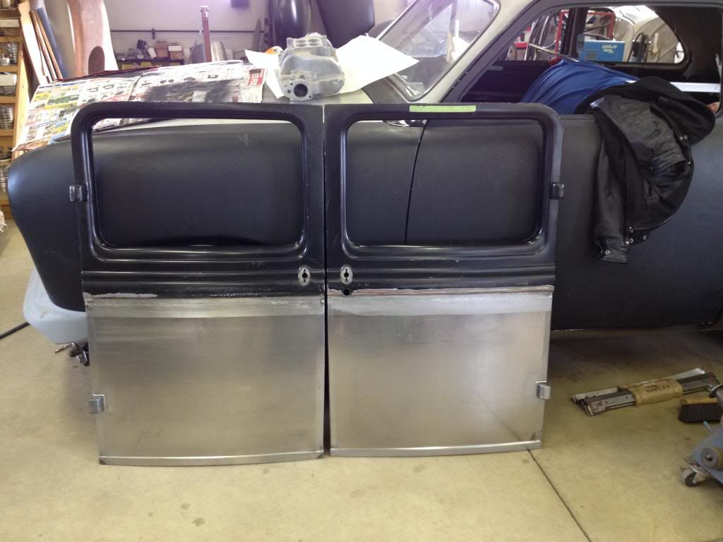

    First up, a set of over-weight 32 truck doors...
    Starting with...
    Just a hint of the hinge reveal molding.
    Some rivets...
    A little "Plop"
    Some fresh out of the wheel, skins...
    Out with the bad...
    Brass is for trophy's....
    Time for bottoms..
    Fabbing up new door frame bottoms...
    Looking the part....
    Next step will be to remove the rust and do the fitting...

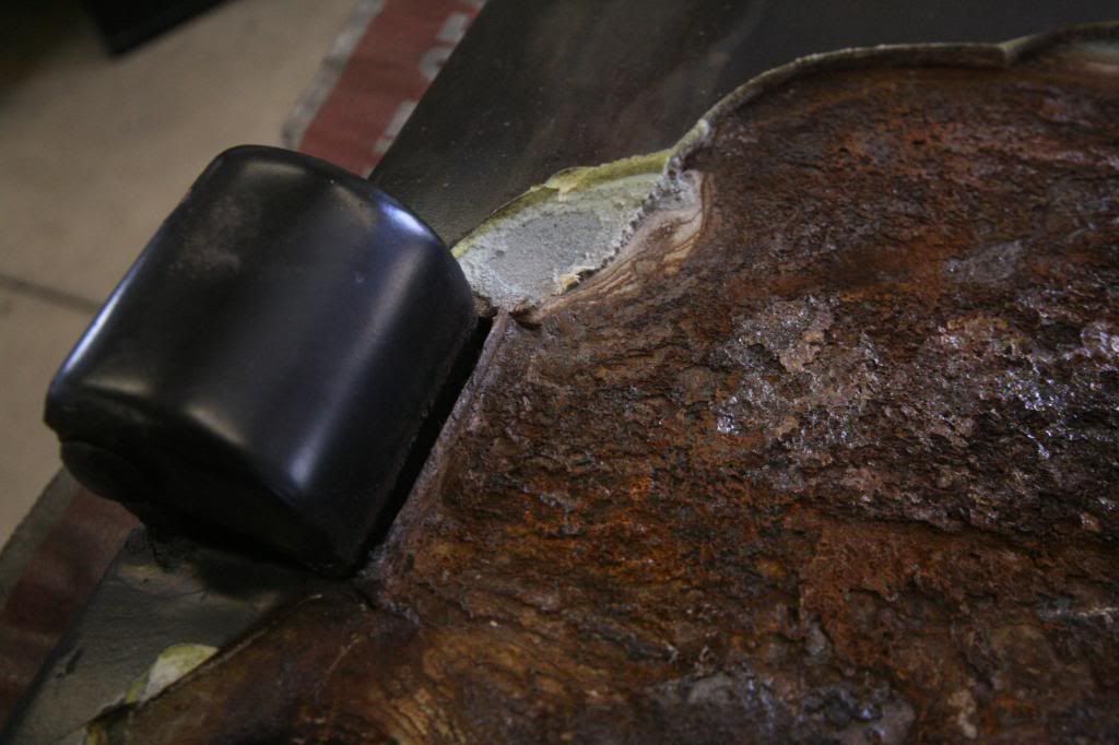

  6. Off to the drivers to see what we have...
    Uh Oh....
    Not good
    The skin was brazed right to the hinge!
    The door frame below the hinge on both doors was pretty much pooched..
    And the rear corner...
    The lower part of the regulator panel was so bad I just replaced it..
    I had to find the correct bottom molding profile but, had no luck anywhere.
    Fortunately with a little careful detective work....
    V walla.....

  17. This is the bit that sets my skins apart...the hinge reveal...
    First I have to make sure the hinge is in the correct plane, fore and aft and up and down. this is critical or no one could fit the door to the truck...
    Hinge pins are in alignment...
    Swage in the reveal....for deuce roadster doors I actually made a set of dies for my brake press
    Carefully trim for the hinge..
    Looking like a door skin now...
    Trial fit, as you can see the skin now has the fold over flanges...
    Oooo looks good...
    Stand back...a little self indulgent pride...
    Make sure all is well with the recipient...gaps hinges etc..
    Next thing will be to cut out the regulator panels to "hammer weld" the skins on. I do this to access the back of the skin for my weight or dolly..

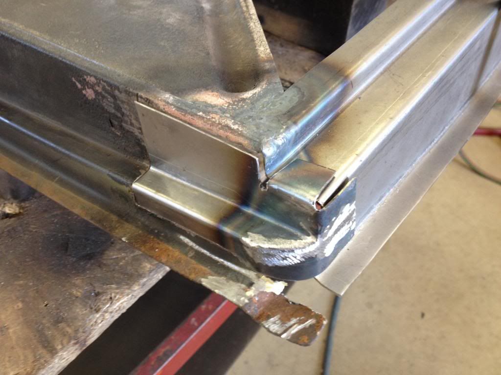

  26. Same thing to the drivers side..
    <a href="http://s1105.photobucket.com/user/hammerweight/media/IMG_7572.jpg.html" target="_blank">[​IMG]</a>
    Some weld detail...
    <a href="http://s1105.photobucket.com/user/hammerweight/media/IMG_7573.jpg.html" target="_blank">[​IMG]</a>
    The inside...
    <a href="http://s1105.photobucket.com/user/hammerweight/media/IMG_7574.jpg.html" target="_blank">[​IMG]</a>
    Getting there...
    <a href="http://s1105.photobucket.com/user/hammerweight/media/IMG_7576.jpg.html" target="_blank">[​IMG]</a>
    A little detail of how the bottom corners go..
    <a href="http://s1105.photobucket.com/user/hammerweight/media/IMG_7586.jpg.html" target="_blank">[​IMG]</a>
    Then
    <a href="http://s1105.photobucket.com/user/hammerweight/media/IMG_7589.jpg.html" target="_blank">[​IMG]</a>
    Result..
    <a href="http://s1105.photobucket.com/user/hammerweight/media/IMG_7590.jpg.html" target="_blank">[​IMG]</a>
