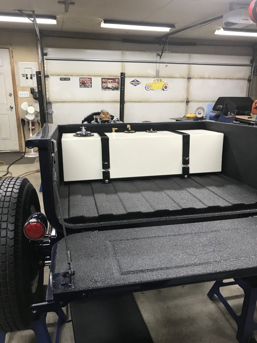

    I used hard line coming off the top of my RPU tank and then I ran it down to just through the bed.
    Then using the proper fuel hose (Gates Barrier) and fittings I made a short flexible hose to connect it to the fuel line on the frame.
    There is another similar hose up front going to the fuel pump.
    There are no hose clamps in my system.
    176A6A7E-E778-45EE-8F14-7D3CA9F39E40.jpeg 96A02B85-3092-4105-89E3-4DC1A653809B.jpeg 9F076E81-4234-4104-8FAF-94BD63A36A21.jpeg 5855F51C-586F-4627-938C-9B67024A8A47.jpeg

    You used some nice pretty fittings and everything looks good.
    loudbang and Blue One like this.

    That's a clean setup. Thanks

    The idea was not so much for movement as there will probably be very little.
    Future disassembly however is a consideration and the hose and fittings make that much easier.
    It’s called planning.

    My plan is to be able to remove the tank and then since the hard fuel line runs through the metal bottom of the bed through a tight fitting grommet , consider what would have to be done if the bed needed to be removed for some reason like repair etc.
    Trying to explain this stuff is getting somewhat frustrating :rolleyes:
