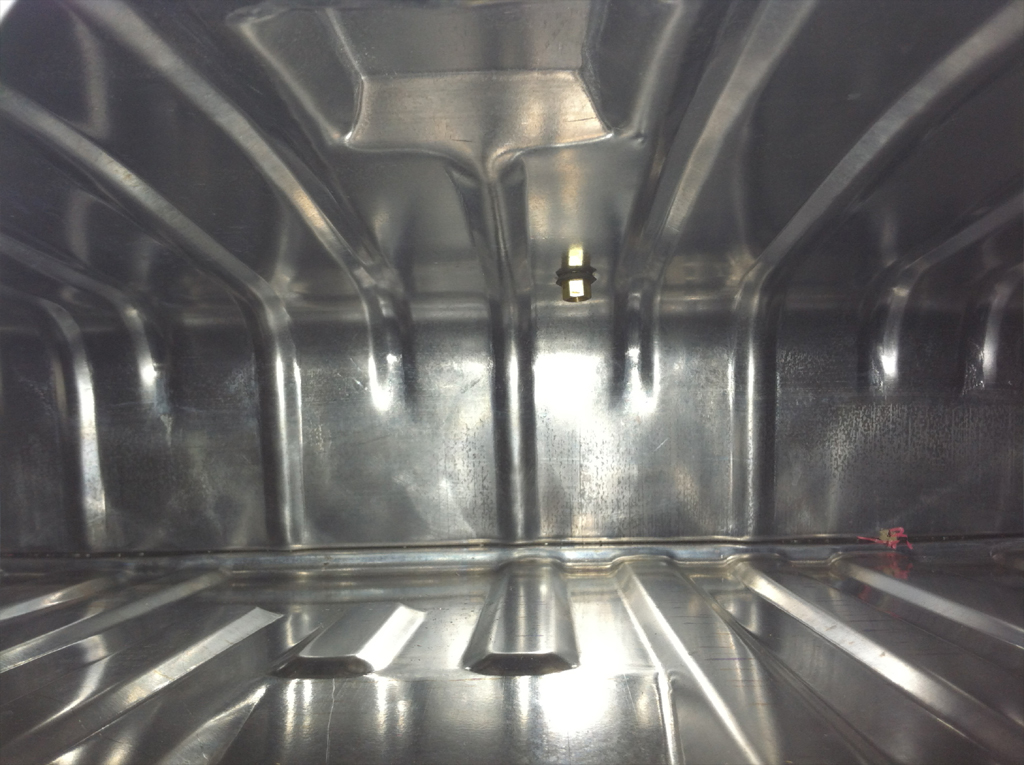

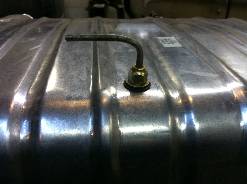

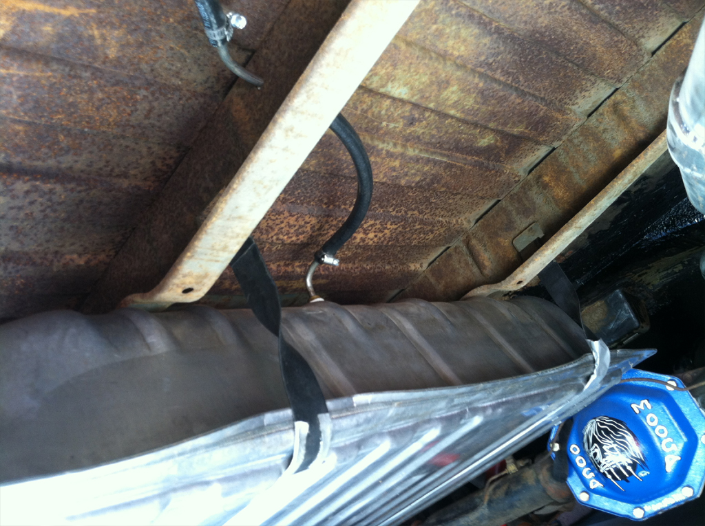

    Currently here are the pics from my latest tank upgrade.
    PLEASE NOTE: I am an not suggesting in anyway that a fuel tank should ever be altered in anyway. The photos I share are simply to let you see what I have done. Be safe, Never work on a fuel tank that has had fuel in it. Be smart, dont blow up your garage or kill yourself.
    I've added a vent to my current tank
    Here is an inside view.
    Here is a view of the vent hose connected. All of this is located on the Passangers side of the tank.
    I'm in the process of repainting my Ranch, and the weather has not been very hot anyway.
    While the paint is off, I will try to fab up a Fuzzy Knight filler neck and let you see how that goes.
