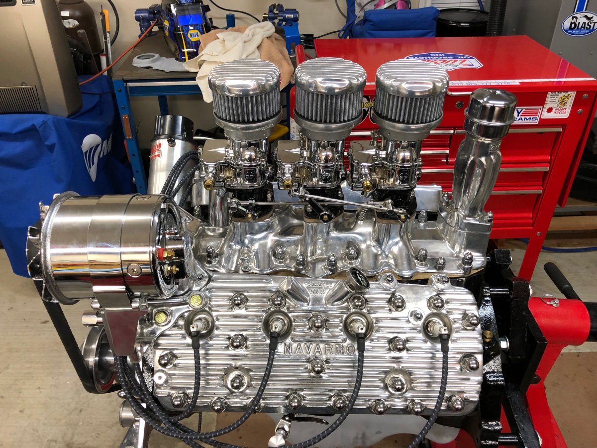

    I did a very similar thing on my flatty. 4 port moon block, 3 lines, one gauge. Mounted the block to my carb spacer, flex line runs to the firewall mounted fuel filter. Pump in the tank, hard lines (and return line), other than the short run the blower.
    Pic is a little dark. I changed my progressive linkage out, now running all at the same time. In that situation I favor each having their own supply line. It may not make any difference but I like the look and the logic of it.

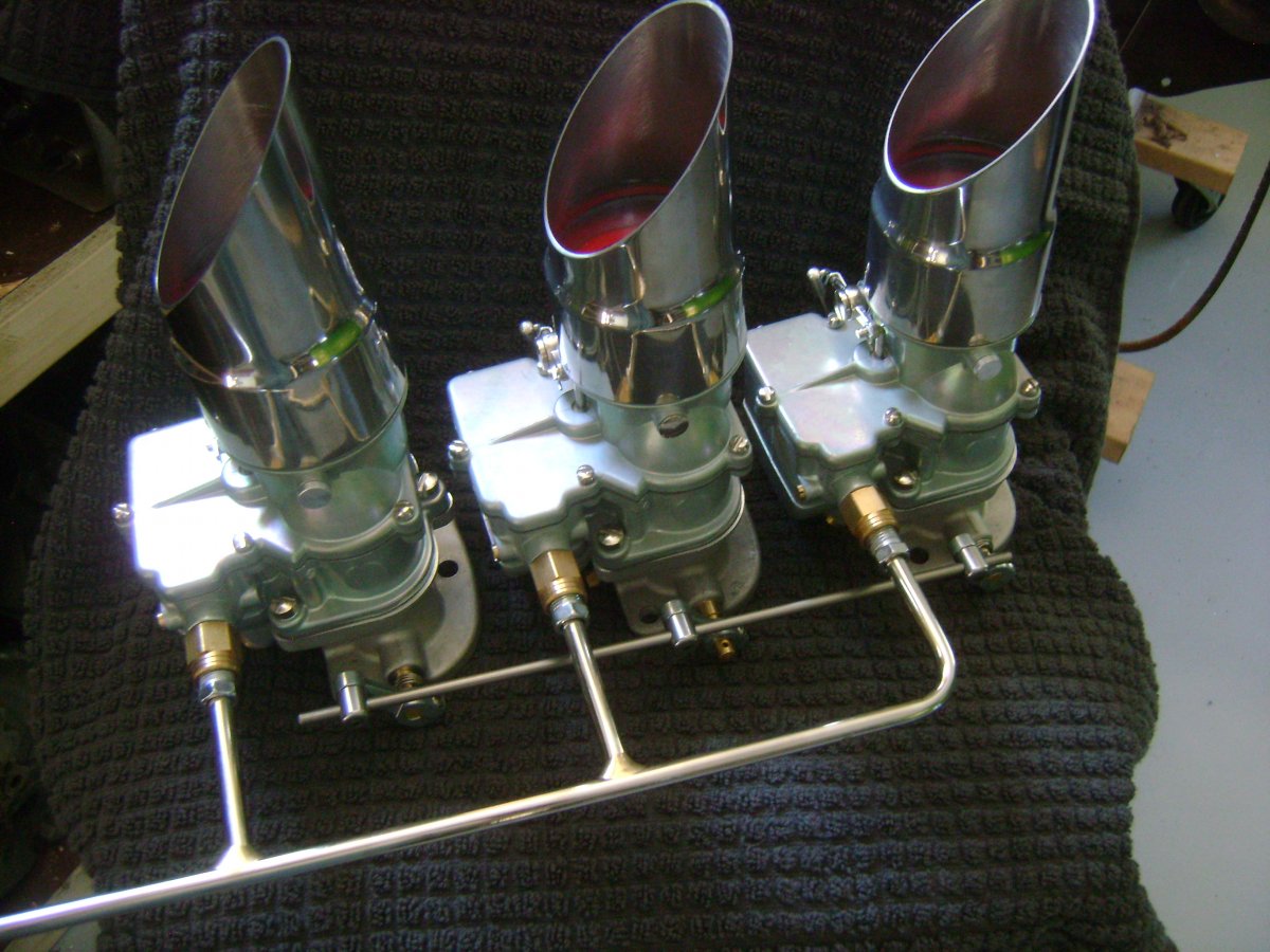

  9. Something like this is easy to make and you can just add your choice of fittings. This is a photo I "borrowed" but I do have something like it stashed in the garage somewhere.
    I have occasionally put bright brass to soak in pickle juice to add some rich, brown patina.

    Nice look but the OP has a Navarro intake and unless I am mistaken his carb spacing is tighter than yours. I know my blower adapter is a Navarro piece and I had to make my own fuel inlet due to the tight spacing.
    I normally use stainless for everything but I did build those short lines on my motor out of aluminum because they are so tight. I used compression fittings and chrome nuts. Aluminum is soft, I dinged one of the lines using a bender and had to start over.
