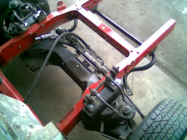

    Good thread. I am going to pick up a 50 Stude 2 door champion today. Not using any of the stock suspension though. This one is going to be a straight axle gasser with quarter elliptic rear end and a 56 Olds rocket for power.

    I will be pulling parts from mine soon if anyone needs 50 front suspension, overdrive trans, gauge cluster, radio, seat trim there will probably be more. I will be getting pics as soon as I feel better. Picked up a damn cold thats kicking my ass.
