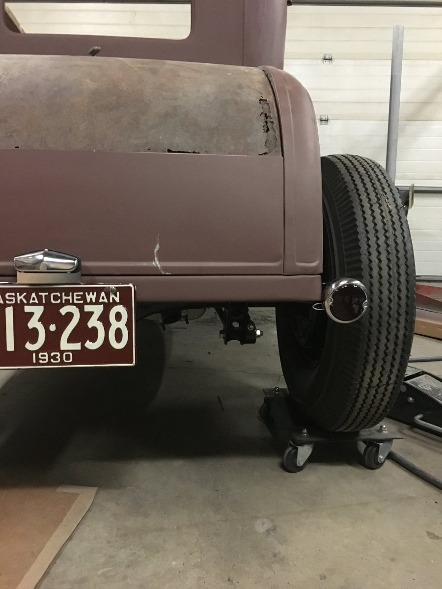

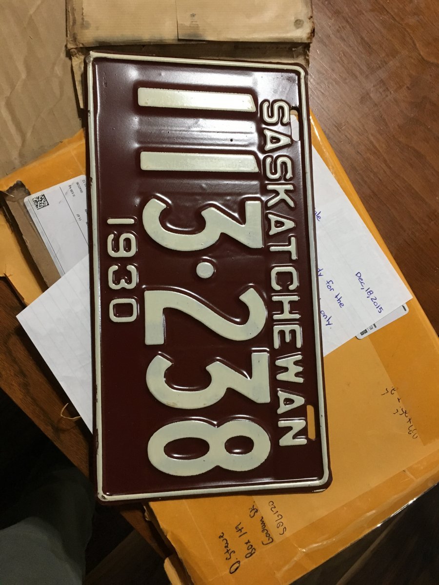

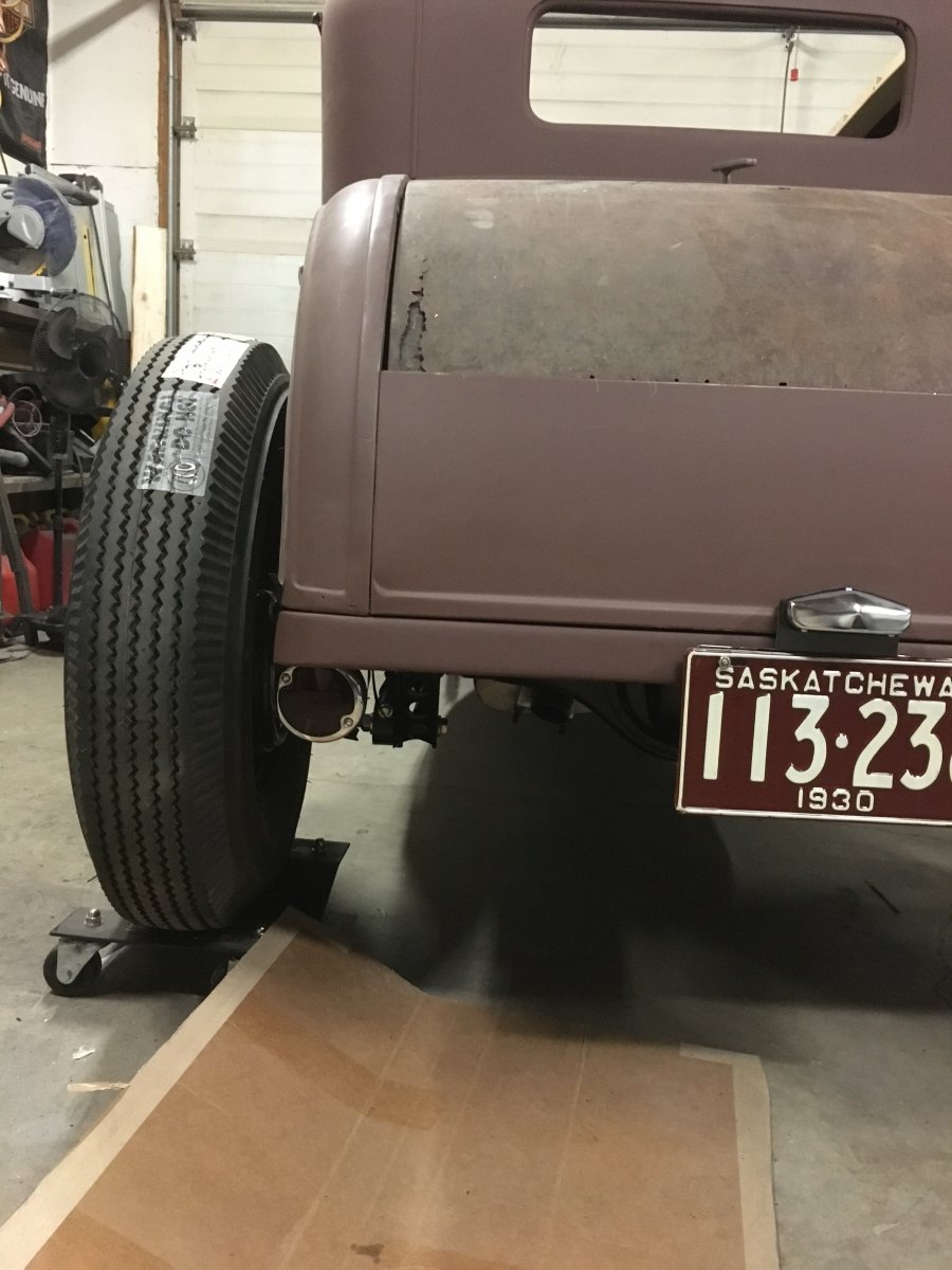

  28. A few years back the wife bought me these never issued 1930 plates that came in the original packaging.
    I followed our local rules and got in registered and got the plates approved. I was pretty ecstatic that I am able to run them.
    Figuring out tail light mounting..
    Eventually I went with tucked underneath. I think it looks ok.
    I didn't want tail lights and license plates in the lower panel so I hung them that way instead.
    Later on you'll see the finished product.

  30. I think it looks cool that way. Around this time I was out of town going down the highway and came upon a 32 ford street rod. He had old taillights with regular incadensent bulbs and you could barely see him at dusk.
    For that reason I ordered LEDs. Combined with tucking them under the body I needed to be seen. These look stock when off, but pretty modern when on. It’s one of those trade offs.
    Plus I went with led signals for the headlights and an LED flasher made sense over resistors.
