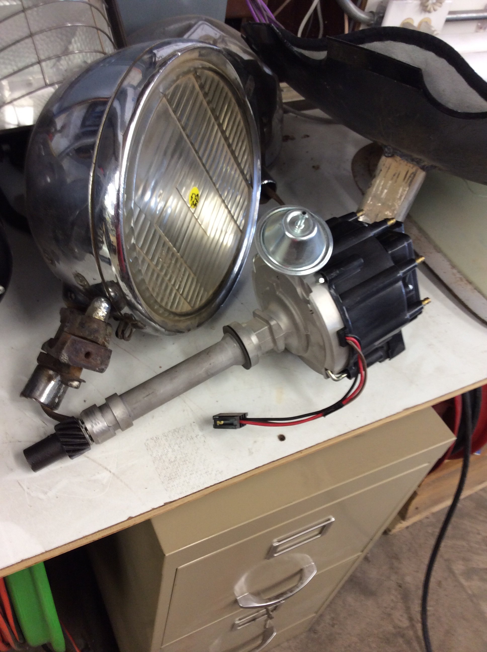

  9. kscarguy
    Joined: Aug 22, 2007
    Posts: 1,576
    kscarguy
    You won't believe it, but I have yet another broken part!!! The cheap, new "Made in Taiwan" HEI distributor broke the electric plug that connects to the distributor cap. I barely pulled on the locking tab and "snap", it instantly broke off. I even asked the performance part store guy if they had issues with that (since the reviews on Summit Racing catalog said their distributer has that problem). I was assured these were good...good for nothing.
    Blue...tell your wife I said "hi". ;) LOL!!!

  11. Mike it's the big cap unit but should fit ok? image.jpg image.jpg image.jpg Kan. Only couple of days on UPS ,and I can get it out Monday pm . Blue

    Thanks for the offer, but I actually have another good used to use. I even ran it on the engine and it worked great, but I decided to install a brand new one so I wouldn't have any issues..."yeah that idea worked out just great :eek:"
    FYI - If I do decide to install the TBI, I have yet another different distributer that I will need to use.
  13. Offer stands if you need it , got a couple . Blue
