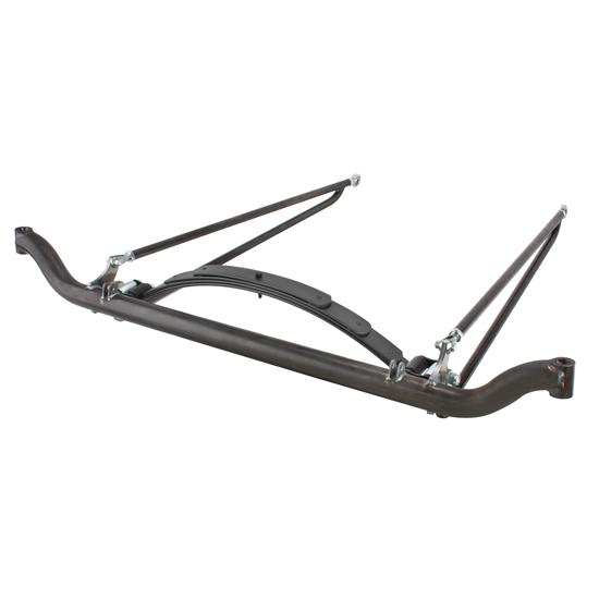

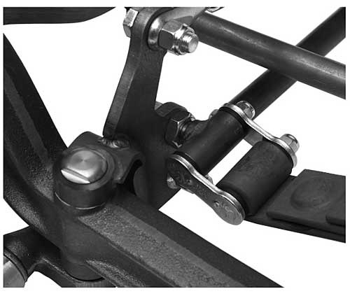

  12. This is how 98% of the spring perch is attached to the bat wings
    The shackles are at 45* with a full load. You should need to spread the spring with great force to get it mounted, the shackles with no load will be at 180*

  26. That spring at 48" is way wrong for sure! It's too long and you won't be using it.
    Look at your axle and look at the pic I posted. Actually look at it.
    Look at the link tfeverfred posted.
  27. That is exactly why
    And you won't be welding shackles. Again study then pic above. Batwing bolts to axle thru the axle's perch boss and that's your fixed dimension. Spring Perches bolt to batwings and spring hangs between on shackles.

    I think you need to put up some pictures of what you have.
    It SHOULD be fairly obvious to you, from the pics already posted, that there is a better and simplier way to attach the shackle perches to the "bat wing" than welding them on!
