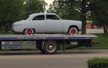

    Aerostar front coils & 3" lowering blocks rear.
    I have 14" rims on now, have 15" rims that will eventually be used.
    flatheadpete likes this.

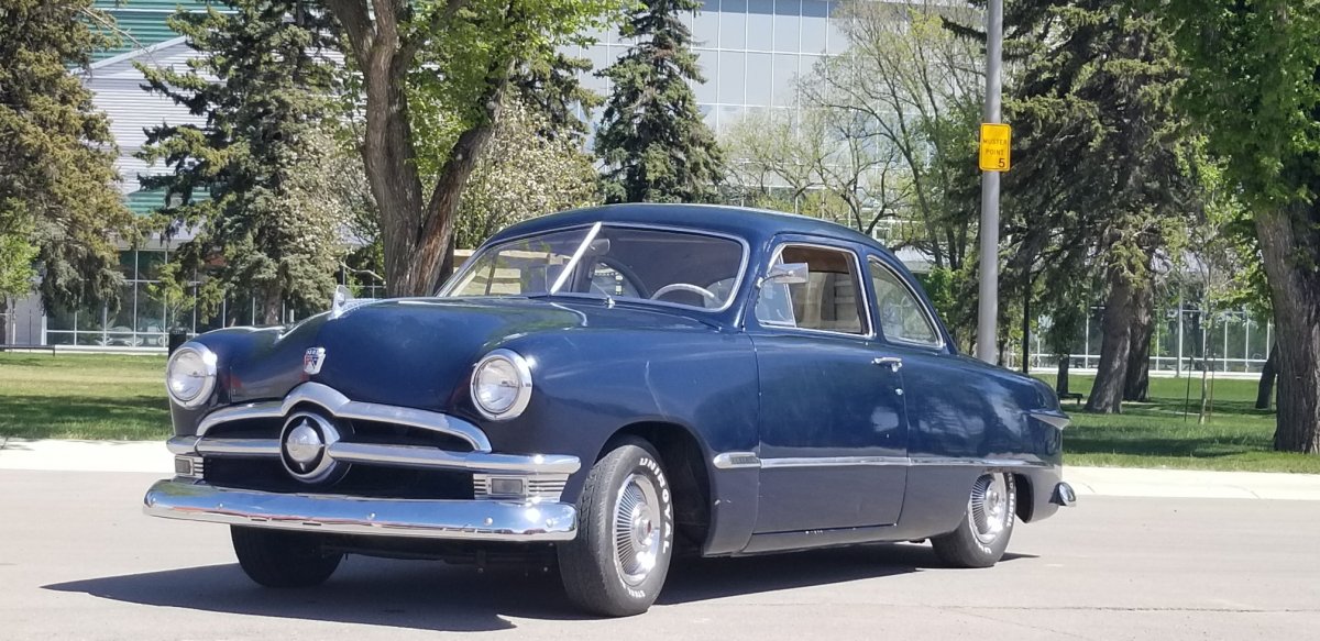

    25 years ago I have put the butches style blocks in a 50 ford with results I felt were good . Not long ago I made some blocks for my 55 bird. started with 2 inch material when I set the car on the ground way to low. front tire were kicked in hard at the top looked like it dropped the car about four inches .I tried to cut them in half with a band saw. they were not super straight had a buddy mill them down strait. ended with about 3/4 inch. I do not know how but it seems it lowered the car close to 2 inches. took it to get aligned didn't need anything 0715202023.jpg
