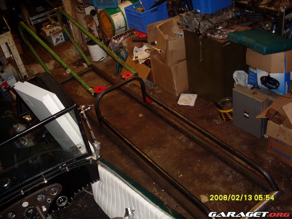

    I put the "blueprint" ;) on the workshop floor and adjust the pipes to make it fit.

    Youthink about the green pipes?

    I would seriously doubt those green tubes are something that would pass NHRA tech inspection to even let it cackle. You really need to rethink that a bit. The minimum spec is 1 3/4" .120 wall DOM tubing for a roll cage section. Most order that same tubing in a .130 wall so that it doesn't distort to below allowable thickness in the bends.
    This all may be a bit here or there, because of the double tube roll cage design on these chassis, the NHRA won't let them really run these days without some serious modifications. I know that you are over in Sweden, so I don't know how this might effect you, but it would be a shame to spend allot of time and money on a car that you would NEVER have a chance of teching because of materials used in the chassis itself. Best to spend a bit more and do it right the first time and be that much closer to correct and safe so they CAN'T find reasons to not let you run...

    No, these green old pipes are the models to making a new set. Ill do the fit with these and let them be replaced of a new pair of pipes.
    These might have rusted inside too..

    Yes the green tubing I am guessing that you are using them for a pattern to take to someone that can bend the proper tube for you.

    yes your right =)

    Cool! Thanks. I have been told otherwise over the years and I have repeated what I was told. You build race car chassis for a living and are far more up on the rules. I am a bit surprised though about DOM not being specified. I had also been told by several different chassis and cage guys about the bends being the reason for going heavier than spec on 'cage tubes. Sorry I got it wrong.
    The main thing I was concerned about was it looked as though he was about to use a pair of old swing set tubes for roll cage parts on a dragster chassis. Now that I know he's using those as a pattern only, i'll just sit back and watch the build and stay relatively quiet...

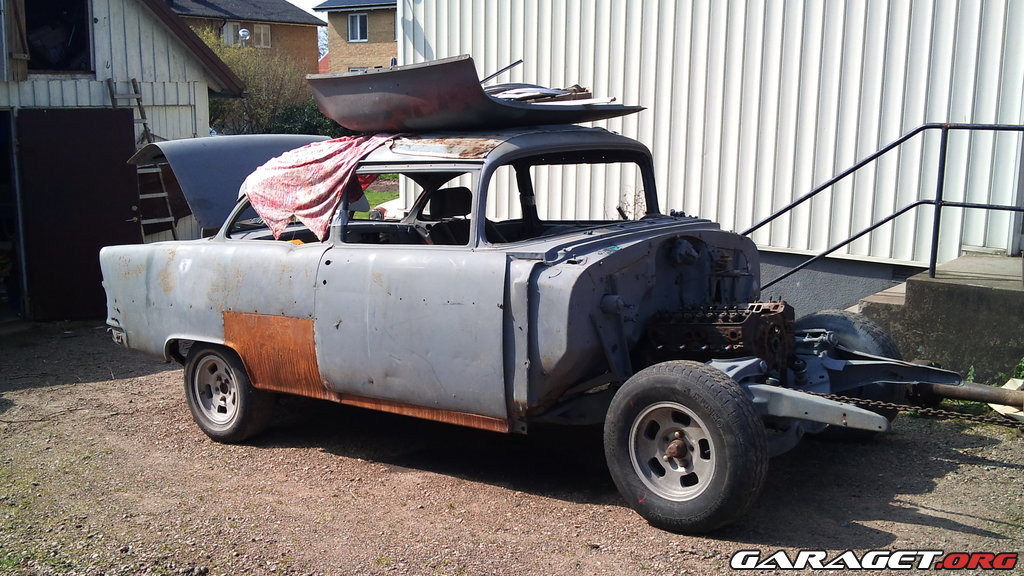

    Taking out the chevy, to clean out the garage
