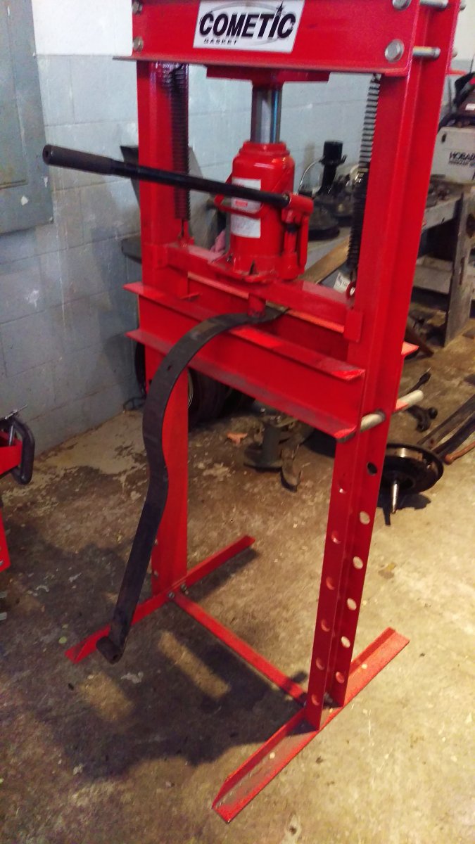

    You can reverse the spring yourself in about 20 minutes with a cheap ass harbor freight press.. IMAG0513.jpg

    My wife does all of our spring leaves on a souped-up HF press. Air over hydraulic ram made it much faster...foot operated valve.
