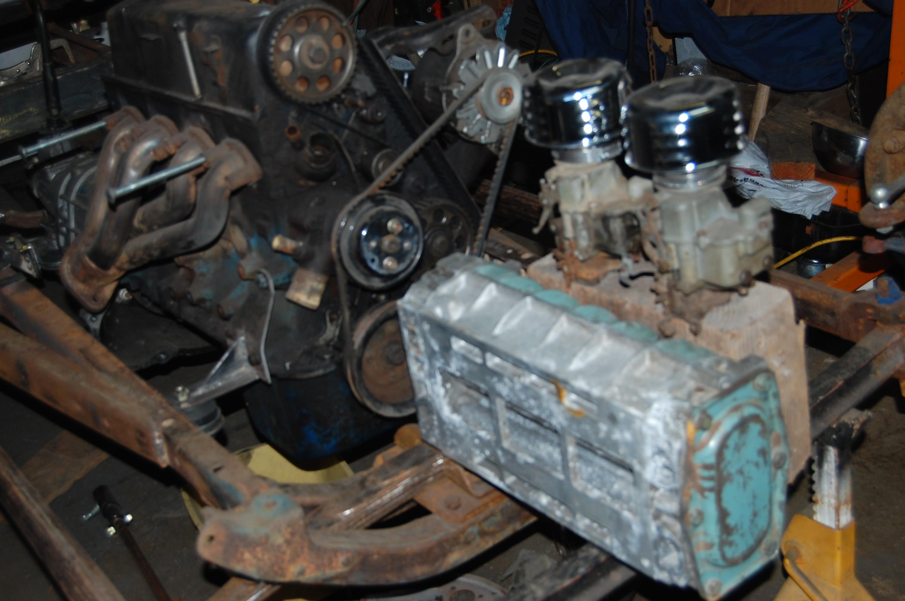

    Here are the pics I promised. Quick mock up to give you an idea.

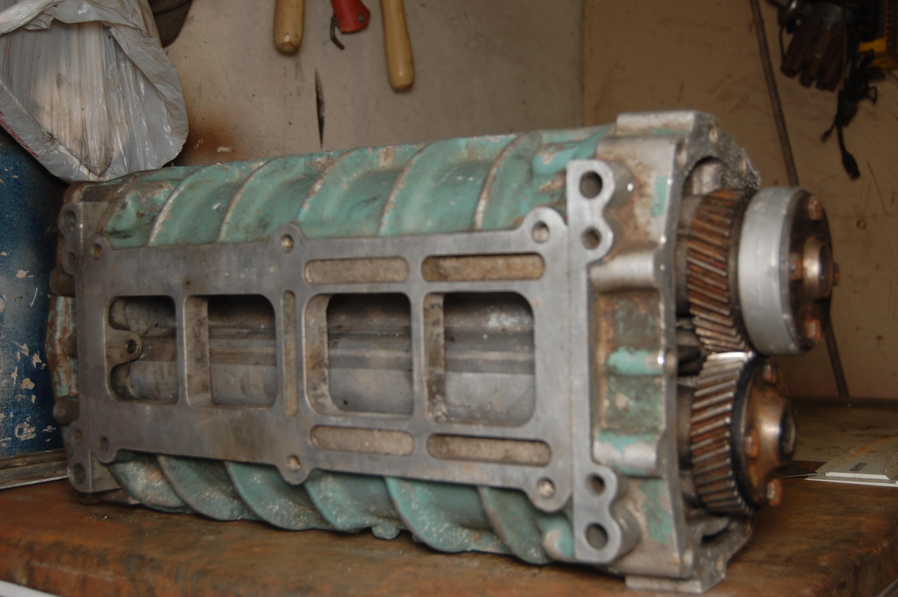

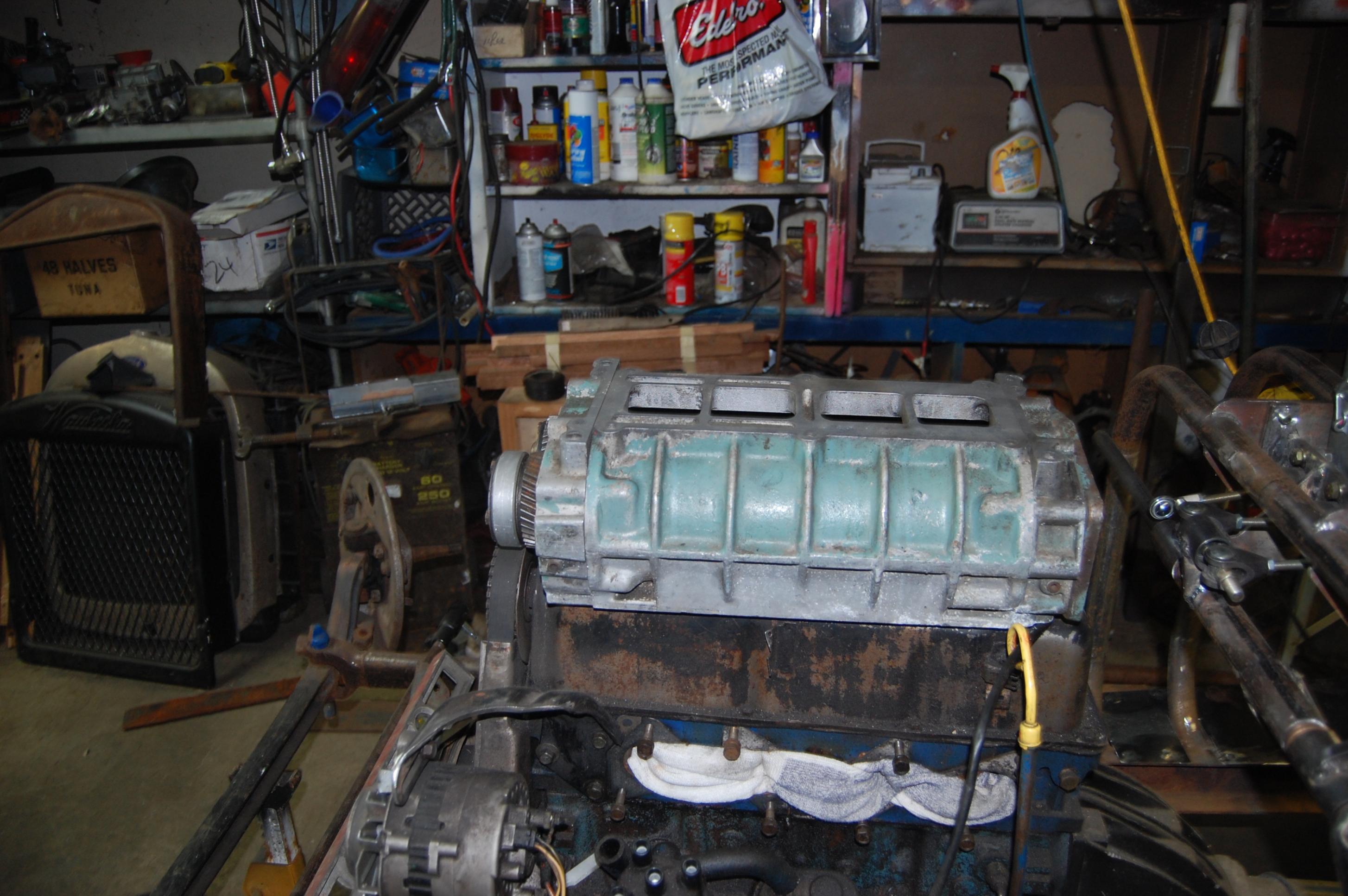

    Did some mockup on my friend's modified to show kind of what the plan is. The second photo is sitting on top of a Ford 2.3 to show how long the blower is.
    Any ideas on what carbs to use? The carbs pictured are just a mockup set to give an idea on options for induction. This is going to be a street driven daily driver so the cam won't be too radical even though the overall look of the truck will be.
    I plan on using some end plates with the centers opened up and stacked for a quick change gear housing coupled up against the blower gears. the shafts will be cut down 6 spline model A drive shaft ends. A love/joy coupler on the crank to drive it all through crank hole in the 29 A grillshell.
