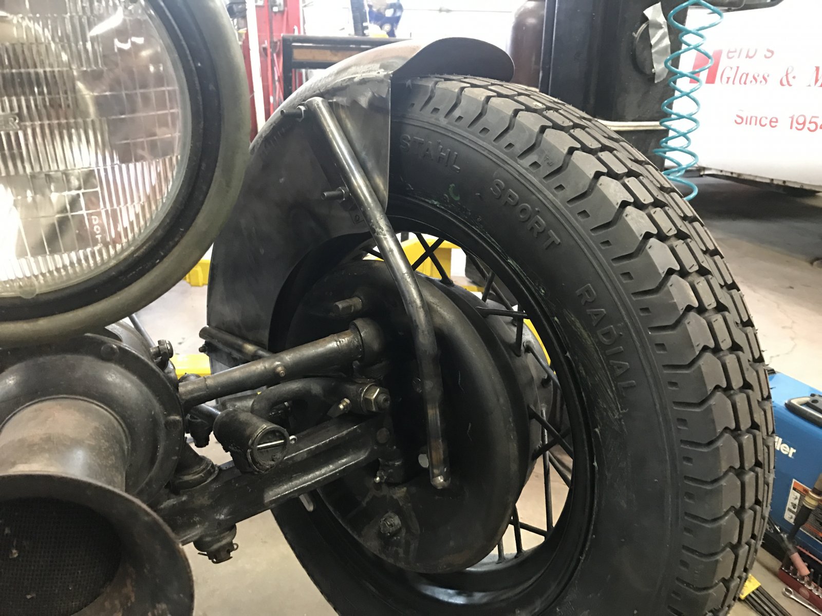

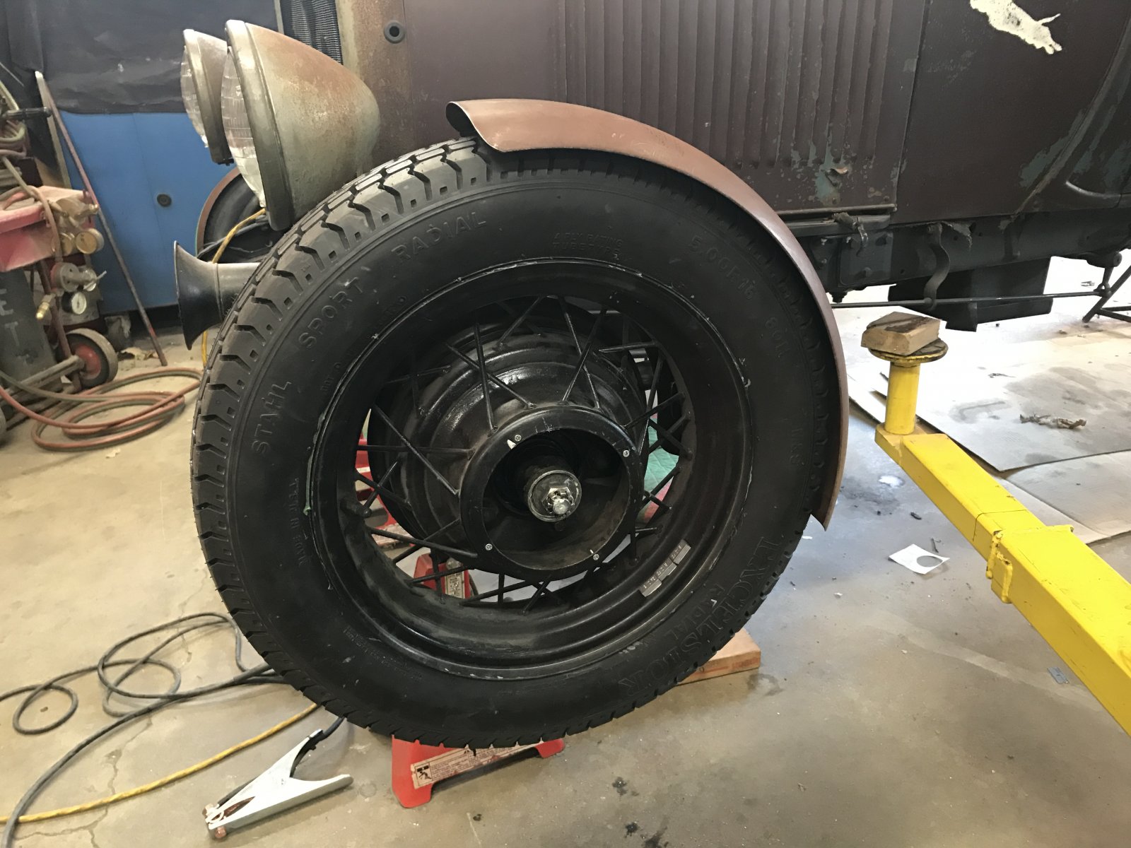

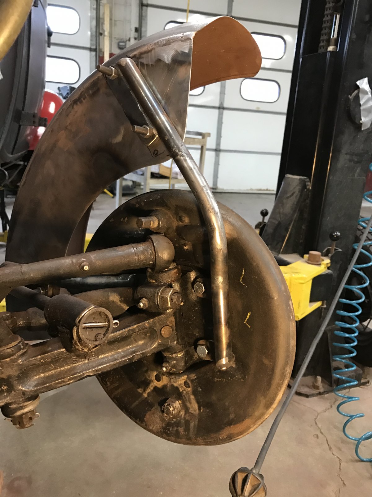

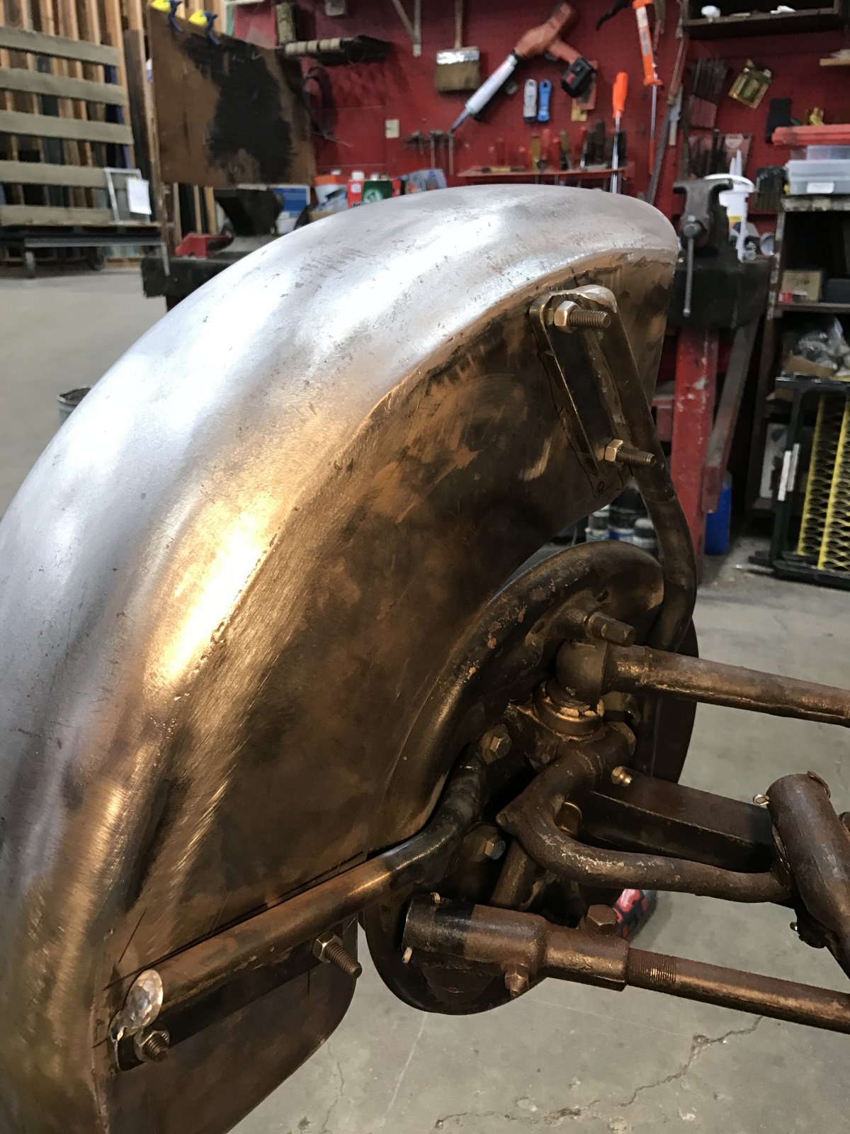

    Having broken mine a few times, I encourage you to build them stronger than you think. Why? These fenders feel every bump along the way. Unlike "regular" fenders mounted to a chassis, these move with every move of the front wheels and feel every jolt along the way. The picture below was the first edition:
    Needless to say, they broke on me a few times.
    The photo below shows the third or present version. Note the gussets and addition of the circular brace (like your example).
    Something you can't see is the steel under the fender that the supports are welded to. Yes, this connection broke once too on me. My suggestion in your build would be to mount the braces on the fender end to something more substantial than the fender itself.
    Once more--it's tough out there for these fenders. IMHO the right side has it worse.

    AVater your post was one I studied a lot. Did you use solid or DOM tubing? I was thinking 5/8" diameter and fabbing some internal brackets inside the fenders to attach them to.

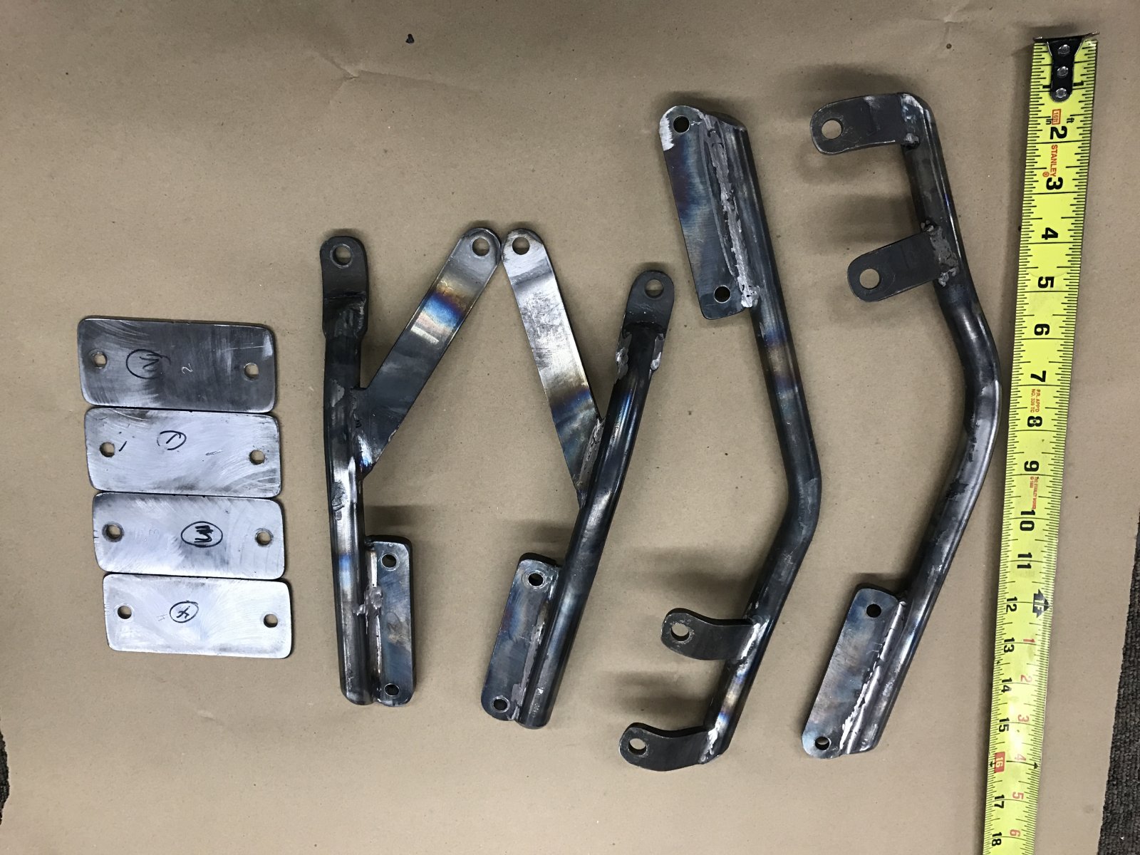

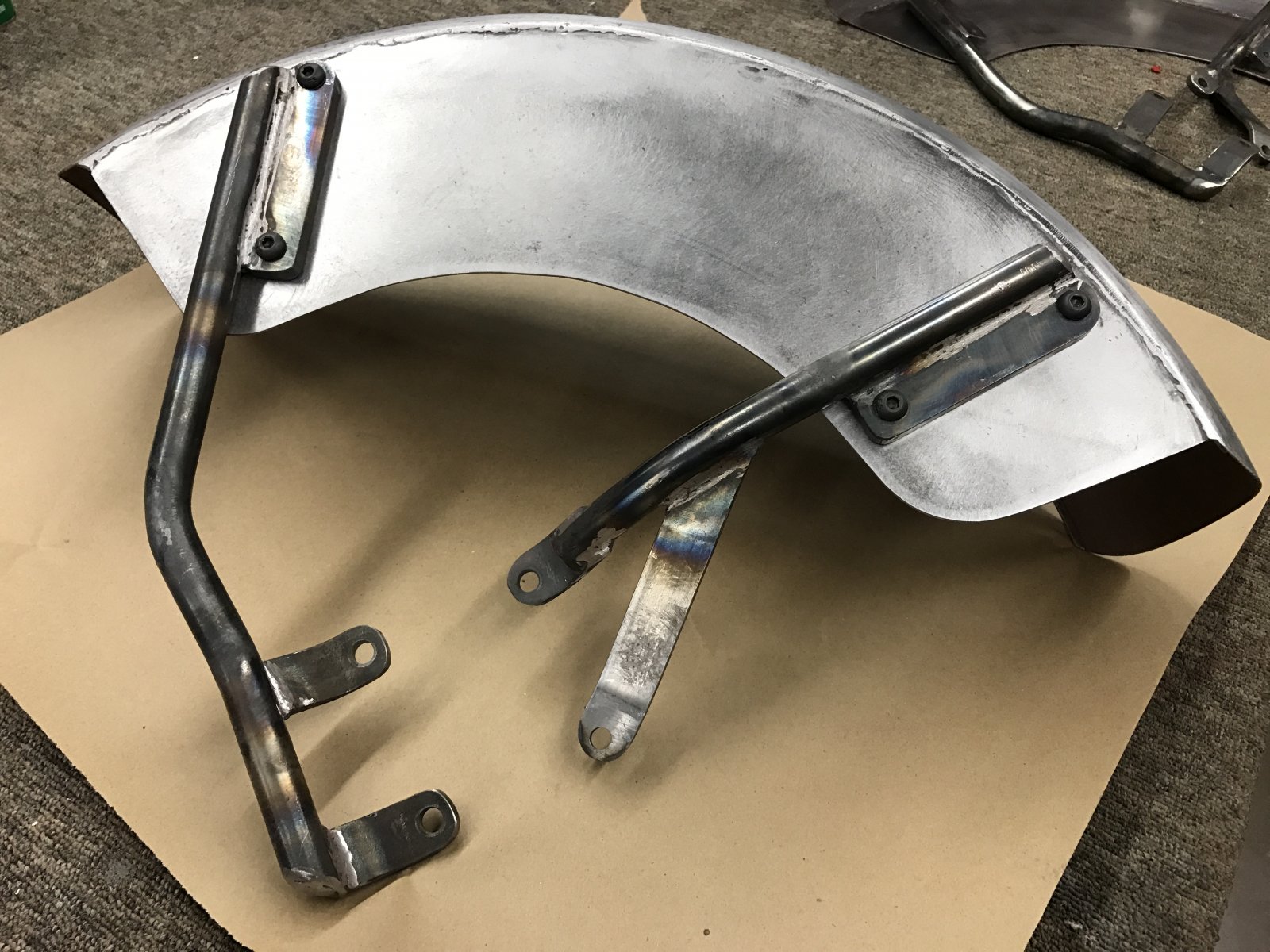

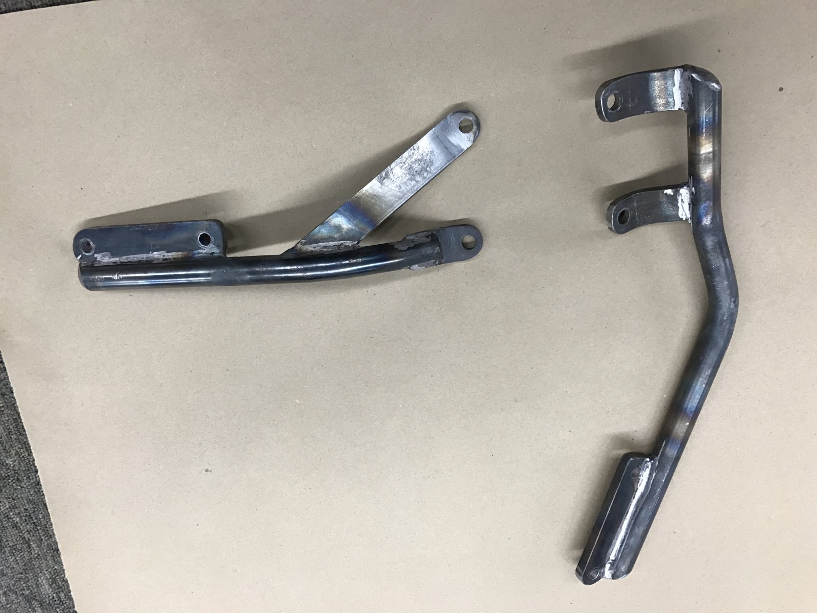

    5/8ths DOM works and offers 3/16" plate mount flanges (3), a place to weld both sides. Never had a failure. Make one continous tube bracket that begins at outer edge (inside) of lower rear of fender (4 or 8 o'clock) then stand off the tire sidewall as you bend it. Weld to rear lower plate. Pickup the rear hole, then forward and Up, around lower front hole, capture top hole plate, then standoff tire sidewall, pass over top of tread (clear it), fasten fender to the tread tube-extended portions.

    I used solid rod. Looks to be 7/16” but with paint etc could be 3/8”. Frankly the rod was something I had in the garage. If I did it again, would use thicker or perhaps DOM as suggested. Here’s another thought: old Ford bumper jack handles are 1/2” may be hardened?

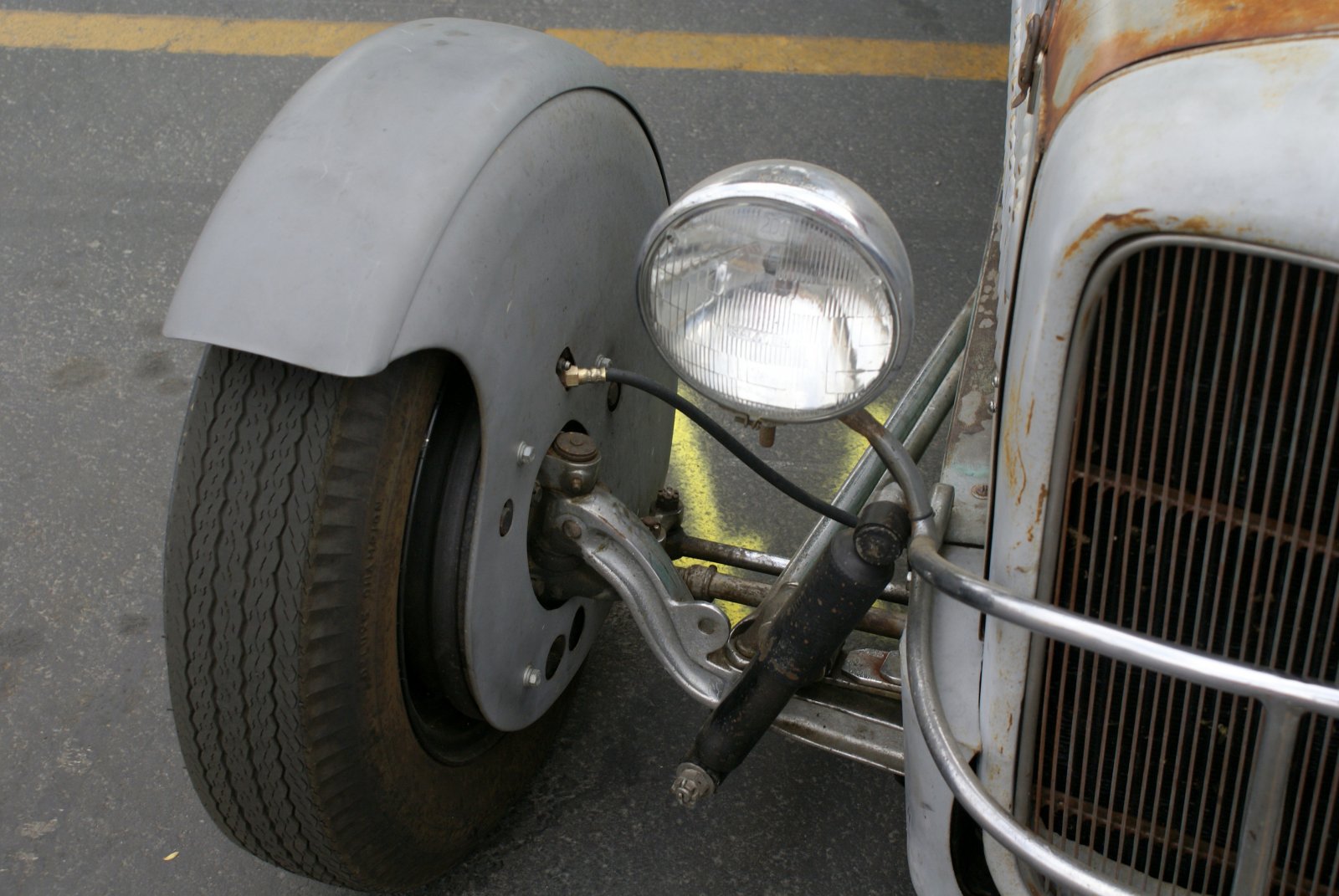

  18. I used bicycle forks on the basis that they can support a 200lb man over rough ground they can support my mudguards.
    Bolted at four points and gusseted. Rubber between the support and the guard to reduce vibration.

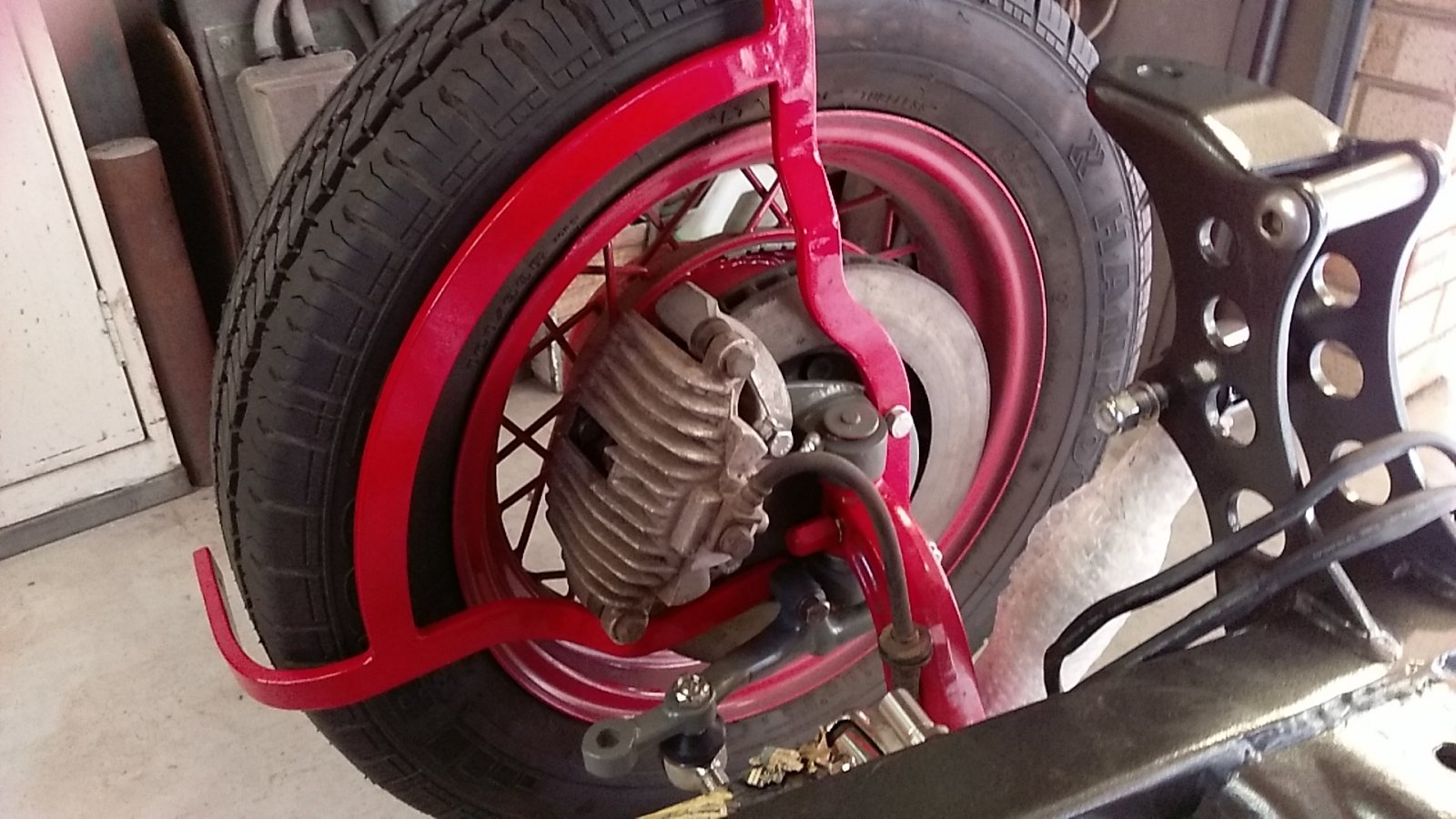

    Somebody apparently did it with my old speedster, back in the day. Here are the cycle fenders that came with it, front (left) and rear. Outer supports connect to a spindle nut.
    Thing is, the castle nut spins freely inside the support, but there's no provision for a bearing. So apparently it just rode metal-on-metal? Seems crazy. Perhaps they were bolted on for show and removed for extended driving?
    Anyway, not sure this helps the converstation. I'm just saying, it's been done.
