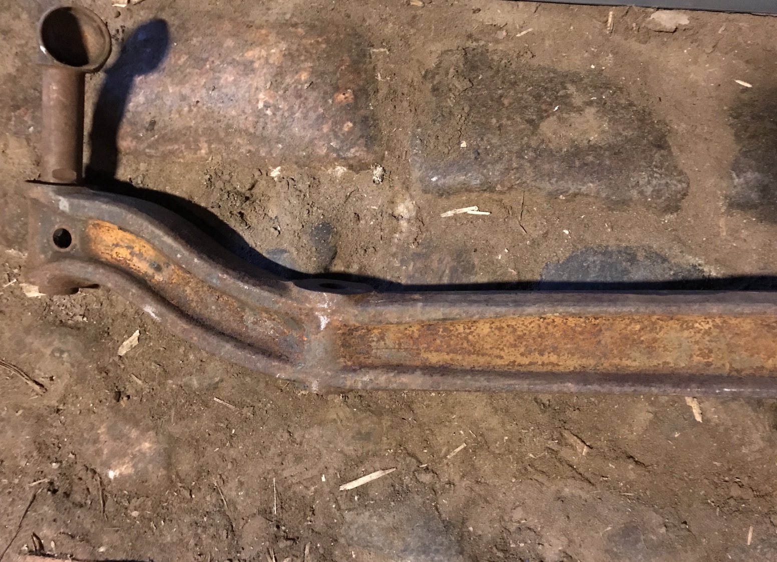

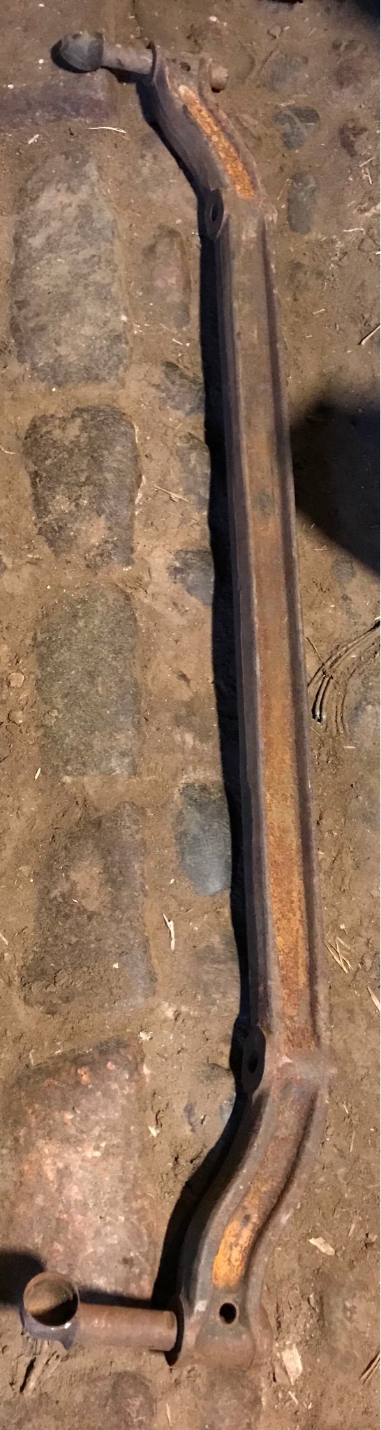

  1. Well, here I went, and thought I’ve bought a ‘32 heavy axle. And I must admit, it is heavy!
    But when aligning with my model A axles, it seems to be an inch narrower between the spring petch bolt holes/wish bone legs. And I was under the impression, they were aprox 36,5”, whee as this is only 35,5”:[​IMG]
    What is it, I’ve got: wrong assumption about ‘32 heavy being same width between perch holes, or different axle?
    Pics for reference:

  2. My 32 heavy out of my PU does measure 36.5 at the perch holes.My wild ass guess is its out of something like a 33-34 1 ton.The center of the ends on my heavy are different too.

  3. i don't think that is a `32 heavy
    ABONES and Automotive Stud like this.
  4. I,ll second that.
    wbrw32 likes this.
  5. It is NOT a 32 Heavy,,,,,,,period….

    Well, it is Ford, but not a regular Ford of any kind. Is it straight between the perches? Looks like it in the pics.
    Beings that you are in Denmark, I think it is some Euro-Ford special piece.

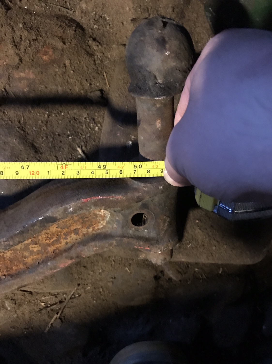

  7. More measurements, taken this morning:

    '32 heavies measure 2" high at the spring boss, and 2-3/8" at the king pin boss.
    I second the motion that it's out of a 1 ton truck, pre-1940.
    What is the diameter of the king pin? Same as a car? If so, axle bosses could be milled, and a longer main leaf rolled. Nice shape to it, pretty end sweep.
    Even in Denmark, Fords were smaller; German Fords, English Fords, etc.

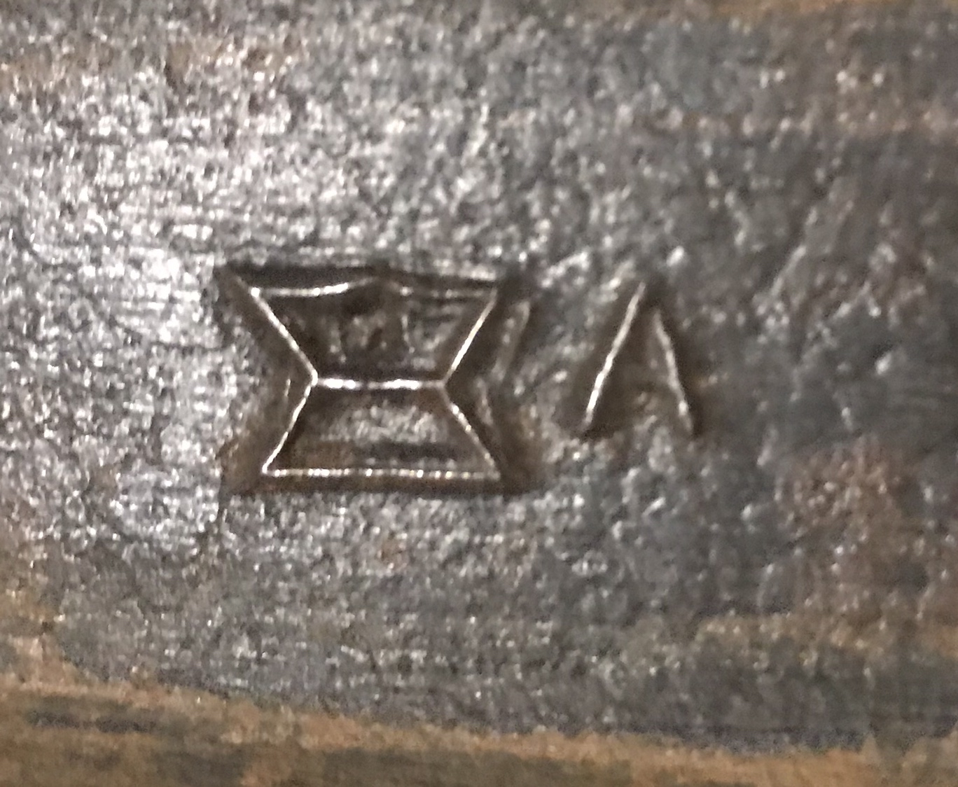

  10. Only marking, I’ve found: [​IMG]
    A ‘32 spring perch is too small, leaving quite a gap:
