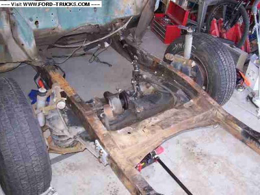

    Problem is I sold my front suspension with side 3 inch drop axle. If I get a refund and take jag front clip I have no steering or suspension. I sent him( shop owner) a link to this thread and said read what people are saying about your work. This needs to be fixed. They assured me it would be I bring it back June 6th and I wish I knew someone in the Los Angeles riverside area that would meet at the shop so they can hear as they explain what they are going to do to correct this issue. Like I said before I really don't know anything about suspensions and thanks to a member earlier in this thread I now know what good welds look like. It is just disappointing when you take you truck to someone you trust whose a "professional" and then according to everyone here I'm driving a time bomb. I don't like getting taken advantage of. I Appriciate everyone's help.
    SO NOTHING IN THIS FRONT END IS SALVAGABLE? Nothing can be mounted differently to make it right? Anyone have any pics of their set up?

    The Jag frontend would be the suspension/steering that would replace the mess you have installed in your truck!!

    What does the shop mean by I would have to section your frame? I saw the clip and I see where they just cut the frame and I get that the frame of the jag is not as wide as my frame or vice versa. But what does he mean by sectioning my frame? Is that a bad thing?

    Don't worry about that... If you don't know about suspension, it'd be tough to explain that in one post.
    But a Jag setup would be much better than what you have.
    Here's a pic of a 48 ford with jag frontend, which is nearly the same as your truck frame wise...

    Add a "section" to the center of the unit. It seems the work they did on the existing front end was more work than sectioning the Jag front!! Now, they gotta do it all over again!! I don't understand why they didn't perform YOUR desired install, instead of that birds nest! Good luck man!!

    Fella i think its fair to say that from the feedback you have had from folks that know you need to do one thing. Pay for the rear, get a refund on your shoddy work, grab a trailer and get the fuck out of there.
    I'll put it another way. That front end is dangerous and wrong, period. The bag rubs out and goes pop whilst your driving down the road. You try and correct it but due to a poor amount of steering lock you plow into a car full of folks. They let you drive that and put yourself and others in harms way big time. Thats not just poor work like a shit paint job, that, if left would kill someone some day.

    I don't think they know how to do it... and I wouldn't trust them again with the truck. You'll end up with a botched up Jag install next go around!!

    Jag front is not a easy swap on the 57 on up F1. Iv done it and it needs the frame narowing if you want it low it also needs a zee. Have a look at the pictures. Might be better to look at Mustang 2

    well id like to introduce myself. my name is josh. i designed and installed the front suspension on this truck. ive been doing suspension and frames for the past 8 years. i was the one that told kevin the jag front end would not fit under the front of the f100 without narrowing the section it would weld up to. he then gave me full range to build the front.
    first issue. welds. yes the welds dont look the best but i can honestly tell you the welds are safe and have plenty of penetration. every piece of metal was beveled at a 45 before being welded. and every weld had atleast .5-1" of heat dissipation on both metals being welded.
    2nd issue. tie rod end. im not sure wether its the spacer or the fact of the adapter being welded to the rack. the metal welded to the rack is .25" wall dom and the adapter then welds to that. it is very strong. me or kevin has had 0 issues on that setup as most vehicles with extreme suspension travel require a heim and the spacer is there to give the correct amount of bump steer for cornering.
    3rd issue suspension design.the design is a basic mustang II but with the upper raised 2" to correct camber at lower levels of ride height. it was also designed to have 3 degrees camber change from full droop to full bump.
    4th issue bag placement. this front suspension was designed to lay the crossmember on the ground. this was a misscomunication somewhere and im not pointing fingers but it was then decided to not lay and thats why a spacer is on top of the bag. if the spacer was not there it wouldnt rub on itself.

    now i will fix whatever you see wrong. grind down every weld and make them look beautiful.
    Blake, you can message me directly on here or fb and i will gladly give you my phone number to talk to me directly about it. i stand by my work 100% and will gladly redo whatever.
    i just had to chime in here. it would be different if i had no clue what i was doing but i have 8 years under my belt and took 3 welding class's so i know the proper dissipation, penetration and beveling techniques on welding anything from 20g to .75" steel, stainless and aluminum.

    if you think that you built that right...
    fine 2+2=5 becuase i say its right...

    The rear suspension looks pretty good, and very similar in concept to what I'm doing on my sons 64 at the moment
    The panhard looks to be on a strange angle, but thats pretty common on a bagged four link with decent excursion.
    The front end, as others have said, is another story
    Your original plan of a Jag front normally works well in an F truck, as long as you don't want to lay frame
    With a complete XJ6 front mounted under the chassis, using the Jag rubber mounts, the chassis will sit at about 10" clearance below the rail just in front of the jag front mount (8" at the bolt centre) with the A arms at their designed ride height geometry
    In that install, with bags (SLAM 6" work well, as they don't balloon) you can then drop it 3" below that at full drop
    Strip the original rubber mounts and weld the Jag in, and you can get about 1 1/2 inches lower than that, but the install is WAY more complex
    That will still have the sills about 2" off the ground at full drop
    If you want it lower than that, you need to raise the front rails like in the post above.
    On width, a Jag XJ6/12 is 61" face to face. They are however designed for wheels with about 1 1/4" positive offset
    On my sons 64, with 20 x 8.5 (yeah, not real HAMB friendly) it has about 3" lip clearance, do lock to lock at ride height without fouling, and they look like they will tuck nicely for full drop ......... but that is still with 2" under the sills at full drop.
    The Jag front does NOT need widening to fit a 57 to 64 F100 chassis, but does need a notch in the gusset at the back of the tower. Alternatively you can drag and narrow the frame forward of the firewall
    So, if you don't want to lay the sills on the deck at full drop, a Jag front is an easy solution.
    If you want to lay sills, then a custom design based on MII like you have may be the best bet, however geometry is always a compromise when you want that amount of travel

  22. I saw the welds, look similar to what farmers do out in the field for emergency repairs. No consistency in your weld beads and obviously out of position on many of the welds. I notice plenty of gaps, holes and voids in your welds. You need to practice much more than you have before you start taking peoples money.
    Are the front frame rails even boxed? The crossmember doesn't seem to contact much of the frame, so what is supporting the frame rails to prevent your air spring and upper arms from twisting the frame rails?
    You shouldn't be welding on tie rods, period.
    Consider yourself lucky rather than good here.
    Dude, stop. You are obviously lying about the three degrees of camber change. We can clearly see that the wheel has severe negative camber at full compression.

    I'm not trying to be catty here but you opened yourself up to this. Your work here is exactly the type of stuff I have been working against my entire adult life. This is hackery and it's plenty obvious by the pictures it doesn't work properly and you really don't know what you are doing.
    I highly suggest you step back for a bit and really read up on suspension engineering and fabrication techniques before you do this sort of thing again.

  25. good job severedjosh for posting on here, its right thing to do. i say you and the boss go get this truck on monday morning
    but where have you seen a front bag mounted like that? you know that bag isnt mounted right. if you installed that and that bag blew out in 4 months and it hurt the person drivin the truck or someone else in a different vehicle then what?

    the bag would of not been against itself if the spacer was not in the front, it wasnt setup with that spacer. if you take out the spacer, move the bag bracket down and re angle it and install a longer stroke shock or move the mount down the bag will travel correctly witch will be taken care. everything will be taken care of.

    so please explain how the garbage you did to the front was done if you are capable of doing it right?
    it not like you laid down one shitty bead then fixed it. every weld on the front looks like a blind 5 year old did it. thats not even getting into the fab part of it.
