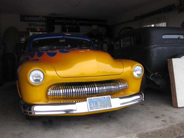

  5. Yup they do on both accounts.
    Jim you are still alive!! Good to see you posting.

    I used the Night Prowlers '52-'54 Merc rings and welded them to my fenders, then skimmed some filler to smooth them out.....worked very well.....
    CB

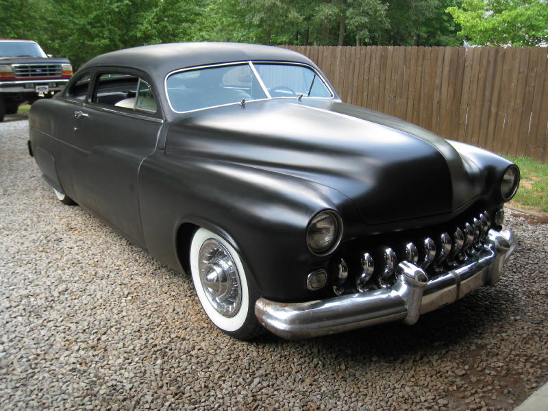

    these are the stock 49-50 rings welded on. doesnt give it the tunneled look though if thats what your after

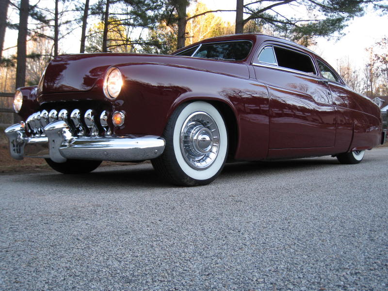

    These are stock 51 rings.

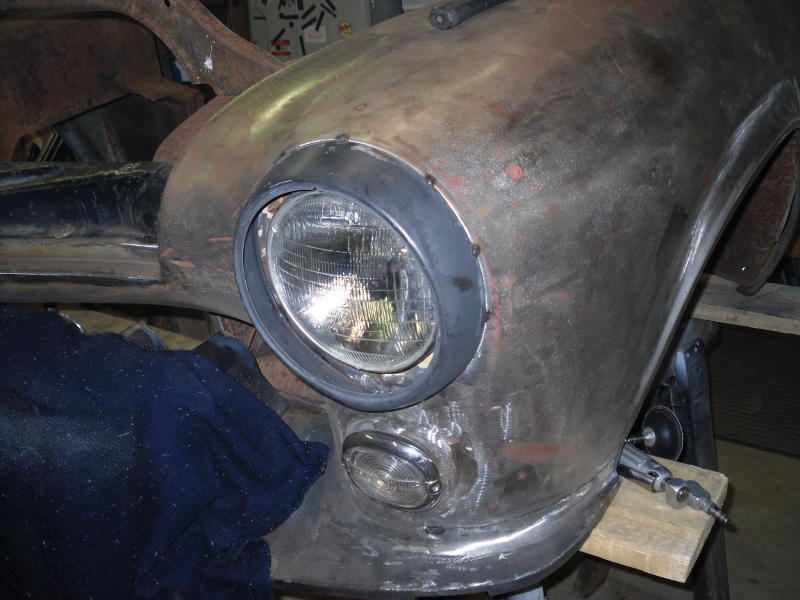

    Here's how I did it, I mounted the headlight bucket from the inside of the fender then welded the stock stainless steel bezel to the fender with a mig using stainless wire then molded it in. I guess it depends on the look you want I myself don't really care for that tunneled look but when you need to replace the headlight you need to do it inside the fender but the outside is a cleaner smoother look & it was cheap & easy. Good luck! Fred
