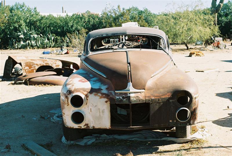

    Piero.... showed me how to post a tech..thing.
    Unscrew the bucket,
    grind the fender,
    flip the clips,
    weld the ring.
    grind the welds,
    lead it,
    file it sand it,
    tack it,
    prime it....
    And thats about it.. Need frenched headlights?? we do it in 1 day depending on how busy the shop is for 1500.00

    instead of welding can you use the new glue that is used on body panels,,,i figure the overflow will act as bonbo and is sandable
  11. do not i repeate do not do this!!!!!! You will get a bond line that will ghost through your paint!!!!!

  14. Brad, are there any drains drilled out at the base of the mounting surface? I can imagine they become a bit of a water trap without...?

    The buckets are simply instaled from inside the wheel well. you should always adjust them first before you disasemble them.

    yes always drill 1/8 drain holes inside the rim to let out water.
