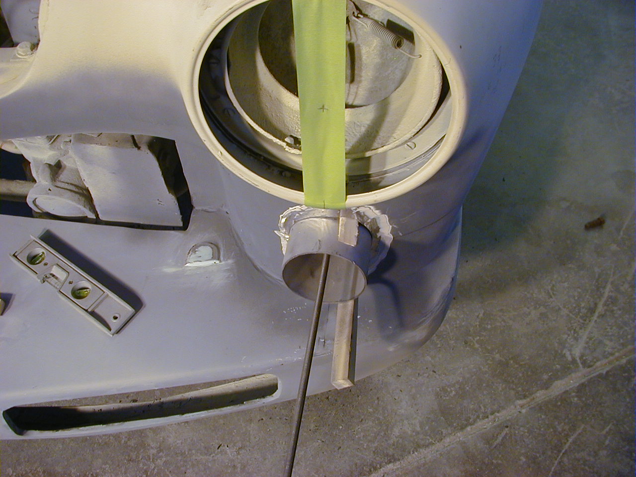

    This is from front turn signals on my sled but same principle applies.
    Use your exhaust pipe, weld flat pc. on 1 end ,drill hole in end , in your case for the antenna.
    Make sure the hole in the fender is tight fit to your exhaust pipe pc. makes it much easier to work with.
    Then I always use a long pc. of threaded rod with a fender washers ( big) on inside of bucket and outside to snug up threaded rod in the bottom of the bucket.
    This helps to get the bucket straight or the way you want it, it's easier to see the angle or lack of on the long rod then it is to see it on only the bucket..
    Leave the bucket stick out of the fender a bit so you have some stock to weld on and then grind flush.
    The green tape on the headlight bucket is just a reference line/point to center this turn signal where we wanted it.

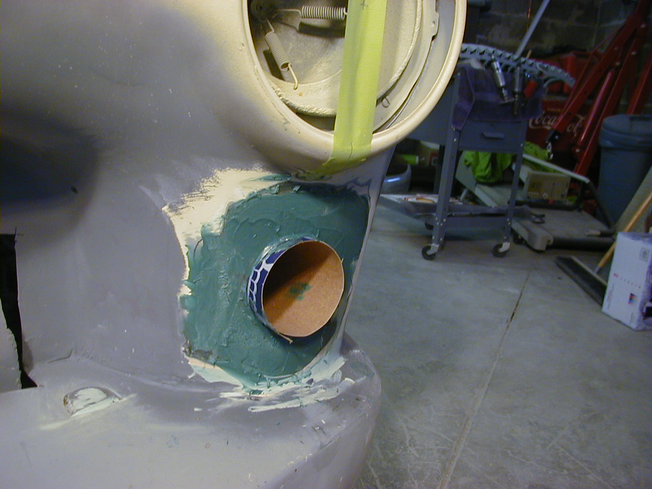

    Another thing I wanted to mention:\When you get to finishing it off.
    I always slide a pc of cardboard ( from a Pabst case in this instance ) on the inside of the hole to do your bondo work ( yes I use filler ) keeps the filler out of the inside which is a son of a gun to sand.
    Cut cardboard, roll it, greeze outside, slide in hole and apply filler.
    Grease keeps filler from sticking to card board easier to remove.
