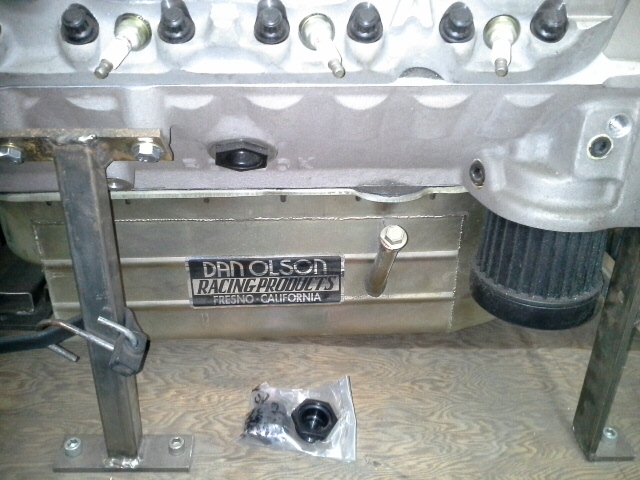

  10. RmK57
    Joined: Dec 31, 2008
    Posts: 1,549
    RmK57
    Yup, both my Cobra-Jet and Boss motors had thread in plugs.
