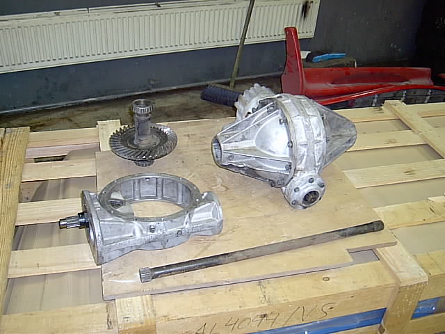

  25. how mush power can these quickchange diffs take ?
  26. Big Block D.I.R.T. Modifieds, Spirtcars and late models all make 600+ H.P. and run Q.C.'s. (Based on the old 3/4 Ton Ford rear)
  27. The Frankland was very common in all kinds of oval track racing for years.
  28. i found sumtin for sale in the netherlands for not too mush cash from a ovaltrack racer
    if it can take the power it might be a nice idea for a fun track vehicle
    i'm in the process of putting a jaguar aj6 24 valve inline 6 engine and the jaguar version of the 4l80e trans in a 1978 chevrolet c10 truck
    the plan over time with some engine work :
    (boring out the block , fit 95mm new liners , new pistons , do a little pocket porting to the head a wipple 1.6 liter compressor and a aftermarket ecu)
    to end up making around 500 hp out of the 4 liter engine
    the truck has a 10 bolt rearend wish at the moment is the weak link
    i have a 14 bolt 3/4 ton rearaxle but thats quite a bit overdue and realy heavy
    im allso stuck with the gear thats in it once i mounted it
    if i use a quick change rearend its a lot faster to change endgears at the track and for the street
    it would save me having to buy a gear vendor overdrive to have the best of two worlds
    i whont use it too mush on the street i have my small car for that but hauling a load or having a good day of fun and relaxation at the track might be a good idea
    should be eazier to make the axle the correct width for wide tires
    i was thinking about changing the floater type axle ends intoo a normal setup using the ford 9 inch bearingends and axles that will fit the diff
    i think the bearings and stock diskbrake/handbrake setup will be more suitable for the street

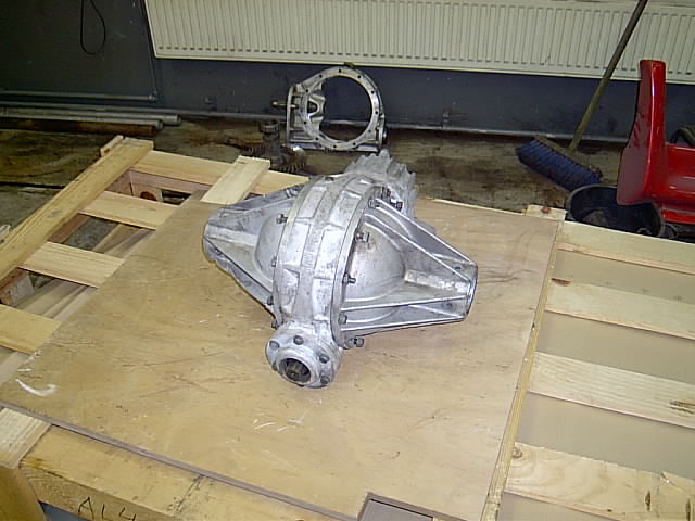

    i have seen the warnings about checking the banjo at the base of the drive
    whell talked to the guy and had some better pictures :
    looks like he hit sumtin with the axle its missing one tube on that side
    the axle is gone as well and theres a big dent in the housing on that side
    now there are replacementparts available for it
    but im not in the states and getting that stuff to europe is pretty pricey
    i guess i let this one go
