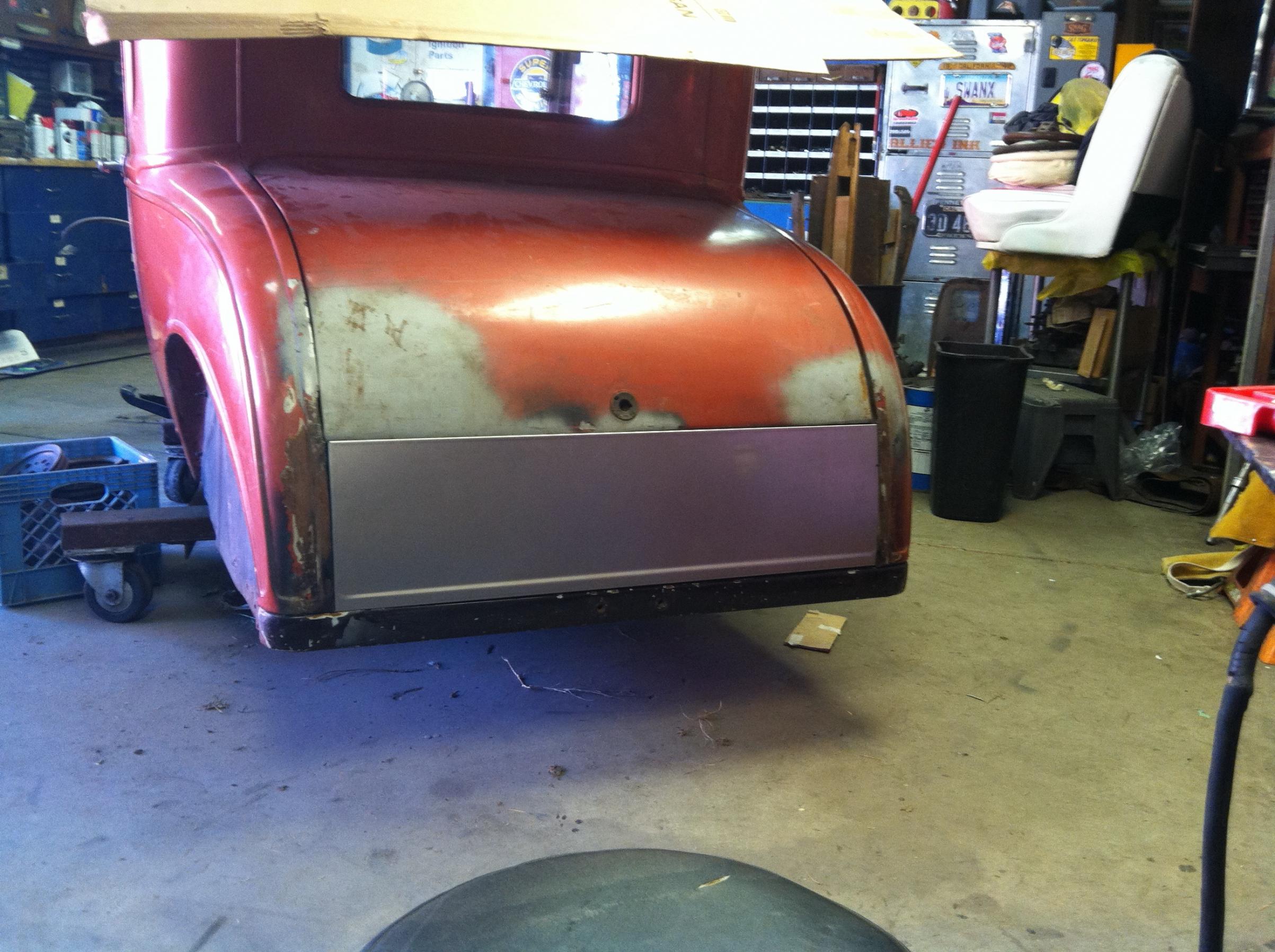

    I have a vague childhood memory of the car being rear ended, or possibly rolling into something just before my brother sold it.
    The previous owner found some rear damage lurking under a sea of bondo.
    If you zoom in on the rear pic from 1970 you can see how everything was just mudded over and painted.
    Next pic is how it looked when I got it, followed by another with the new Brookville panel and a nice used lower rail mocked in place. The quarters and deck lid opening moved around a bit when the car was hit so Ill have to tie the body down and work everything back to square before finalizing the rear panel and deck lid install.
    I was missing one lower door hinge (body side) and had trouble finding an affordable replacement. I ended up throwing together a makeshift jig and adding about an inch to the middle of a spare upper (shorter) hinge. Simple fix, wish I had thought of it earlier!
