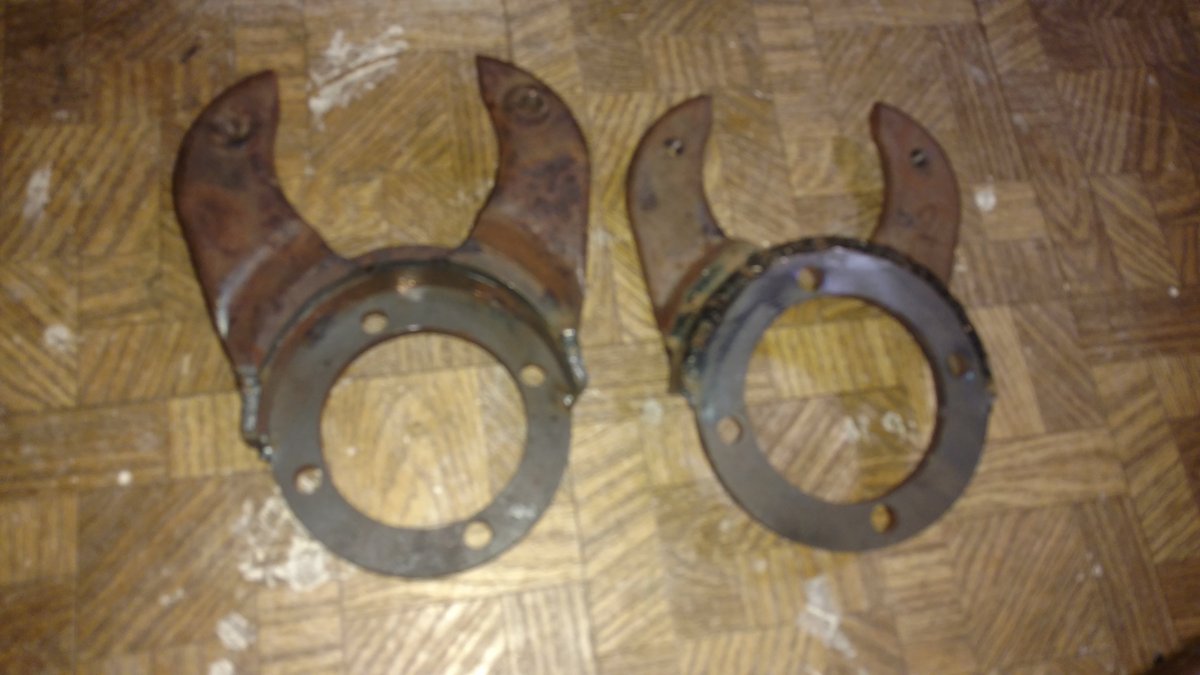

    Here are a couple pics of the prototype IMG_20171217_120640157.jpg IMG_20171217_120700067.jpg

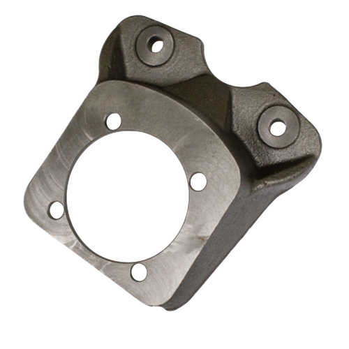

    No, there are sellers of these brackets, that are indeed forged, not formed or stamped.
    These are forged:
    Just somewhere unknown/offshore.
    These are the alternative:
    One type is about as aesthetically pleasing as such a thing can get. The other is the opposite of that.
    Surf City likes this.

    The forged brackets that are pictured are what I am doing similarly but my offset is more.

    I have a set of those brackets, they are in fact cast iron.

    I can tell by the parting line.
    I have installed both forged, and cast ones. They are different in weight, too.
    And then there is the pesky spark-check.
    Or maybe that's fake news.

    The material is 3/8" thick and I only have about 1/2" around the radius between the spindle back and inside the hat of the rotor.

    Here are a couple pics of the welded together brackets. I still have to trim and grind a bit. IMG_20171220_010100647.jpg IMG_20171220_010236121.jpg

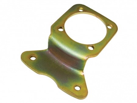

  20. There's a few ways to skin that cat, (the disc conversion offset bracket cat) on the market already. They vary in price from $35.00 to $99.00 and some are per pair some are single. The manufacturing processes they chose could be helpful to you. However they mostly use a $65.00 caliper, except the bottom one, that's for Chevy trucks and uses the $12.00 calipers. Ironically that one is the most expensive at $99.00 each. Also seems the easiest methods to use, plasma cut and press brake bend.
    $35.00 each
    $60.00 pair
    This one is said to be forged at $90.00 each
    $50.00 pair
    $99.00 each
