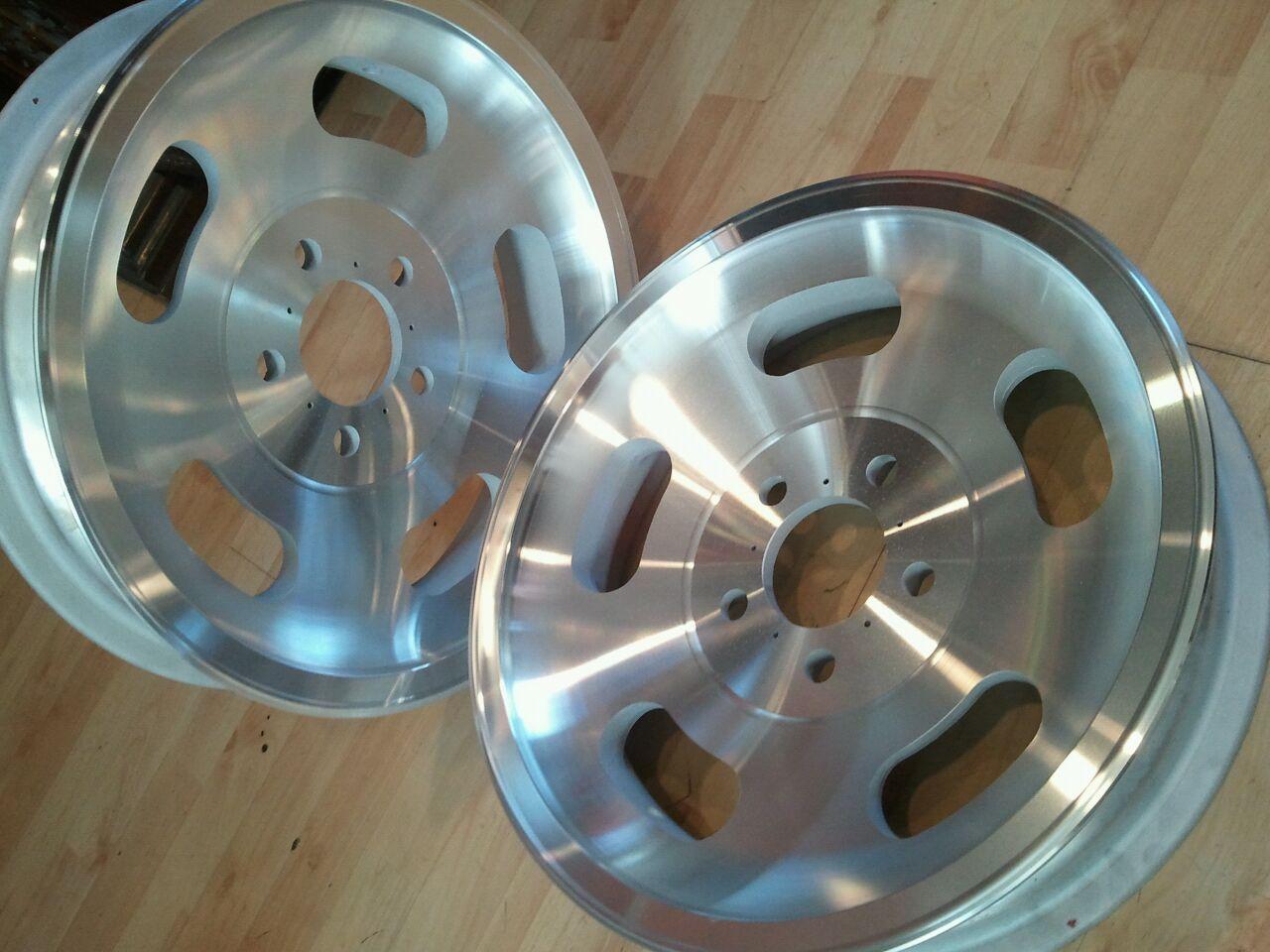

    I was just offered some very narrow aluminum slot wheels that look a lot like Gyro's but on the back is the ford script etched into them. The bolt pattern is 5 on 5.5". I was wondering if these would be off of some ford factory drag car from back in the day or what?

    I wish I had a picture to show, I had dismissed them because I'm wanting a chevy pattern. Just got to thinking about the ford script and they sure look like a purpose built front runner for drag racing. Got to thinking they may be something special.
    Here is some pictures stolen from ebay of some gyro's

  11. I believe they were an optional wheel on late 70's Ford F-100 pickups like this 1977 Ford F-100 Stepside pickup

    They are a factory option wheel for the Ford Freewheeling Package and other higher trim packages from the late 70's thru the early 80's.

    These are 3 1/2" front Fenton gyro's. I guess they are similar...

    The 5 x 5.5" bolt pattern were used on Ford F100's, F150's, they were also used on Bronco's, and mid 1970's, and up Ford vans. The big Ford cars used nothing bigger than 5 x 5"

    No, Ford Econoline (E100 & E150) and the half ton F series pickups had the 5 x 5.5" lug pattern. I own a rare, all original survivor 78' Dark Jade metallic E100 Freewheeling van, short wheelbase with a 351W. It came stock with these wheels on it and a 3 spoke aluminum steering wheel. The factory hot rod of the van craze lol
