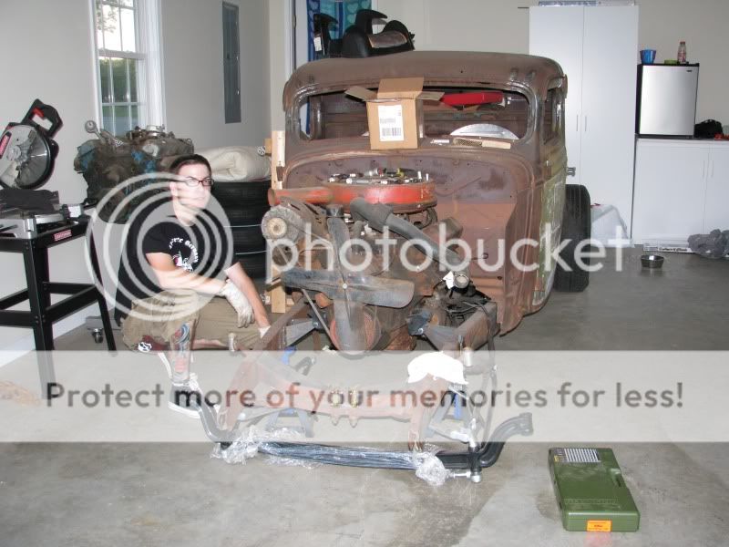

  7. Alright guys, I was doing some work on my truck today:
    I was mounting my rear tires with those spacers to my 9" rear end.
    Trying to get an idea how wide the whole things gonna be. I came up with 55.5" from the inside of the tire to the inside of the other tire.
    Last Refuges 36 pick up bed is 46" wide. So I'll have 4.75" clearance between the bed and the tire. Do you guys think that's to much??
    Here some pics:
    My wife's got me with my camera:
    But she's also helping me ;-)
    Next thing is to ream the front axle and mount spindles brakes and tires...
    So I can check out the actual riding height up front.
    I hope it's not going to be to low ;-)

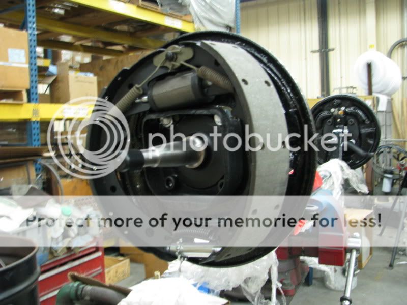

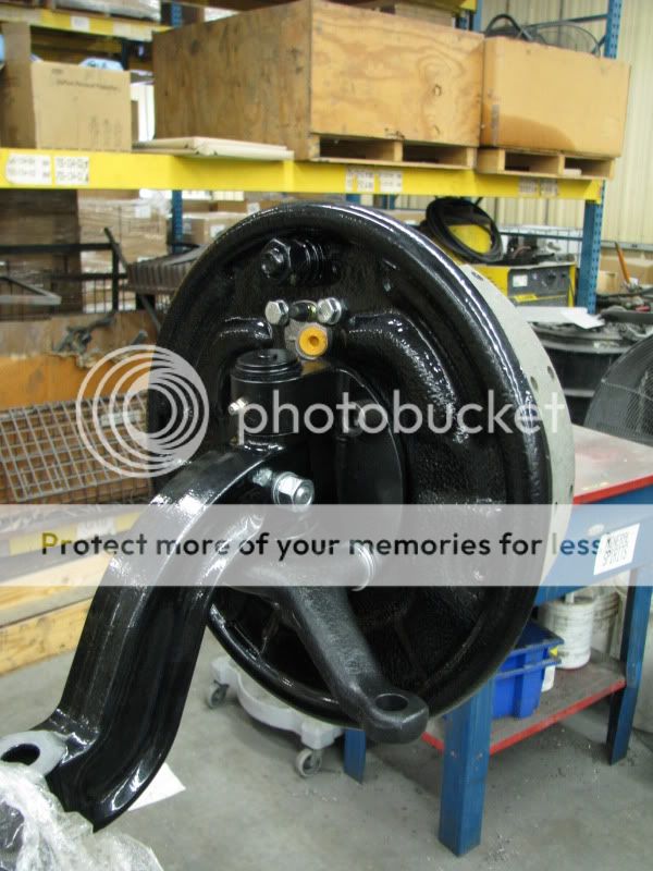

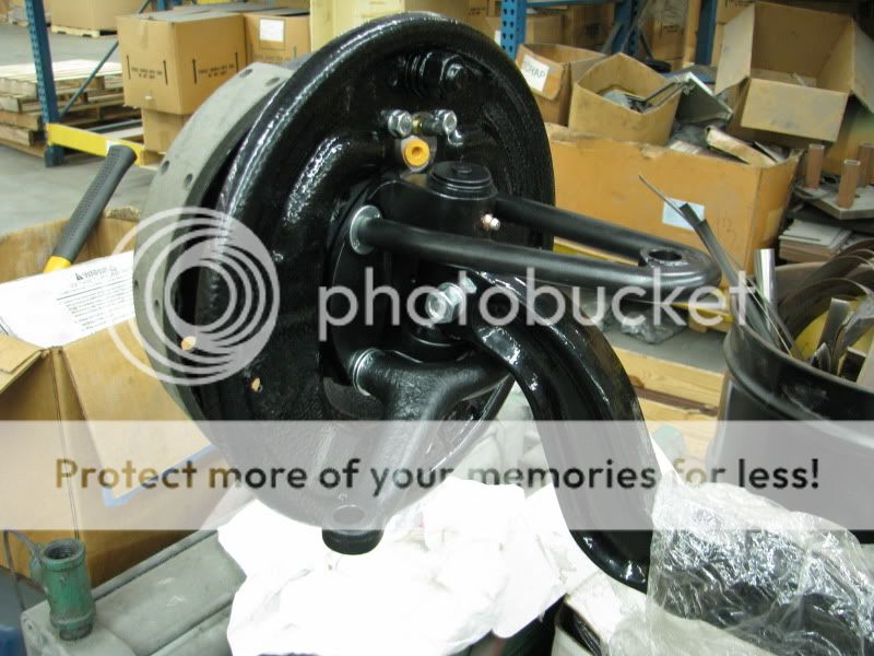

  26. Alright, so here is an update from the last few days:
    Got a lot of parts from Speedway in, so it was really time to do something on the front suspension.
    Already had the axle and the backing plates powdercoated last year.
    So i painted the steering arms and stuff and finally put it together.
    I know you are waiting for the pics, so here thez are:
    Trying to get the hairpins and drag link mounted tonight...
  27. WOW, I haven't known that!!
    Do you have a shot of the other side of the packing plate also??
    Looks like I have to go back to the parts store ;-)
    Thanks Dave
  28. Well, I tried to get a whole hardware kit, but they didn't have one for my brakes.
    So I had to get the parts seperately.
    But looks like we missed those stuff. I'll check back and ask for them.
    Is it 2 pins, 2 sprigs and 2 caps each side??
    If so, why do they show 8 pins in this picture??
    Do I need 8 of them??
    Thanks
  29. Alright, my guy at the auto store is on vaacation this week, so I'll go there next week to get all this stuff.
    Is there a rule that says, you have to put your tie rod on top of your steering arm, or can I also put it under it?? Would just be better to clear the hair pins...
