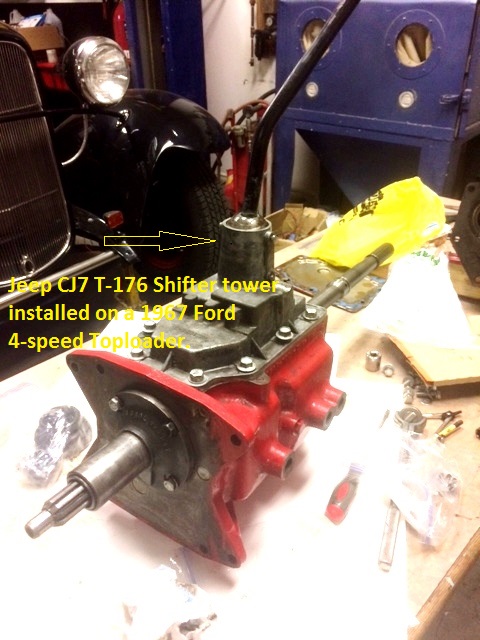

    I installed a Jeep T-176 top shifter housing on a '66 Mustang toploader. Pretty straight forward install. You have to grind the case to allow the reverse fork to fit so you have to pull the trans apart so as not to get grindings inside the trans.. I used freeze plugs to block off the holes where the shifter shafts came through the case. I had the article but I think it was on my other lap top that died. I think I used Mr. Google to find it. IMG_3248.JPG IMG_3249.JPG IMG_3250.JPG IMG_3251.JPG IMG_3252.JPG IMG_3253.JPG Attached are some photos of the finished install. Sorry no photos of the actual change over.

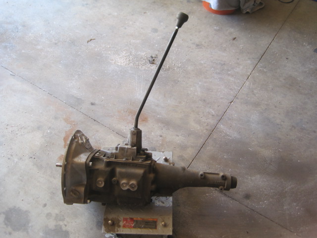

    IMG_1461.JPG 31 pickemup! I am currently converting a three speed toploader to torque tube and machining up a 5/8 adapter plate. You need to still respline the shaft and cut it down. There is a company in New Zealand that sells these adapters also, named Macs, they sell on evil bay

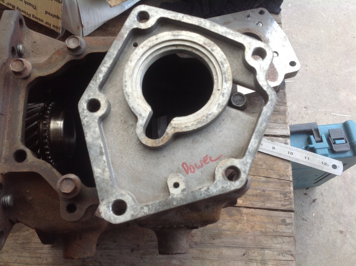

    Machine off the extension housing to support the bearing and allow oil drain back ,,I incorporated a seal in the adaptor

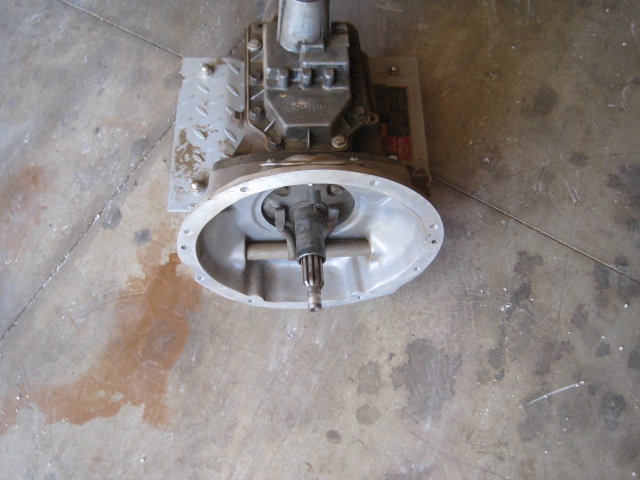

    Forgot this one ,,,the shaft shortened,splined and drilled ,,some shafts reduce in size here ,,mine was from a stumpy pickup trans and was thick enough to get all splined ,,

    Yes Johnny, the cut off housing is essential for bearing support ,,the adaptor plate I thought might take a bit of a pounding and I wanted the raised ring to help support the clam shell and the oil seal ,,would probably be ok thinner ,had to shorten the drive shaft and tube 48 mm anyway ,with my new engine (Mercruiser 3.0) I have moved everything forward and will use a standard length drive shaft and tube ,,drove it with the A motor works great ,
