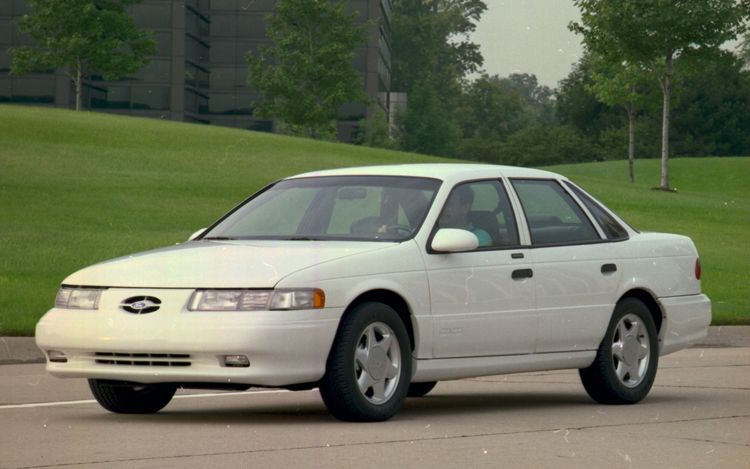

  18. cool post, thanks
    what generation of Taurus' (Tauri?) is this from?
  19. sorry guys, I just re-read the origional post and my bad...answer is first gen.
  20. Another case in point--there is a cheap junkyard solution to nearly every automotive challenge. No matter what problem you're trying to solve, some engineer has already solved essentially the same problem on a regular production car. The problem on the Taurus was how to pull enough air through a very small grille opening to keep it from running hot.
