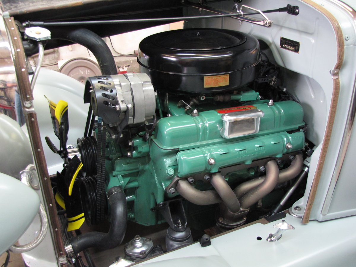

    30 Coupe set up to run a full stock hood. Firewall reversed and recessed for clearance.

    Hey Canuck, this is one of the nicest firewall mods for a nailhead that I have seen! How did you do it, shape it etc., ? Any more pics of the modification?Engine compartment looks great ! Thanks for any info.

    Like he said above that’s a really nice installation but why is the engine so far back? There seems to be a lot of room between the fan and the radiator AND it has a fan spacer?

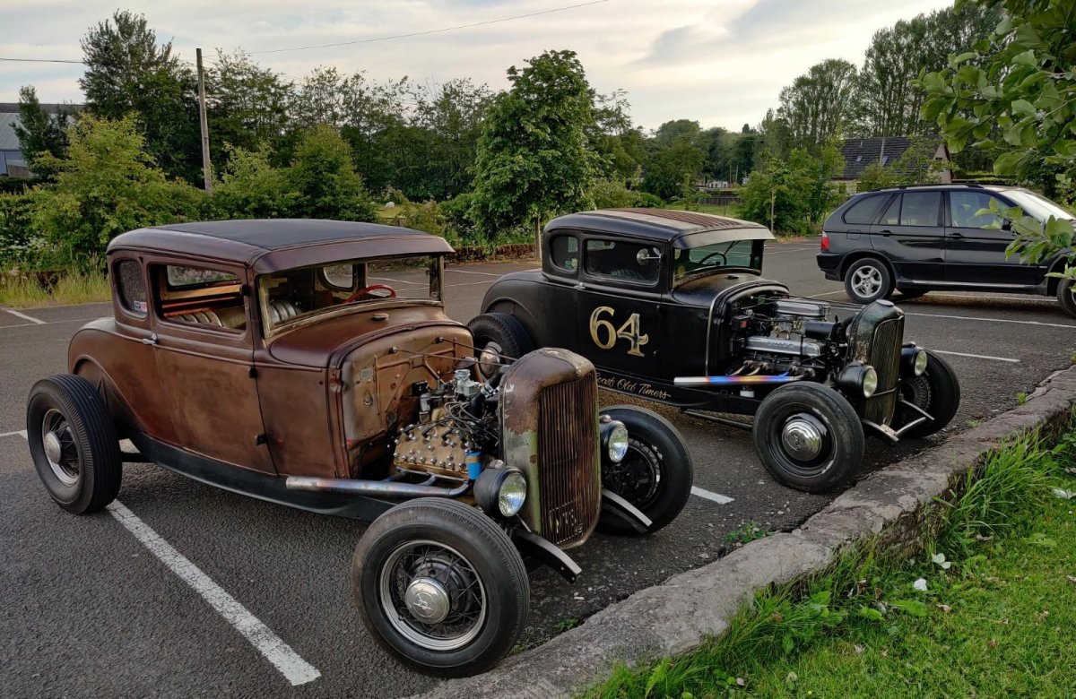

    me and my buddy, his being the nailhead powered hot rod on the right .. as if thats not obvious :)

    PS clearance issue is easy to solve, build it on a 32 chassis :)

    Spaced to allow installation of a fan shroud. In hindsight, it could have been a bit further forward.

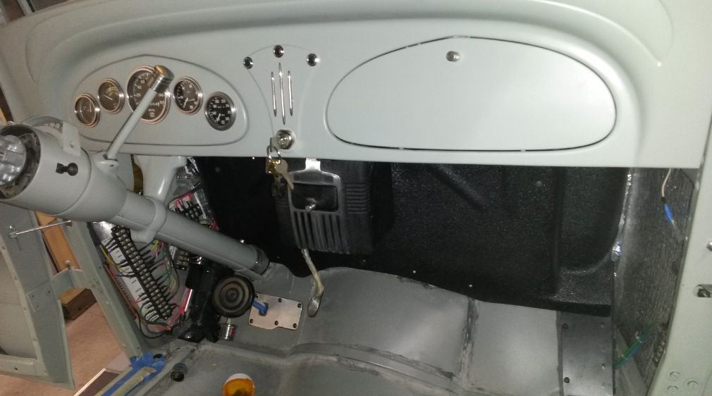

    Firewall was reversed the cut out to clear engine. A spacer was made to move the insert back and still keep all the ribs lining up. The edges of the spacer were hammer formed along the front and rear edges to give a smooth round edge with about a 1" radius. The toe kick was custom formed and the legs going down to the body mounts. Just lots of time. On the inside a fiberglass piece was taken off the shape and spaced out about 3/4" to allow room for insulation. This was then sprayed with Raptor in case any of my klutzy friends used it as a foot rest. upload_2020-7-3_23-12-6.png
    Engine was offset about 1/2" to passenger side to clear steering box. Headers just clear on passenger side. If engine was any further forward, would have had to dimple the hood to clear headers.
