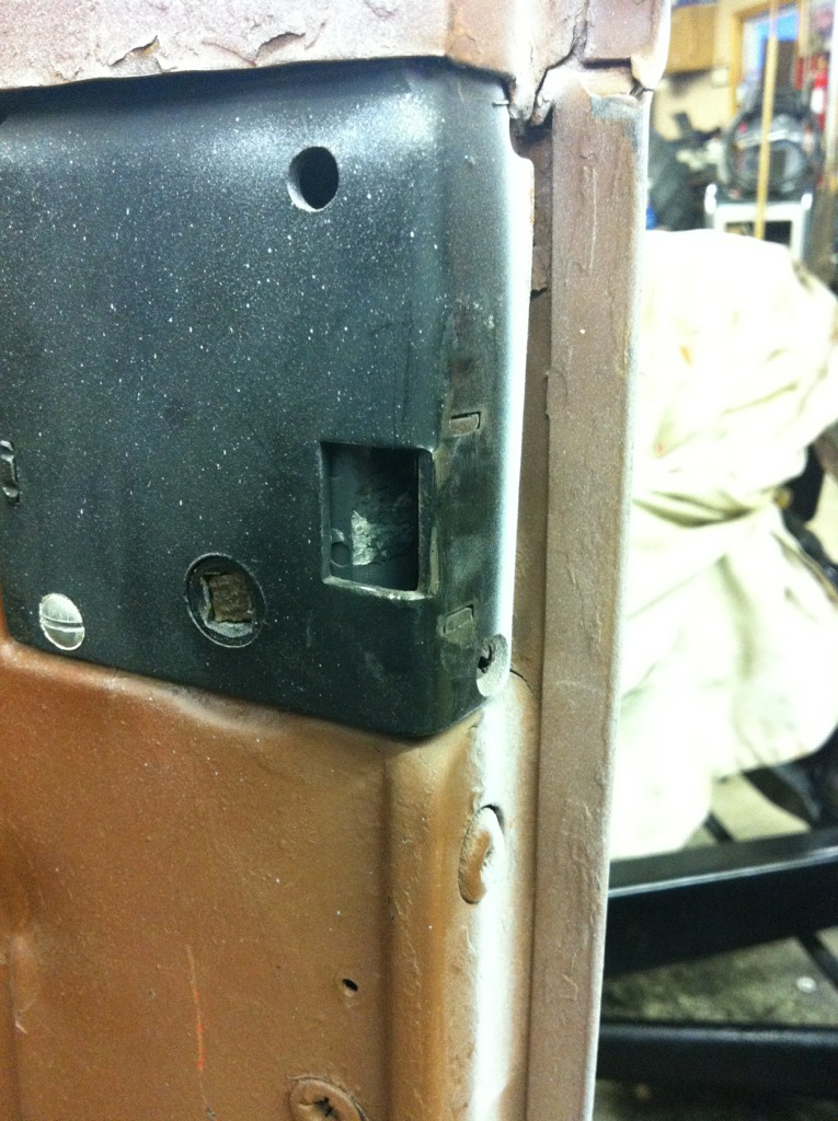

  1. You didn't have to remove any part of the piece of metal between the 2 tabs? (I ground them down to even get the striker to fit right) I'm probably just over thinking this, I'll see about giving it a go when I get home from school tonight

  4. Nope, i got an old original latch for my drivers side (the one with the striker half over the quarter panel..) and literally bolted it to my door, threw some wd40 in it to make it work, put the striker on and fucked around with that until it bolted in place.. and that was it lol.
    I do nice fabrication work and all, but if something is beyond normal amounts of finicky i am the most laziest dude there is and just won't bother lol.
    I learnt a long time ago when i was an apprentice.. work smarter, not harder ;)
