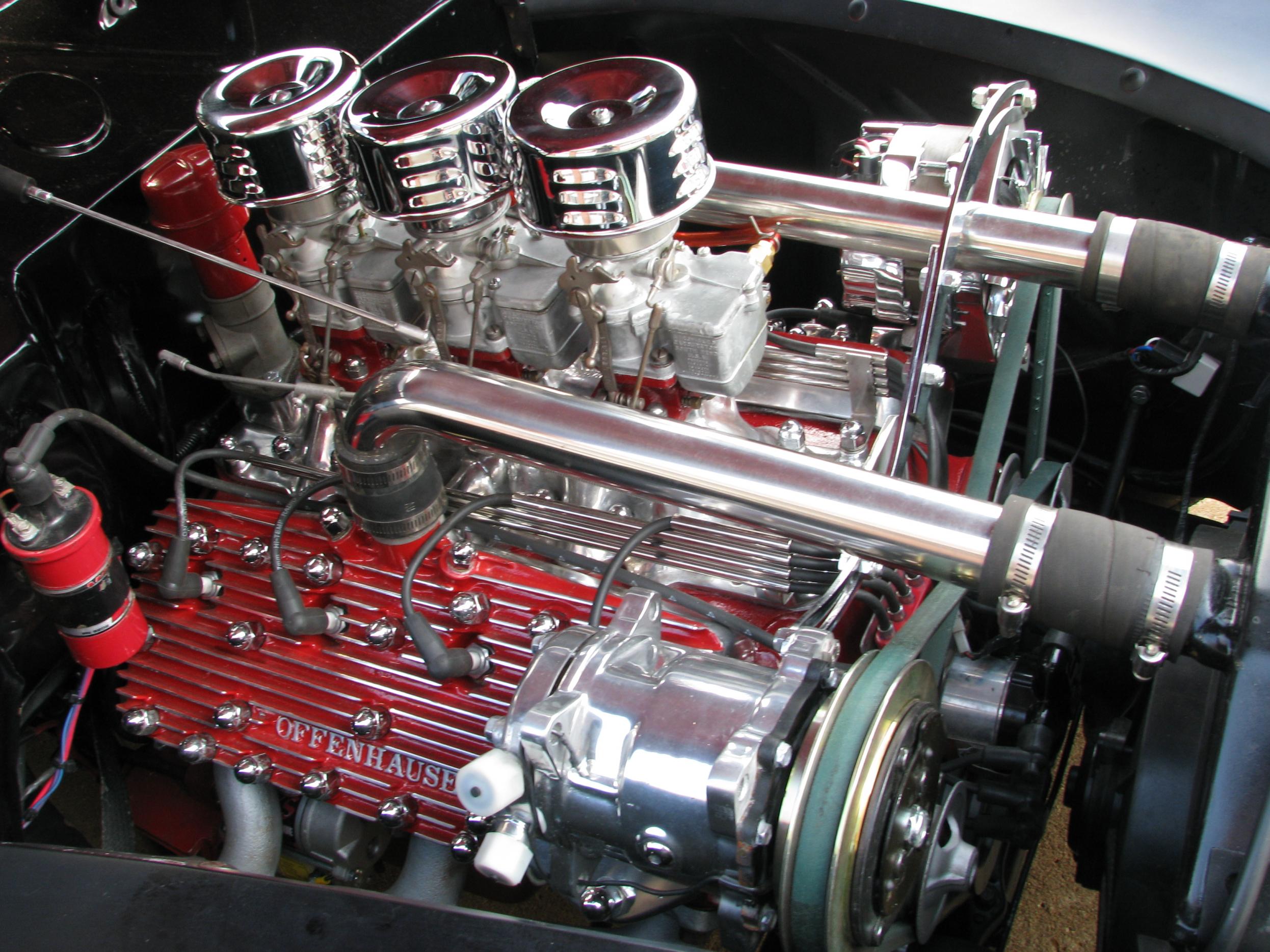

  25. tjtcr4
    Joined: Jun 18, 2009
    Posts: 8
    tjtcr4
    I run speedway water pumps and pressed truck double pulleys on them.
    Check them out.
  26. luis.garza
    Joined: Mar 17, 2009
    Posts: 67
    luis.garza
    That looks like an awesome setup! :D
