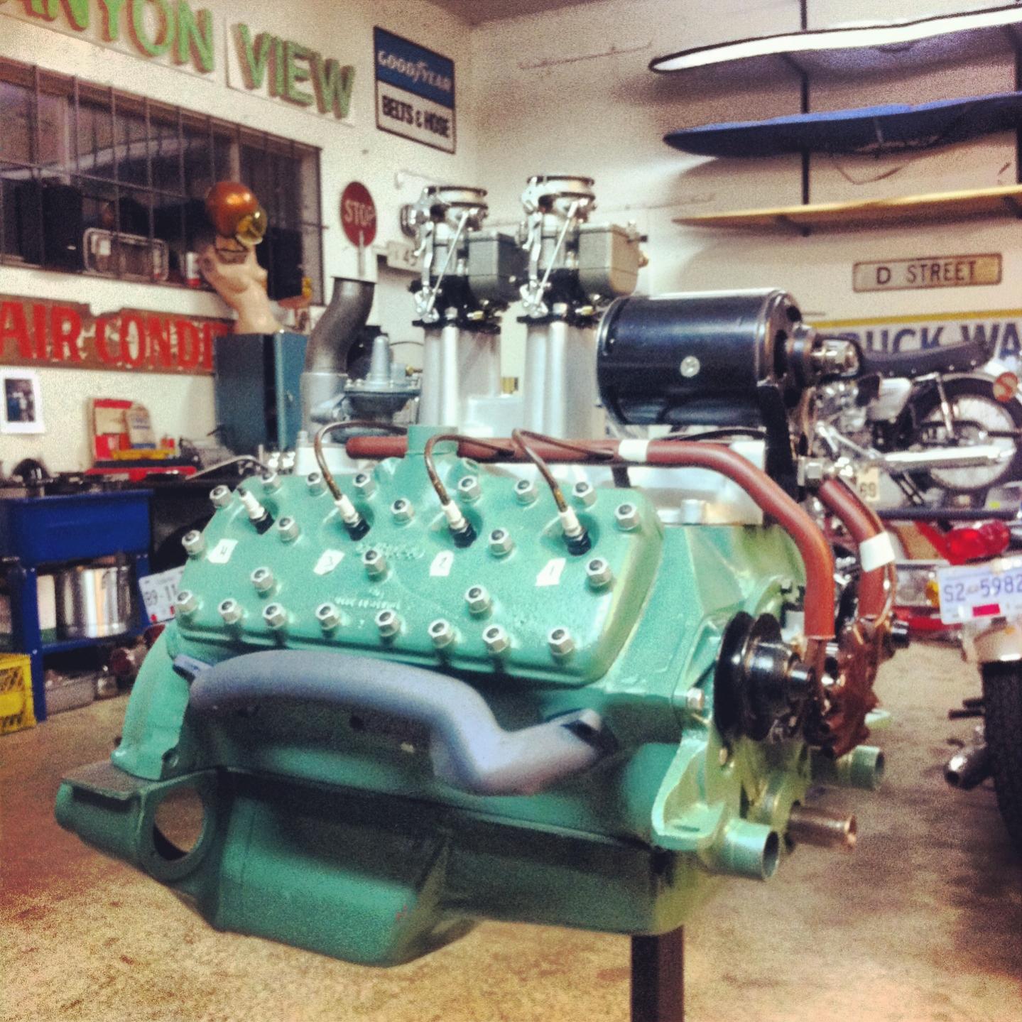

  27. Although my engine has not been run yet I opted for the Autolite 216 after much reading. A big plus to the autolites' is the black metal body and electrode tip which gives the plug a sort of vintage look.
