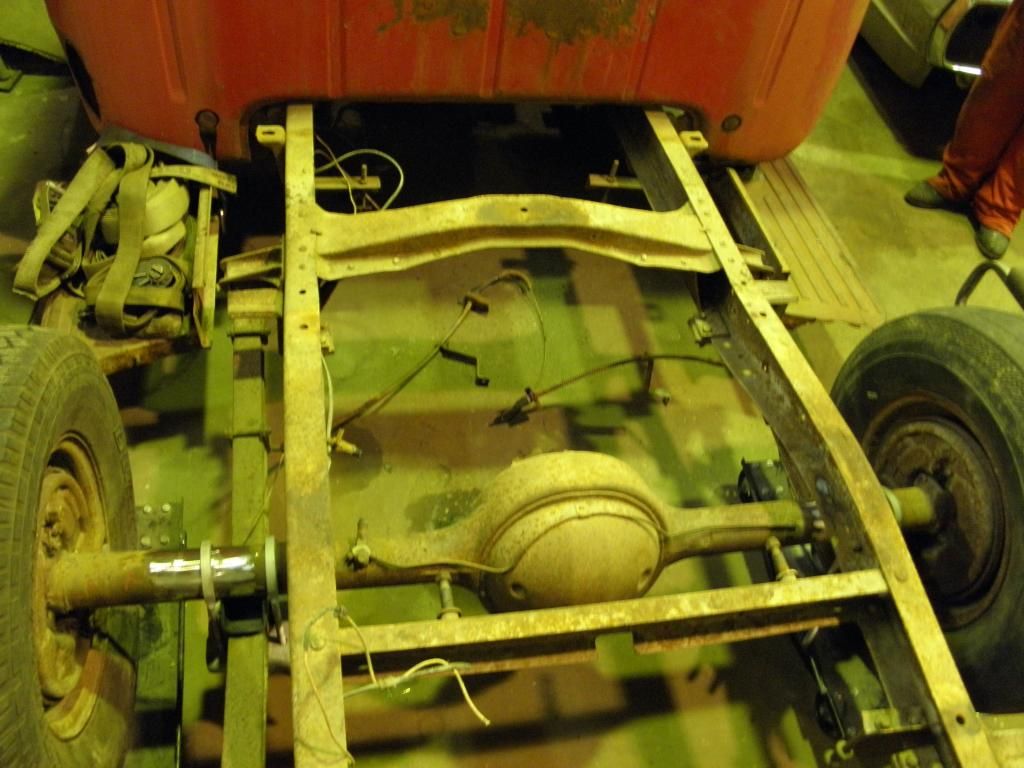

    Early rearend (dont' mind that it's not squared up, it's just sitting in there loose right now)

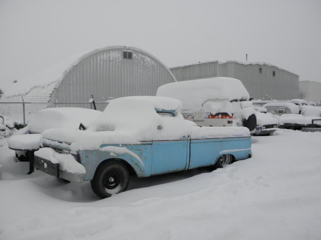

    Parts truck with that later 9", after the snow storm from Monday....

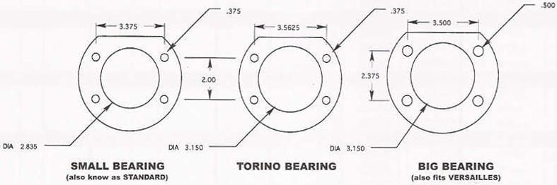

    There are 3 different bolt patterns for the backing plates and several diameters of drums.

    As for swapping the entire rearend, the 73-79 is way to wide for the 53 box. The rearend in the 53 now, fits the fenders great, and it has a 3.50 ratio. I'm happy with that.
    It started snowing some more, couple inches so far. On Monday morning it was warm and dry. No snow at all. Winter sucks.
