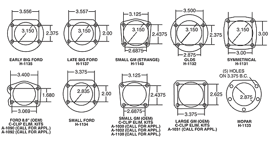

    Should I cut them off and weld new ones on? I am looking to do a 5 lug conversion, but I will be going back to drums. It is going under my T.

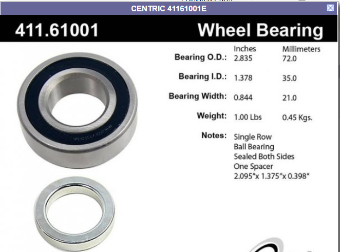

    I cannot rightly remember what the diameter of the inside of the bearing on these is. I will try to look it up. If you still have the shafts that you pulled out, put a set of measuring calipers on the machined portion of the shaft, right next to the bearing.
    Yukon Axle and Gear, Currie, and Speedway all make cut-to-fit (cutoff wheel, on an angle grinder) axles, in 28 and 31 spline, with the 5-on-4-1/2" pattern. Those might save you some effort.

    I will have to double check these are the correct ones, but they appear to be the same OD as small Ford, just with a different retainer, and backing plate pattern.

    There is a great big hole in the flange that disallows re-drilling.
    1971-1972 Maverick 6-cylinders were 4-lug. V8's had 5.

    It indeed does appear that you can use same length 8"/9" 28-spline already 5-lug shafts in these, with your existing bearing retainers and backing plates. The drums would be a separate issue.
    9" Ranger drums might work, with minor backing plate or drum trimming. They are designed for shoes that are 1/4" wider. Already 5-lug, and with the common sized center hole of 2.54".
    You can always weld up the retaining bolt holes in donor backing plates, and re-drill those, too. The backing plate is centered on the bearing. That makes lining them up easy. Drill a hole, and put a bolt in, repeat until you have all four.
