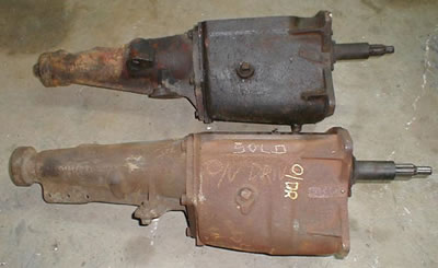

  3. Probably a Toploader OD, basically a 4-speed with 3rd gear converted to OD. Here's a pic...
    The OD is the lower one, note the 'bulge' in the main case which is clearance the larger '3rd' gear. There's also an aluminum-case version with integral shifter (like a T5) known as the SROD but it's a POS, avoid it.
    The cast-iron ones are decent trans, and the factory linkage can be reworked for better operation. The downside is ratios; many have really low 1st gear, with a big jump to 2nd. The car versions are better.
    If you have a two-piece driveshaft, it'll have to go, and you'll probably have to shorten the pilot bearing shaft on the input to fit your FE. Ask if he has the driveshaft for it, it may fit your truck.
