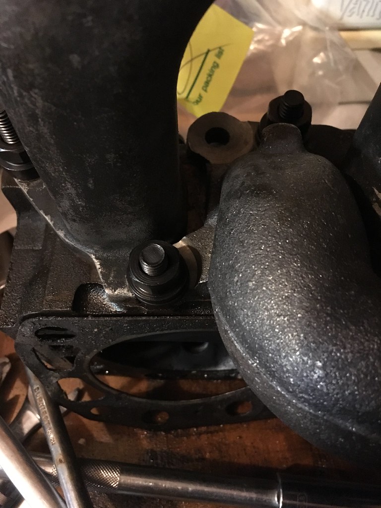

    It seems that Offys, Stock Logs and EFIs Sometimes Crack and break at the flanges. Why? Secondly EFI manifolds have some extra mounting holes. EFI heads had reinforced bosses so these extra bolts help align this multiple piece design. Carb heads do not have this. The stock intake and exhaust log is one piece. Using EFI manifolds means this one piece assembly is now a three piece. It's four pieces if you count the gasket! Three pieces that may not fit together along with a gasket. Studs are a must have. There is no way you can juggle these three pieces and a gasket using bolts. Being in chassis makes this so much more difficult. I may have to pull this engine after all and do all this on a stand.:oops:
    Above I asked why the tabs break off of these on occasion. The photo below shows a Ford factory manifold bolt and my solution.
    [​IMG]Untitled by Travis Brown, on Flickr
    I should have picked a better stock bolt for this photo.:rolleyes:
    Anyway..... The factory bolt uses two special washers with a radius on each. A thin one and a thick one. Simply put this radius in the special washers allows two slightly uneven surfaces like the intake and exhaust pieces to clamp together. A standard flat washer may break off one tab when torqued.
    Since I'm using studs I decided to use special nuts and washers. The nut has a convex base. The washer has a convex top this should allow even clamping within a .027 correction.
    This is proving to be a really big pain in the ass. It's solvable...it's all part of working on a"hot rod" but it's still a pain.

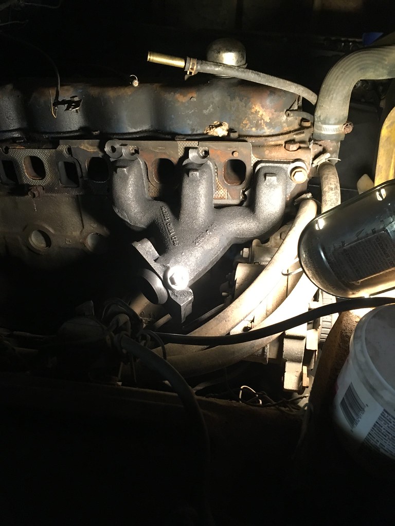

    I'm going to dry fit this stuff. I already know I'll have to modify the alternator bracket for clearance and likely some spots on the exhausts.

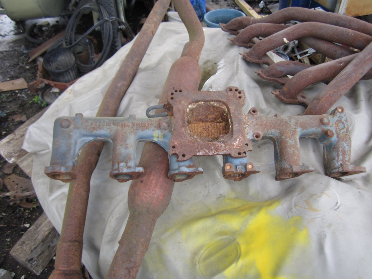

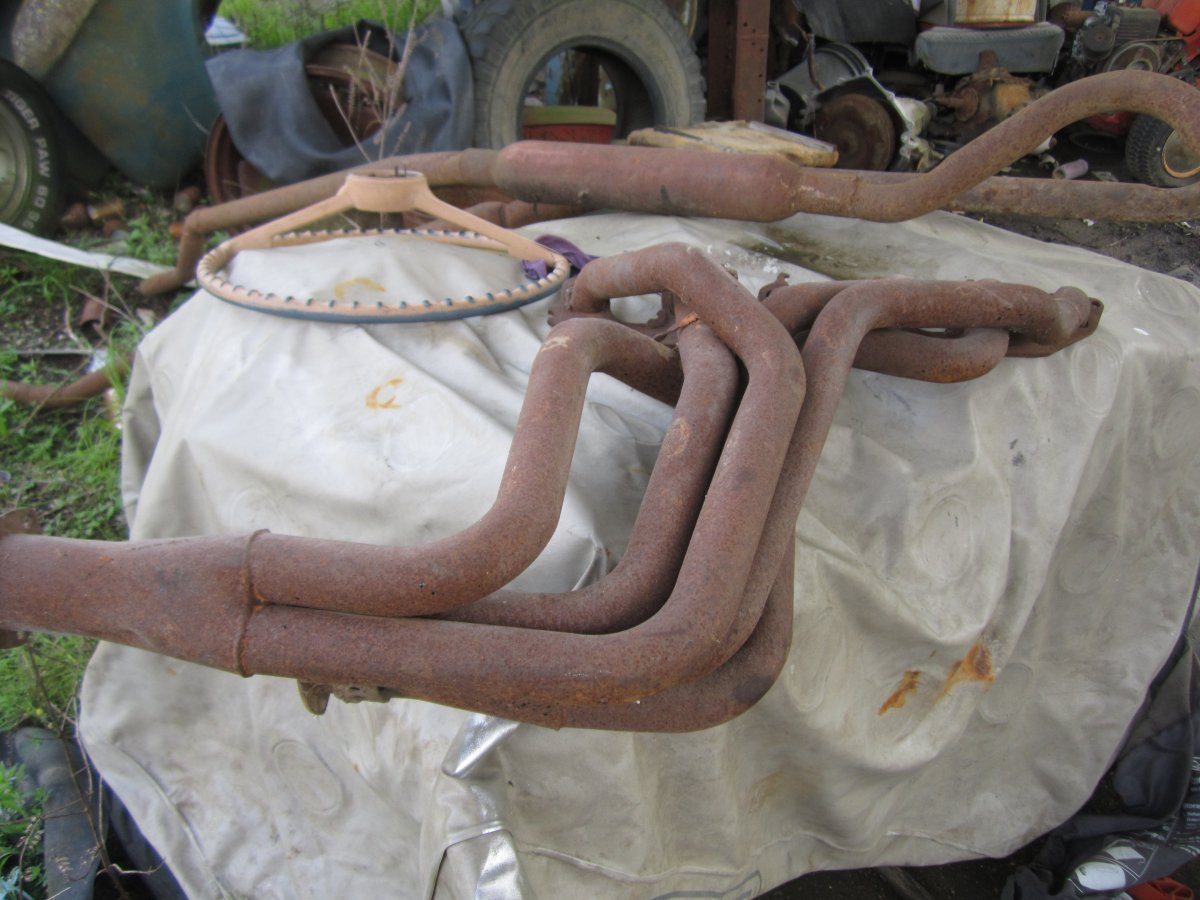

    1. MASSACHUSETTS HAMB
    Too bad you're not closer because I have a set of headers in my shed.

    I pulled the head and started fitting parts. There is no way I could have done this in chassis leaning over the fender trying to align all this up.
    You can see here the exhaust is in contact with the intake. I'm going to grind the exhaust for clearance.
    It will fit. It's one of those deals you have to adjust back and forth...shake it.....hold your mouth right.
    One thing that does concern me, is the manifolds are held by clamping pressure only. Due to design if the nuts (with studs) or bolts are loose, it can fall off. The intake is retained by a dowel and a bolt hole. I found it essential to mount the intake first, then work the exhausts in there.
    I may use some larger washers to spread the clamping force to get a more secure grip on this assembly. The Frenchtown Flyer recommends some Special washers or angled shims that hold the bottom of the manifolds. I dont know if this is really necessary since I'm doing this on the bench. I can see how that would be essential if working in chassis. I also think it would help support these manifolds when pipes are added.
    My studs and special nuts and washers were not essential. I could have done this with the Ford bolts since I chose to do this on the bench. Working off the side of the engine against gravity....they may be of some benefit there.
    I've some grinding and more fitting to do to get this perfected. Well, at least to my satisfaction.
