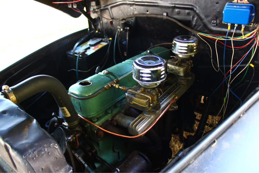

    Ok! Thank you...yeah, Ive seen both clifford and patriot headers..almost the same price...also fenton intake and headers, but I think those are super rare...I really like the look of the dual holley setup, more than the clifford setup...what kind of headers are you running? Do you have a picture of your engine?

    I have an Offy, the main problem is getting the linkage set up and the carbs synced, mine isn't done as I currently live 2,000 miles away from the truck and only get to mess with it on vacations. No idea what headers I have, I think they are cliffords, they dump about at the oil pan, scored them at a swap meet.

    like the look with two carbs! the easiest would probably be clifford setup..but this looks better! I live in norway, so the shipping costs are pretty high..thats why I want to be absolutly sure before I order anything :) thanks
