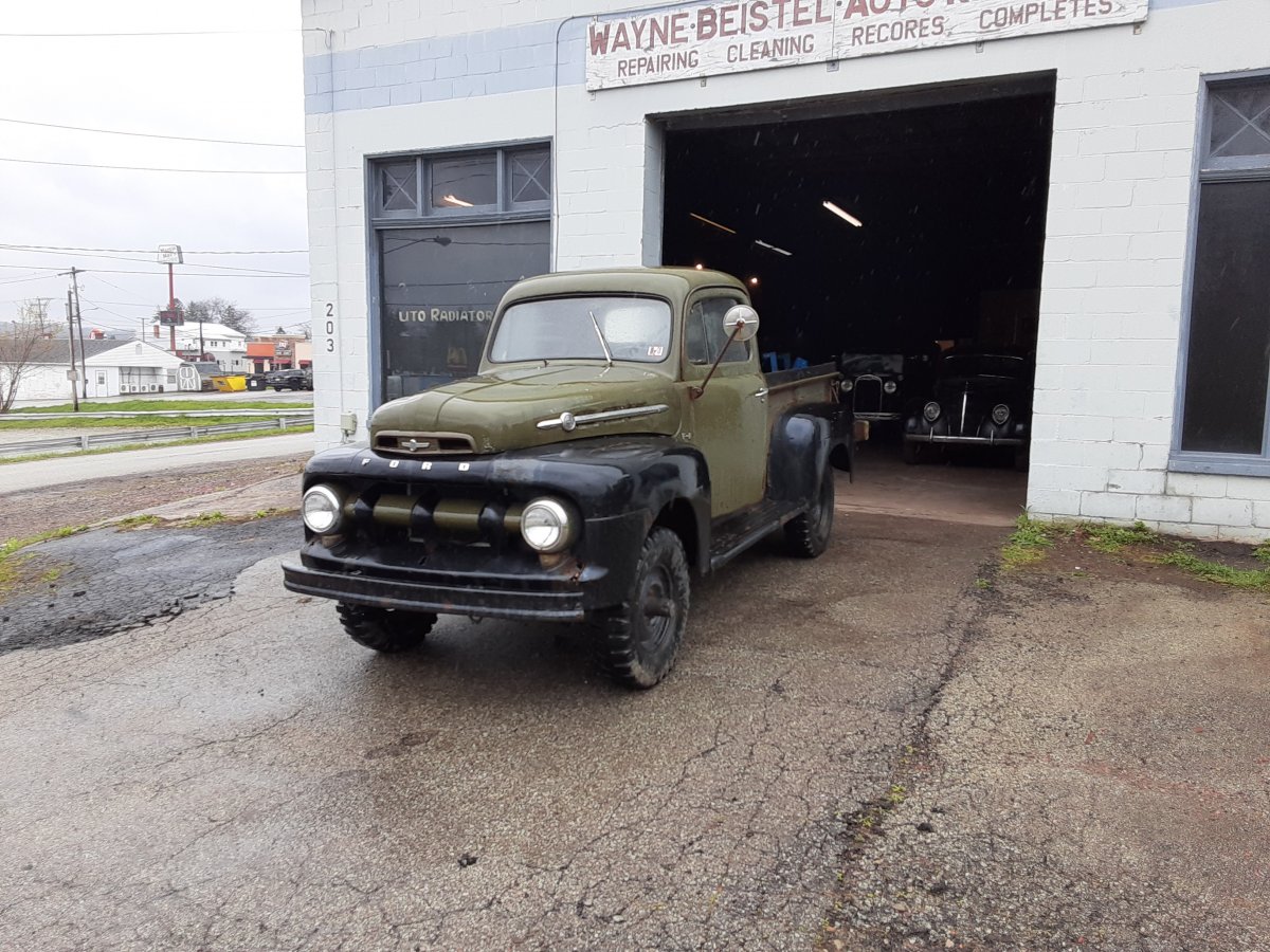

  23. fordf1trucknut
    Joined: Feb 13, 2007
    Posts: 1,111
    fordf1trucknut
    I swapped it in when I did the 4x4 conversion
    Also note that ford used like 3 diferent bellhousings on this engine!!!!! I found that out the hard way!!

  25. fordf1trucknut
    Posts: 1,111
    fordf1trucknut
    Yes I used a bronco tranny and t-case. I modified an early bronco Dana 44 housing for the front as well.....using diferent outers.
    The carb is a stock Holley from the 70s.... I vaigly remember messing with the advance some in the duraspark distributorwhen I built up the motor... and not using the vacume advance.
