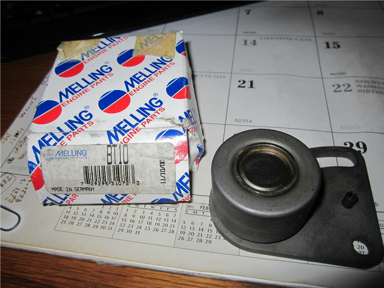

    Now off to find a new tensioner. Figure might as well change it while there. Motor has 95K on it. Looks like BAT may be the only ones with one although I did see a post somewhere mentioning a Melling BT10. Jegs lists it but with no photo and no description mentioning Pinto.

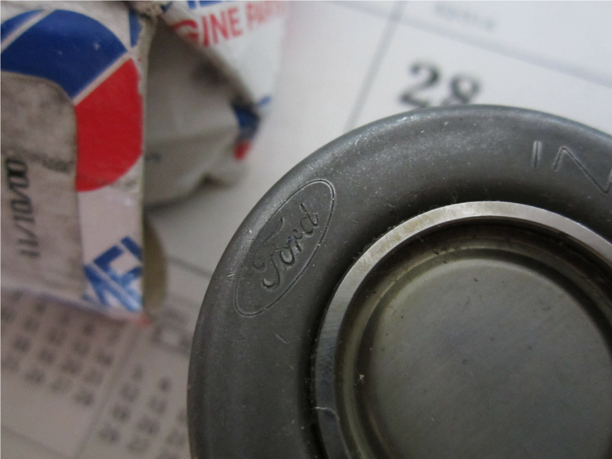

    Here's the short list of what I've found (might be a repost so sorry if it is).
    **Timing belt tensioner - Melling BT10
    **Cam, Aux shaft, Front Crank seal (all the same) - D1FZ-8592-A, National Seal #473560N
    **Thermostat housing - D3FZ-8592-A
    **Rear Crank Seal - D1FZ-6701-A
    **Tune up kit - TKF-24
    and for the Melling BT10:

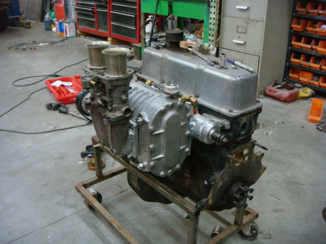

    I went from this:
    To this:
    And now I'm building this:
    I'll post more about it on the Dogfight Forum when I've got it finished, swapped over, and running.

    The second shot with the turbo, is that an AK Miller set-up.
  23. metalshapes
    Joined: Nov 18, 2002
    Posts: 10,760
    metalshapes
    Tech Editor
    Yes.
    1st one was a mildly ported head, hotter cam, and twin 40 DCOE's.
    Ran nice but not fast enough
    Second is with the Ak Miller turbo setup, which is modified from stock.
    Crazy horsepower and acceleration, but way up in the powerband, no torque at all down low.
    Not suitable for the vehicle it is in.
    So now its getting the Roots Blower to hopefully cure that.
    I'll put the Ak Miller parts on a different engine that will go in a road track racecar that can handle that kind of power delivery.

    The roots blower looks CRAZY. I passed up on 2 AK Miller kits (1 was missing parts other the turbo was seized) at the early stages of learning about the 2.0's, now I'm sad and can't find another. I was wondering what manners it would have on the street in a model A, sounds like torque is a problem. I have 2 motors now so 1 will wait for the turbo set-up and the running one will get a torque cam, shave the head, long headers and the edelbrock 2x1.......I'll see how that goes.

    The Roots is a cool project that I really enjoy doing.
    I only had the blower itself.
    So I had to make the blower drive, the intake manifold that goes between the head and the blower, the pop off valve, and the manifold that goes between the blower and the downdraft 44mm Dellorto carb.
