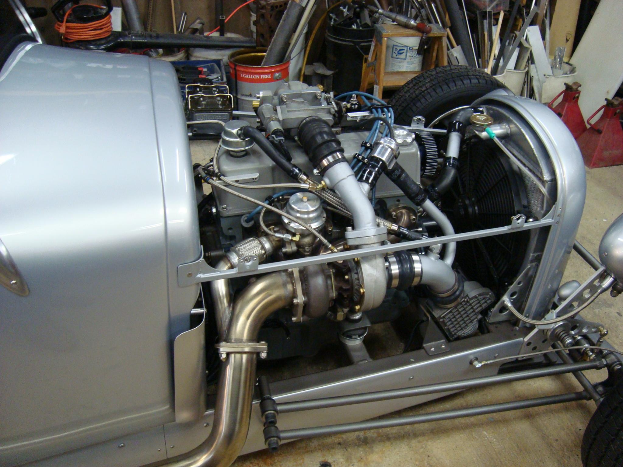

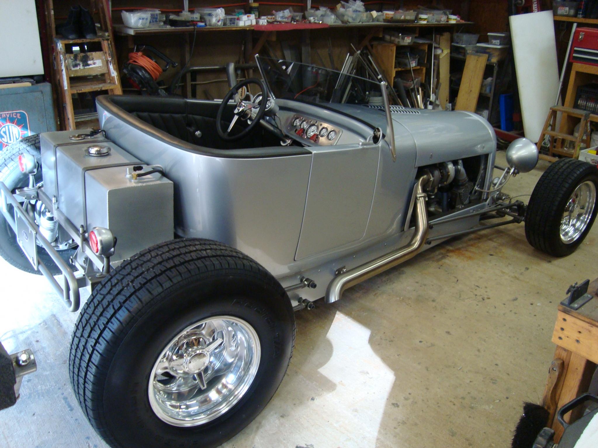

  7. Here's a 2100# car(2.3/T3/T5) that scoots @8psi...2nd & 3rd gear is a real hoot...
  8. Kenneth S
    Joined: Dec 15, 2007
    Posts: 1,527
    Kenneth S
    Looks like a neat, fun ride you have there.

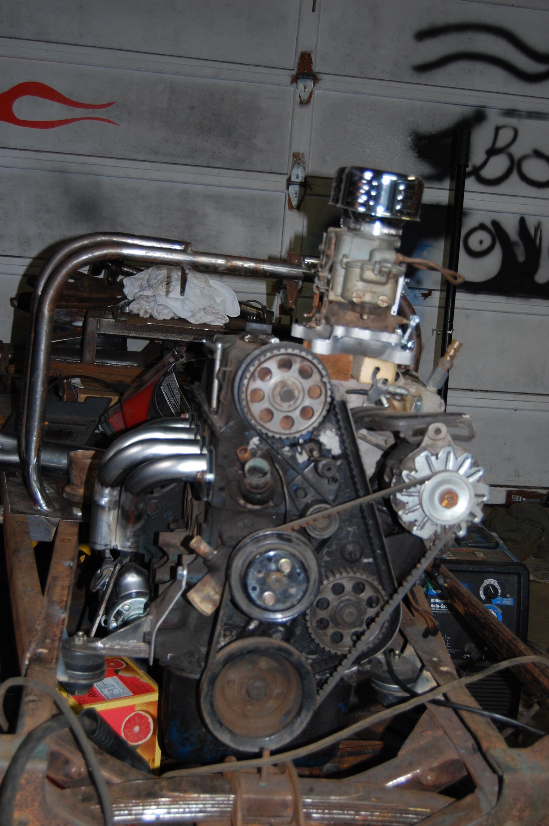

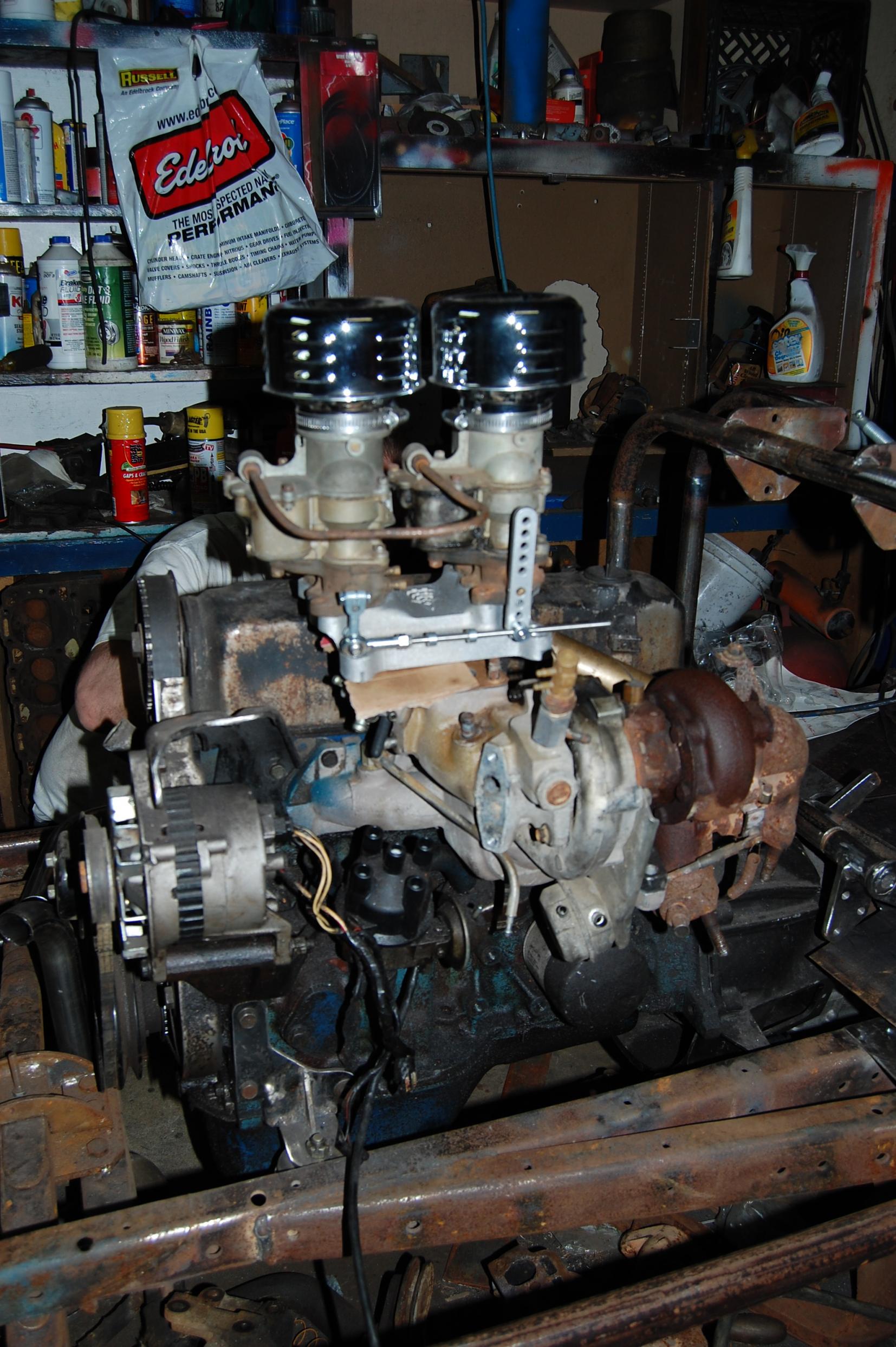

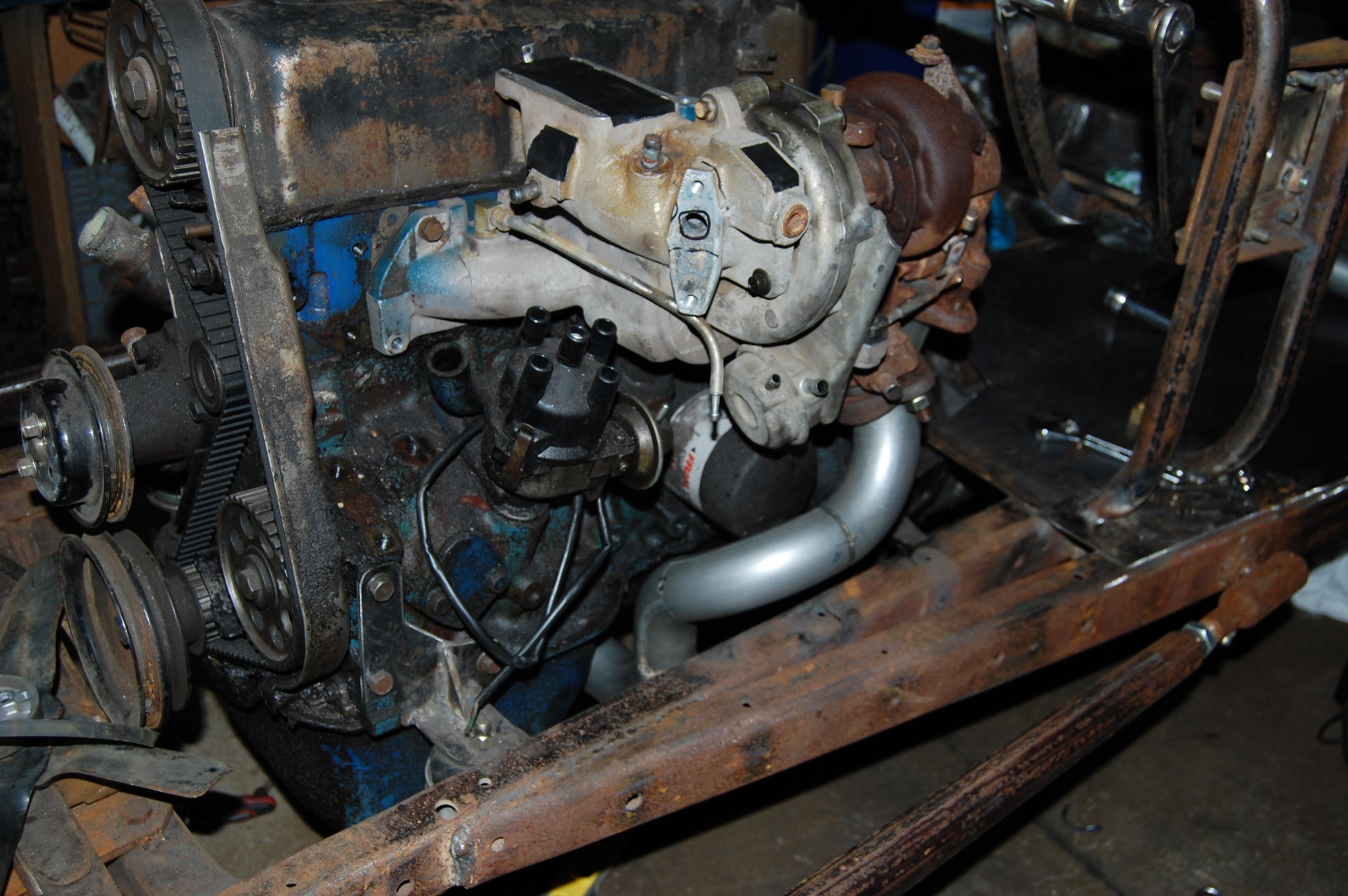

    Here's a couple shots of the set up in my 26 lakes modified. Motor in pic is mockup motor. Have freshened up 79 2.3 turbo block waiting in my office.
    Have adapter being made for the twin carbs. Leaning toward 97's instead of the 94's. Will go progressive. Just built header and crossover turbo tube. Will get finished welded and coated this week.
    Running a 4 speed with 35 rear end and a Dick Spadaro (Winters ) QC. Used 46 dropped front bones re-triangulated with model A ball.
    Alternator will go low on other side and not sure if I want coil or fuel log back in the cavity where the old bracket wuz. Kinda like the idea of the line coming out of the pump straight into first nipple of the fenton tri-power log. next 2 nipples run up to the carbs (Hard lines), and pressure gauge in old inlet on the top end. Oil filled gauges on the motor. 2 3/8 speedo in the original amp hole on the dash. T headlight switch and key. Nothing extra on the dash
    Major focus on absolutely nothing on the firewall. clean and simple.

    Were dI'd you get the turbo set up off of year make model I run the svo ford 2.3 motor in my car and I want turbo. but the svo is injected I'm carbed your is more like a blower set up carbs on top ...any info would be cool

    The turbo is from a 1980 Mustang 2.3 They are 79-81 Mustang, Fairmont, and some others. Hard to find, couldn't find an uncracked exhaust manifold so we built a header. It is called a draw through system, not as efficent as modern turbo and EFI. It could be built out of a turbo and tubing with some flanges. Hells Gate Hot Rods made our header flange. Hope this helps
