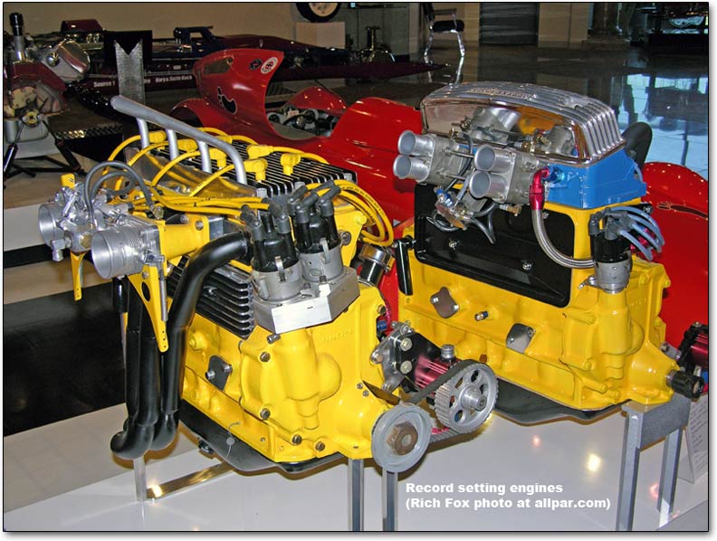

    Here are two PB's at the speedway museum that represent Rich's record setting engines. They have some of his parts bolted on. The one with the blue head is the Y-Block OHV conversion version. I am certain Rich has posted here about these engines before.
    The PB I bought was on the Hamb for sale a while back and I then found it on a different site still for sale and I made them an offer that they accepted. They had taken the trans off but then the guy who was going to buy it flaked so I for a few dollars more I kept it all together.

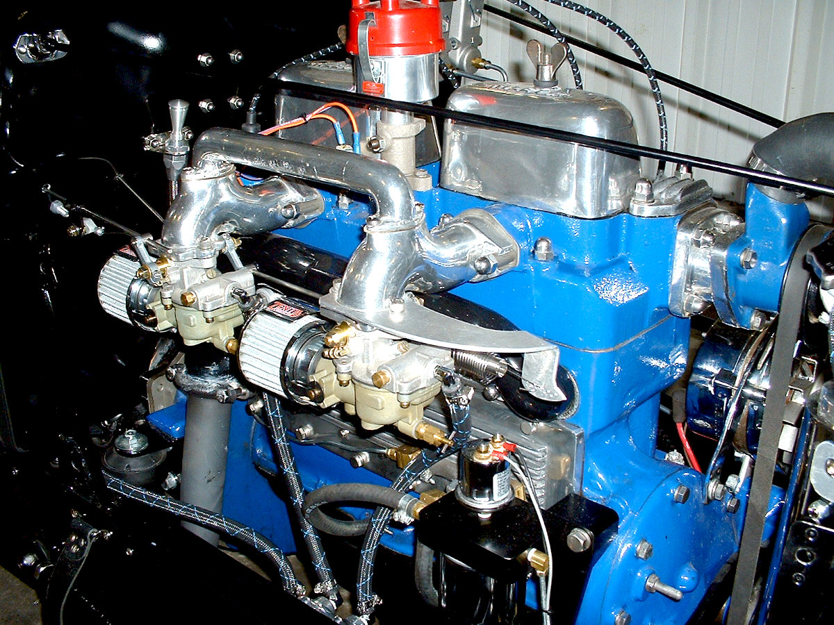

    Heres what i was putsing on today, its hamber j-stovebolt's B powered A chassis, he was having some tuning and set up issues and didnt know where to turn, we were in contact about something else and he mentioned his chassis, i told him i kinda know what im doing so id tackle it for him.
    Motor seems to be basically a stock B with a milled head, and has a Evans intake and 2x97s, it has the FS ignition electronic distributor in it with mechanical advance,and a header by lakeheaders.com, he dropped it off and said he had a heck of a time starting it and had a huge stumble.
    I always start with the basica, i went over the wiring set up, went over the plug wires, plug cap, and also make sure the intake is tight and no leaks, well i noticed some cheesy hold down spready tabs made of angle iron and new that they needed to be upgrade, so i made some out of some DOM tubing, i basicaly notch them the same thickness as the intake and they seem to work fine, after putting those on and retightening the intake down it started alot easier so i was figuring it had a vacuum leak. then it was onto the stumble, it idles great but misses and sputters and wont rev real easy, so i started closing the choke and the more closed i put it the better it would run, so i checked the jets, 33s! seemed alot too small, i looked on the hamb and talked to Chris and seems like the consensus is abouut 40s, well i didnt have any 40s, so for testing purposes only i basically split the difference and put a 46 on one side and left the 33 on the other, its an open plenum intake so it really doesnt effect that mucha dn i plan on ordering up some 39 40 and 41 jets to play with for the fine tuning. i went and turned the key and it started up great and revved up nice and smooth, so now i went about setting the timing, it was close cause it started up fine, i basically power time all my stuff, i so i held the rpms up to make sure the dist was at full advance and put the distributor in the spot where it ran best. now time for a test drive down the driveway. took it for a spin and it runs great and has really good power for a banger, i have my little temp gun and was checking all the temps as i drove it around and the temps all look really good.
    And now its back to Josh, hes going to order up the jets and ill go down and do the final jet changes and tuning in a few weeks or so.
