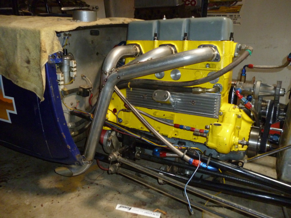

    A quick picture of the header for the Dodge Bros. Getting close.

    How are you attaching the two new main bearing supports/webs to the block?
