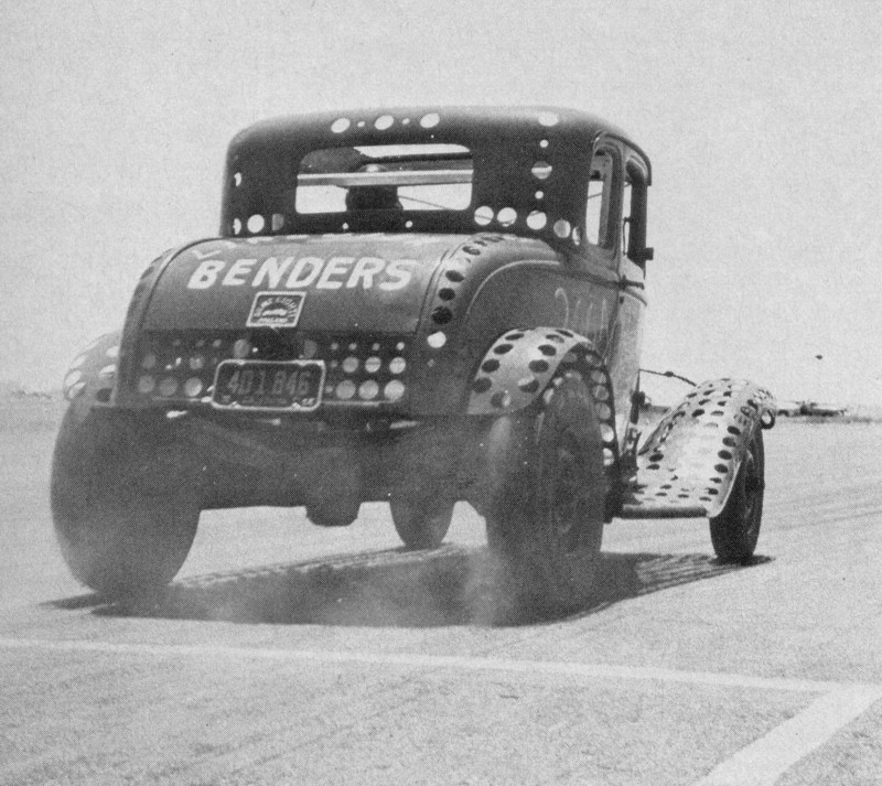

    Hmmmmm ......... :)
    :D

    I'm thinking that more bullet holes across the rear just might do the trick. Either that or a 3" hole saw.:D

    Holes is good! Anything to remove some if its...er...brickness.
    Without altering its great period look.
