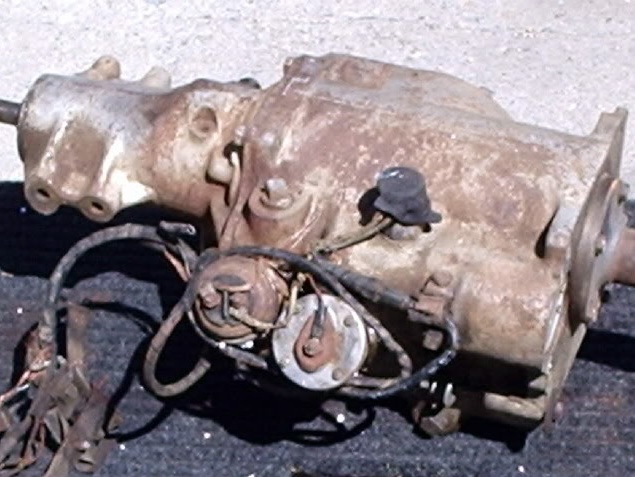

  8. squirrel
    Joined: Sep 23, 2004
    Posts: 56,085
    squirrel
    the M6 semi automatic was around long before 1951.
    it looks like this

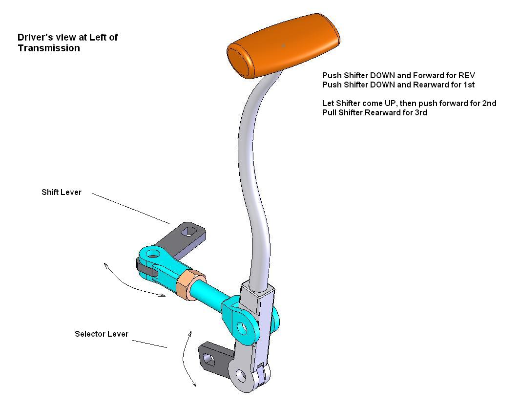

    A "standard" 3-sp shifter won't work on the Dodge xmsn, because the unit had a selector type mechanism. You can see this mechanism as a small box on the side.
    When you pulled the shift lever back, the mechanism selected First-Reverse.
    The shift lever going up got Reverse, lever down; First.
    When the lever was released and allowed to go forward, (anticipating 2nd gear) nothing happened until you clutched. Then the selector popped out of the First-Reverse position and into 2nd/3rd position. If you held the lever back, this wouldn't happen of course.
    Now the shift lever going up got 2nd; down got 3rd.
    My school car was a '50 Dodge Coronet with the Fluid Drive and 3sp.
    This is a vertical "H" pattern shifter I made back in '64 to make it a floor shift.
    We had a 49 (?) Plymouth with the same transmission but less the Fluid Drive on which to build the prototype.
    It work much better than I had hoped; the main reason being that as you came out of 1st gear, the linkages tended to help the transmission slide right into 2nd. Never missed a shift.
    (I'm drawing on memory from back then, but here's what I came up with)
