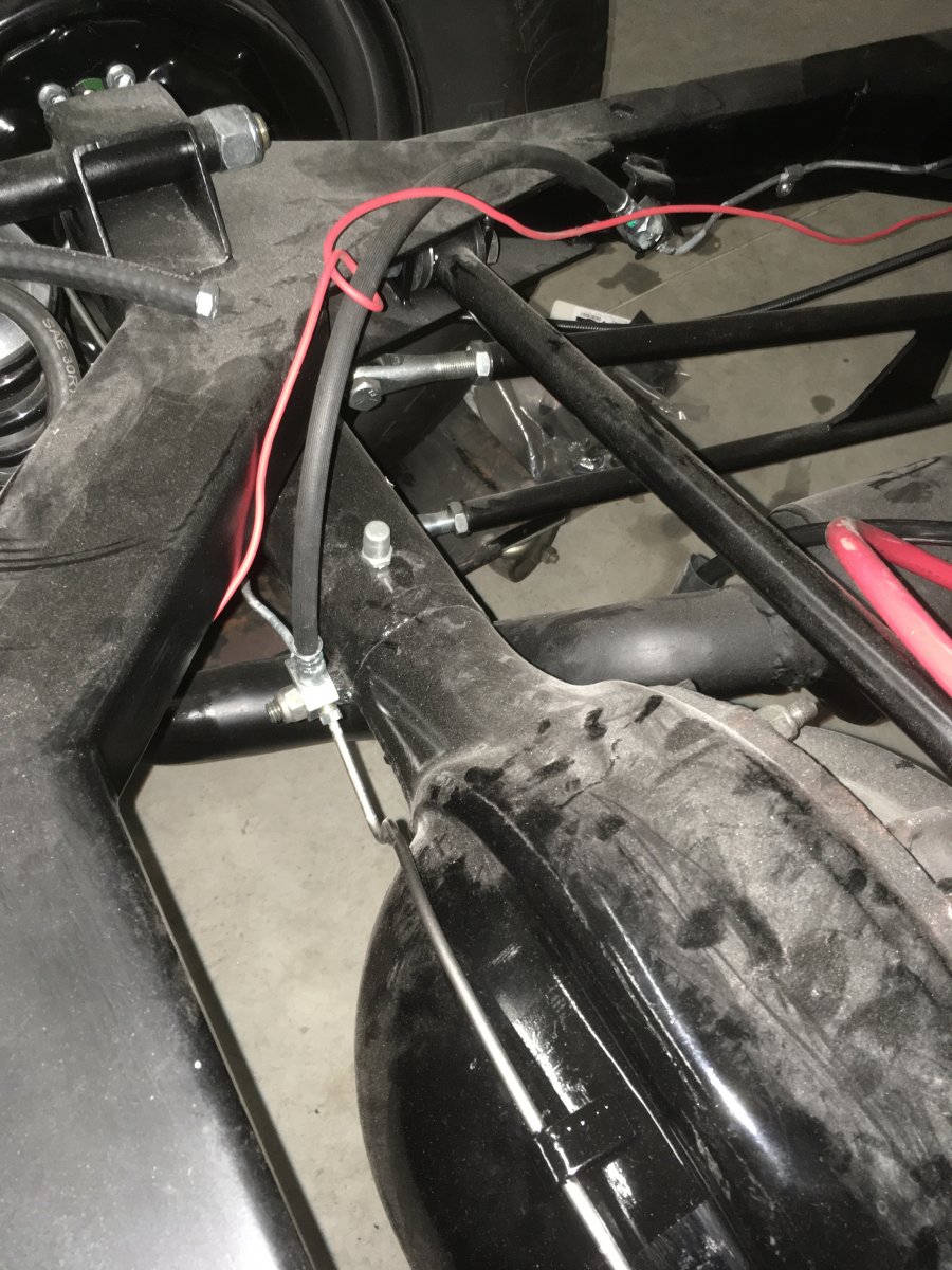

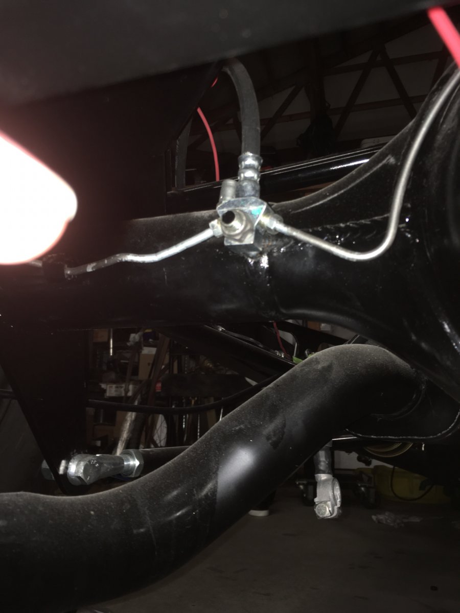

    Hello all
    I’m looking for ideal on how people ran their flex line down to the rear axle from the frame. I’m not happy with what I have created I feel there will be a lot of flex and pressure put on the -3an fitting going into the junction block on my frame and I’m worried it with break
    What has everyone else done for this joint
    Thanks for any info

    Usually the junction block bolts to the frame and is female inverted flair in and out inline. You have created a bunch of potential leak points with all of those pipe thread adapters. They also lengthened the connection. There is nothing wrong with using a 90 degree block if it fits, but all of the extra connections you have is kind of creating the reason you asked the question. I can't tell by the photos, but is that a DOT approved flex line? I would just keep it simple and stay with all inverted flare connections.

    Plan B is going to route it a little differently see the pictures I can get full travel of the suspension with out any binding. Just using a old (65 mustang)brake line I have ordered a new one as this one is damaged but gives me a better ideal for placement

    I like plan B better........less places to leak and looks less cluttered.

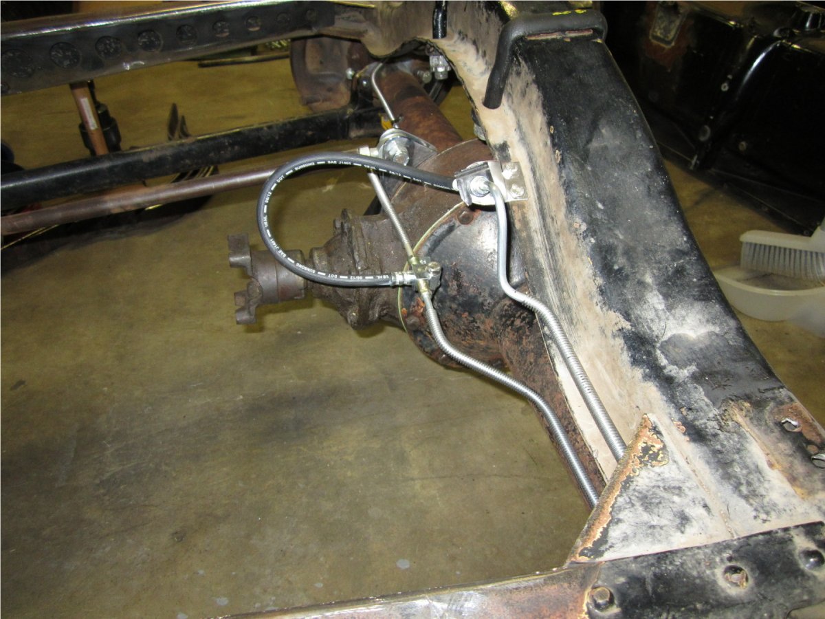

    How I did my flex line. These pics don’t show the bracket I fabbed to mount the hard line to the rearend but you can see how I did the flex line. Lots of miles on the coupe and zero issues.

    Cycle suspension up and down to ensure that line does not bind anywhere or come into contact with any other components. That hose radius is within safe limits. The chassis coupling is safer than a cantilevered union.

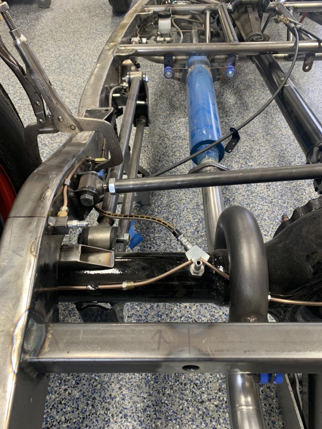

  14. Rob28
    Joined: Oct 25, 2014
    Posts: 103
    Rob28
    from Calgary AB
    Thanks for the advice for everyone it’s sometimes amazing the simplest solution is the hardest to come up with
    Used a 65 mustang brake line (easily available at my local Napa) that I flipped to angle the hose towards the frame
    Made up a bracket to hold the end and attached it to the original hard line I had already made up. Gives me at least 1/2” clearance to the coil over at any point in travel

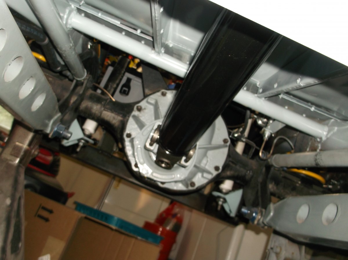

    Mine is a little different.
  16. brading

    Your 1st picture on post # 14 looks good. Do that, but move the tab down about an inch on the frame rail so the flex line wont hit the floorpan of the body when the suspension is compressed (possibly making a rub location on the flex line). Your picture has it about 1/4" from the top of the frame rail, put it about 1/4" from the bottom of the frame rail.
    BTW, Are you getting tired of taking those shocks on and off? I see three different configurations of it just in the pictures on post #14 alone (1 fully assembled, 2 shock with spring cups, 3 shock w/o spring cups). :p
