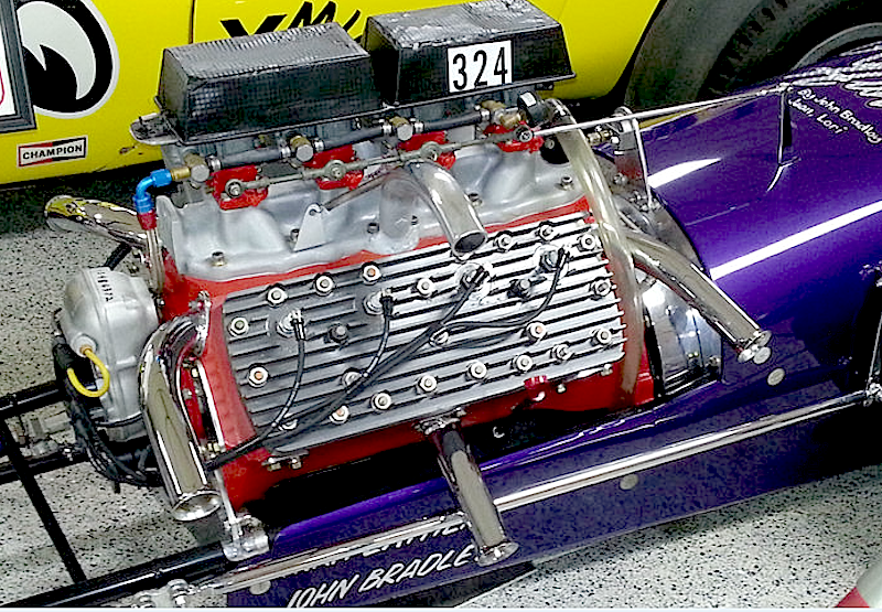

    This is a pic of the mod you want to do. This one was probably the most successful one ever done.
    It was John Bradleys engine for the 1963 Bakersfield race. The top middle pipe was a definite improvement.
    You can NOT use port dividers if you use this mod. The store bought dividers are useless anyway. John Braadley car 2018-03-08 at 2.08.25 PM.png

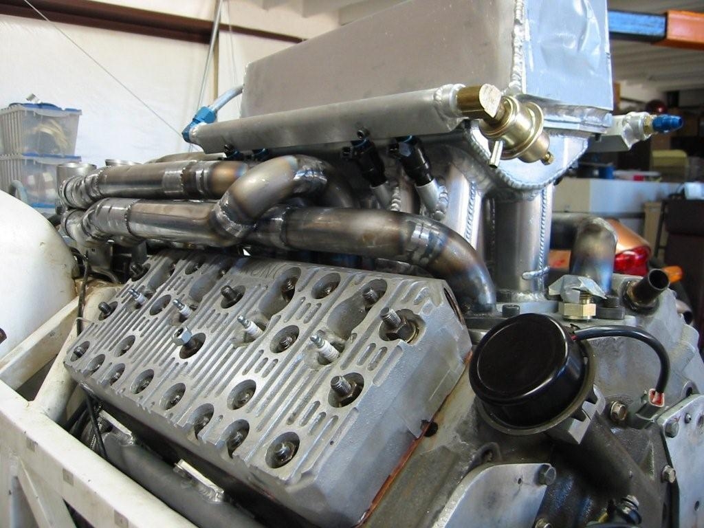

    Ford with exhaust ports rerouted to top.

  19. Rick Schnell's Slider Dragster.
    Unless you are doing an all out - full race build like this, there is not much reason for that 4th port. This motor develops close to 1000 hp on a high percentage of nitro, runs deep into the 7's, and sounds otherworldly.

    I've seen this mod a few times and was going to look for the same picture.
    I'd love to know what they do about the water jacket. Does the exhaust pipe go into the valve bowl through the water jacket?
    It seems like this dragster motor is a dry block set up.

    No, I mean the end exhaust. There are water jackets in those corners I believe. The motor I'm talking about isn't in Slider. It's in the purple FED.
  24. RichFox
    Joined: Dec 3, 2006
    Posts: 9,761
    RichFox
    That engine has the water jackets full of aluminum. So it in effect has no water jackets and they cn just bore straight through into the exhaust port
