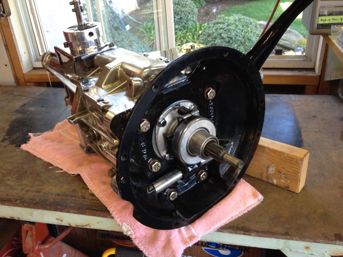

    Looking for suggestions for my motor/tranny set up. Have an 8ba with the 2 piece bellhousing (hogs head), a Dwight Bond adapter and a T5. I'm using a stock flathead 3 finger clutch and currently have the stock TO bearing installed. I'm using the Dwight Bond Model A pedal shaft, utilizing stock A pedals and clutch hardware. As far as the pedals go, it all just fell together with stock parts. Very nice. The issue I have is, I'm about 3/4" from the face of the bearing to the face of the fingers. By the time I apply all the travel I have in the clutch pedal, I'm hardly pressing on the fingers. Even with the clevis adjustment taken all the way up, it just makes contact with the fingers. I'm still short on travel.
    What I'm looking for is a deeper (longer ?) TO brg. to take up the 3/4" distance to the fingers. I could make a sleeve/spacer to go behind the bearing to keep it from travelling back so much but, the clutch arm is drilled and pinned. If I put in a spacer, it will move my arm forward and I'll just end up with the same problem I have when I adjust the clevis all the way up.
    Does anyone have this adapter set up with a non-stock TO brg and if so, do you remember which bearing you used?
    We thought we had all the geometry worked out. We had the whole car together and sitting in the street running when the clutch wouldn't disengage. The horror. That'll teach me to put everything together without a test drive. Thanks in advance (I hope!)

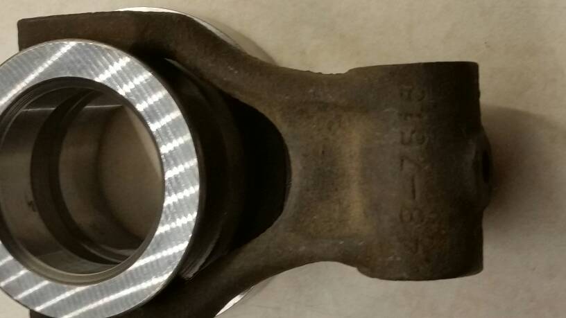

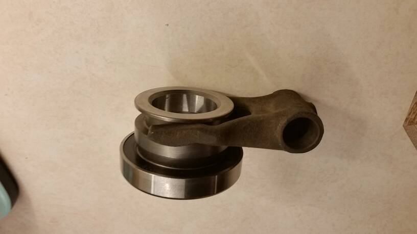

    I have one here that I pressed a bronze liner in to mate with GM T5, but ended up not using it. I can press the bushing out if you want to try it. I ended up using a diaphragm PP and could not use this big if bearing.

    Here's the throw out/fork and the pedals.

    Outside diameter is 3 7/16 3.437, ID is 1.750, overall height is 1.992 and 1.355

    I thought it fit pretty well, is your fork Ford or aftermarket? 20190306_201329.jpeg 20190306_201311.jpeg 20190306_201301.jpeg 20190306_201359.jpeg

    Big Duece-Your fork is different than mine. I think I have another one somewhere. Mine is thicker (if I do say so myself) and so the groove in the bearing carrier won’t slide all the way down. Thanks for that pic. It helps.

    Dig through my spares and found the other fork. The bearing slipped right on. Woo hoo!
