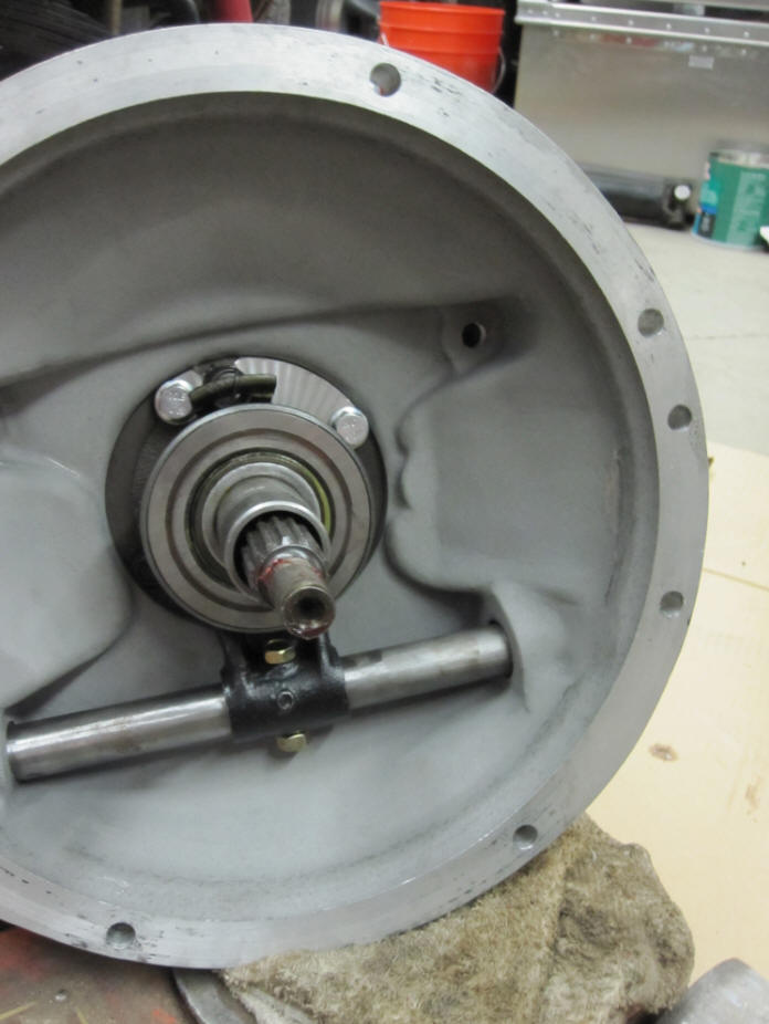

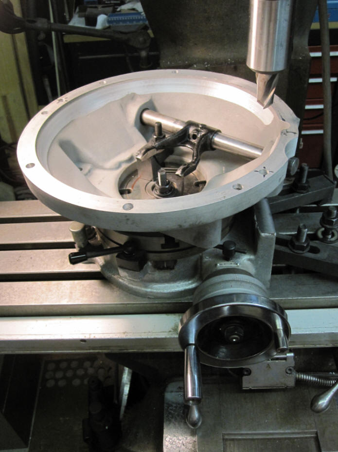

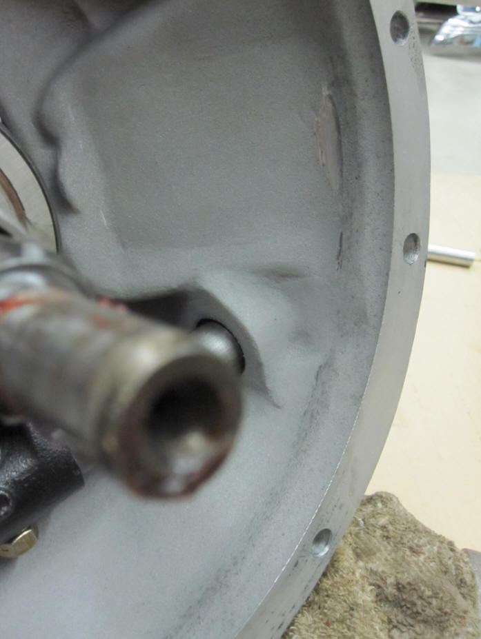

    Turns out Speedway is not the only adapter that has an interference problem with the counterweights on certain pressure plates, I had your exact problem with the Cornhusker set up I bought. After pulling the transmission the problem was obvious. A trip to the milling machine and problem solved. Maybe I got a little carried away but I did not want any reoccurring problems as the clutch disc wears . . .

    Alliance Vendor
    from Nebraska
    I'm gonna chime in here. The adaptors haven't changed, it's the pps. I sold hundreds of 10 inch pp's over the years and never had a problem. The problem started about 4 years ago when my US supplier stopped making the 10" Long style PP because he got so expensive no one would buy theirs. I assume my supplier along with Speedway started buying the foreign made pp's. I have a paragraph in my instructions warning of this problem. It doesn't occur with every pp just a few. There's pps out there that will work but most guys don't want to spend the money. I would have to get 200 + to make them worth carrying. For my business it may be a better option to just quit selling PPs. Fort Wayne Clutch is a good option and that may be where I start sending my customers? Lastly the problem I have encountered with the diaphragm pp is the center hole being to small to work with the early Ford Brg and hub. There may be a diaphragm pp that I'm unaware of? Gary at Cornhusker

  24. NMCarNut
    Joined: Nov 28, 2009
    Posts: 630
    NMCarNut
    @krylon32:
    There was at least one problem, mine.
    You said: Should have followed the instructions and checked PP clearance.
    I said: Saw the warning but since I paid extra money to buy the PP from you figured it would be OK.
    Score: Draw.
    Bottom line: After an unplanned teardown and machining everything has since been fine.

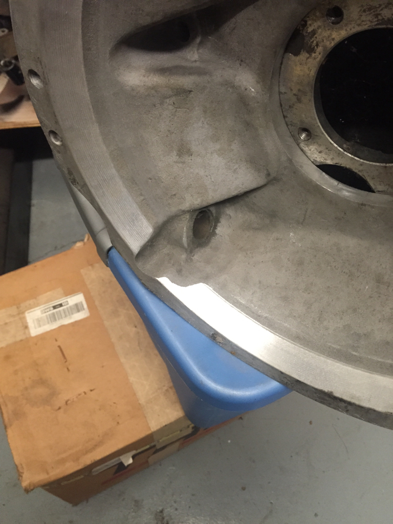

    Kevin it is the weights hitting inside the adaptor. I machine every adapter I use. Offy adapters have the same problem.

    Posts: 2,706
    hot rod pro
    from spring tx.
    Kevin. Here is what I do. ImageUploadedByH.A.M.B.1430858800.824280.jpg ImageUploadedByH.A.M.B.1430858811.562092.jpg ImageUploadedByH.A.M.B.1430858822.083376.jpg
