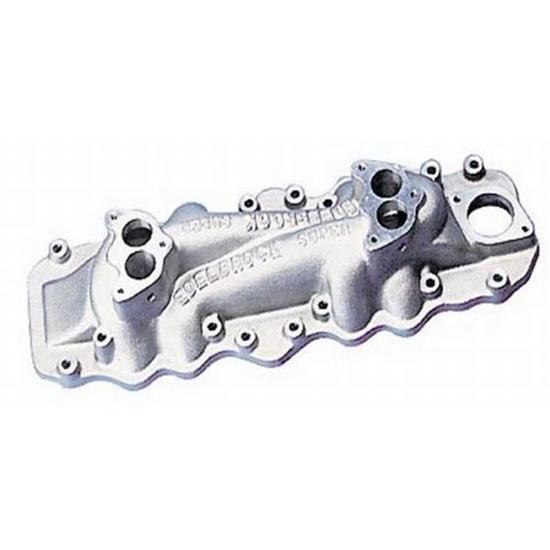

    Has anyone ever noticed that there are 2 different types of edelbrock super dual intakes??
    I seen a few online and at swapmeets that have the exhaust heat cross over and some that dont have the cross over (the new ones dont have the heat cross over).
    Does anyone know the reason for this? I bet one was for "track" and the other was for "street"

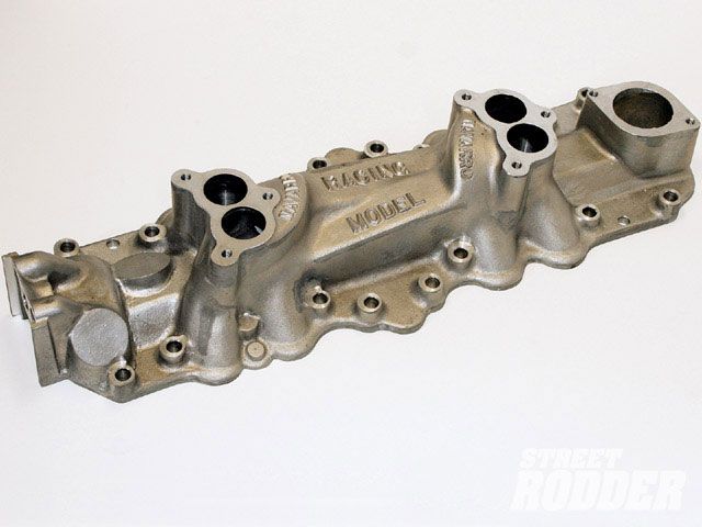

    I don't think there will be a difference between the three intakes in power output with a 239ci engine and a 3/4 cam.
    The offy has a heat riser which is good for street.
    I don`t like the Navarro casting as they use the same casting for early and late intakes
    the bosses for the oil filler/draft tube look like zits.
    I have an OLD Navarro 2x2 (universal model) and i like it alot.
    Edelbrock have no heat riser either.

    the navarro universal has the heat riser
