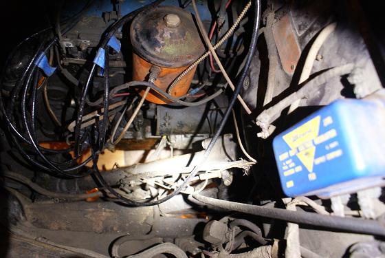

    Camera problems right now, but here is an earlier shot of the engine bay with the flathead still installed. Lower left shows the steering box. More later when I get a chance.
