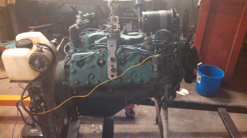

    Okey..have fresh flathead build...motor turns nice...bolt to motor stand....turns nice...i put the starter plate on....tight fit! Motor wont turn!!! Plate rubs flywheel....do they make seperate plates for possibly shift o matic an manual? I cant see what ive done wrong? Flywheel needs to be turned but not warped.....pluse that shudent matter i would assume....an starter plate has a recess lump all the way around it...(definitely factory) if i shave inside or flatten out recess sure it may work but not correct...

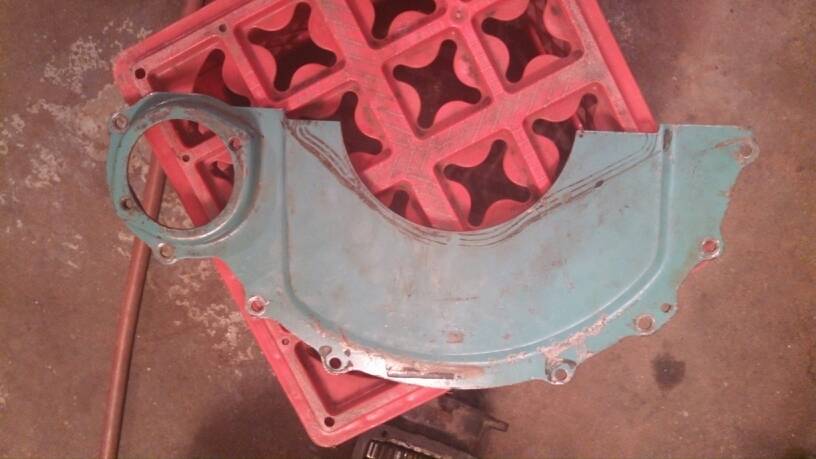

    No adapter plates...all stock parts...im not sure if merc or ford...in new to flathead motors...i got all the parts that were all together...from what i was told.....on a running motor...if i take starter plate off... motor is fine....i notice on inside of plate there is a 1/16 inch groove around it from hitting the flywheel....like if i didnt set flywheel in all way...but it is...nice even space around flywheel all away around block...im really wondering about that plate bein wrong...idk...all old paint on all parts match correctly...i know that means nothing...but assures me they were all together...an it was a old timer friend i got them from...

    I had a problem with start plate ,but mine was with a flatomatic c4 trans touque convertor bolt hitting plate. What I did was hack up the start plate till the bolts no longer hit. I just bought a Merc half bellhousing and this starter plate has drag mark on it.

    As I see the scrap mark may need shim at end of crankshaft ,to move away from starter plate.

    I just straightened starter plate..... an ground starter plate....motor turns freely... i dont know why i had to do that though...gut.f###@k it.....works....i have to take short break...then post video of hope first run....

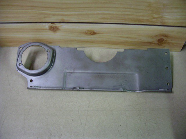

    May be the wrong plate, it doesn't look like the one we use here for dynoing the 8BA builds??
    Thanks, Gary in N.Y.
    P.S. Here's a shot of our plate, I believe it is originally from a 1950 Merc!!

    Gary, that's a '51-'53 Mercury/'52-'53 Ford car starter plate.

    You should not have to grind stock parts to make them fit. :( That H.D. truck starter plate, indented for an alloy rear seal, pairs with your cast iron bell housing just fine.
    The picture of the rear of the engine shows the bell is not fully seated to the block, and there are no bolts securing the bell. :confused: This may have been your problem.
    Try slowing down a bit, before more damage is done, since you are not familiar with these engines.

    Lol...the pic i sent is when i was just about to put motor back on stand...bell was all way on...and fastened....as far as slowin down....i quaddrupple check all things an always work slow...unless im in middle of raod...sn knock on wood...hasnt happened in longggg time..
    Thanks very much for noticing that though...if that was the prob you were only one to pickup on that though.
