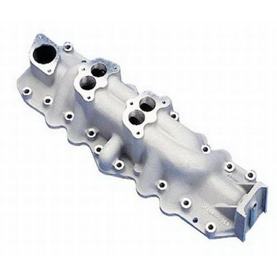

    To the O/P. If you're interested, here is the type of dual intake manifold you need if you want to run progressive linkage. You can see that the front carb is mounted just about where the carburetor goes on a single carb manifold. You run the front carb as the primary, and you still have decent fuel distribution, front to back. When you kick in the secondary carb, it feeds the back 4 cylinders and the majority of the flow from the front carb goes to the front four cylinders. It has to go a bit further, so fuel distribution is not ideal, but it should be satisfactory. I think you can see why this manifold would work better when running on one carburetor (which you will be doing almost all of the time) than the one you have.
    This particular picture is of a manifold for the earlier engines (pre-48), but they make them for the later engines as well. Also with this kind, the stock generator can be used in the stock location.
